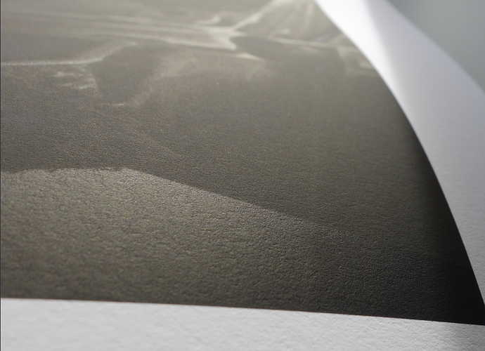

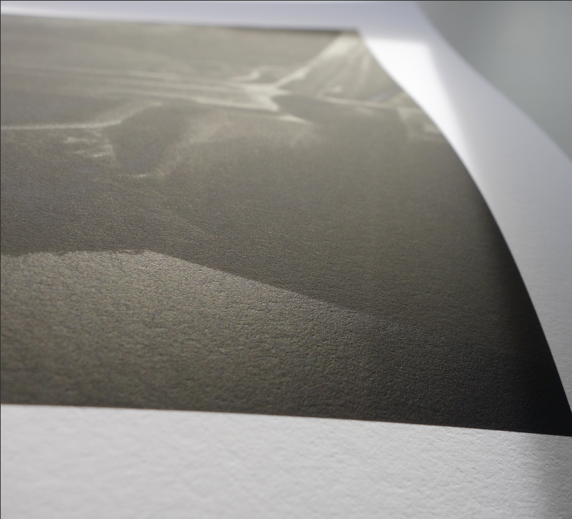

I wasn’t happy of some very dark prints on Hahnemühle Photo Rag 188gsm (and moab entrada) with the MatteMaster.quads / PROK4. I just discovered this (see attachment), where there is 100% black . The print is dry since 24h. Is it normal or a very bad news?
Anthony
This looks like over-inking to me. What is your humidity? It should not be over 55%
I think you may need to also limit on these thin papers and then do a linearization.

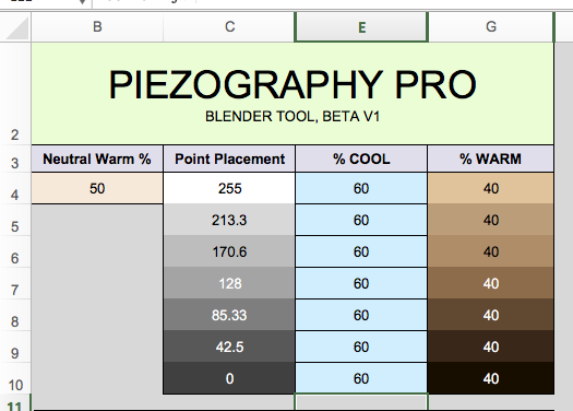

I think the other way of limiting will be needed (using your blender tool).
Using your original curve, load it into the cool side of the blender tool.
Then fill the warm side with zeros (all the way down, all zeros).
Then go to the blender sheet and set the “Neutral %” to 50.
This has now turned the blender tool into a “limiting” tool. If cool is set to 100 then everything will be normal (100% ink printing) but if you set the cool number less than 100 this will print with correspondingly less ink. I suggest setting all the cool numbers at 75% (75% of ink) and running a print test.

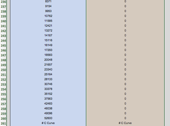

Just to be sure. Fill only the K-values with zero or the other inks as well excluding the C, M etc…?
Best, Markus
Fill ALL the warm rows with 0 (including the “# Curve” rows, everything).

Thanks - hope that’s correct…?
I can get rid of the overinking with a value of 60% - and end up with a Dmax of 1.72 - which seems pretty good to me.
What do you think?
