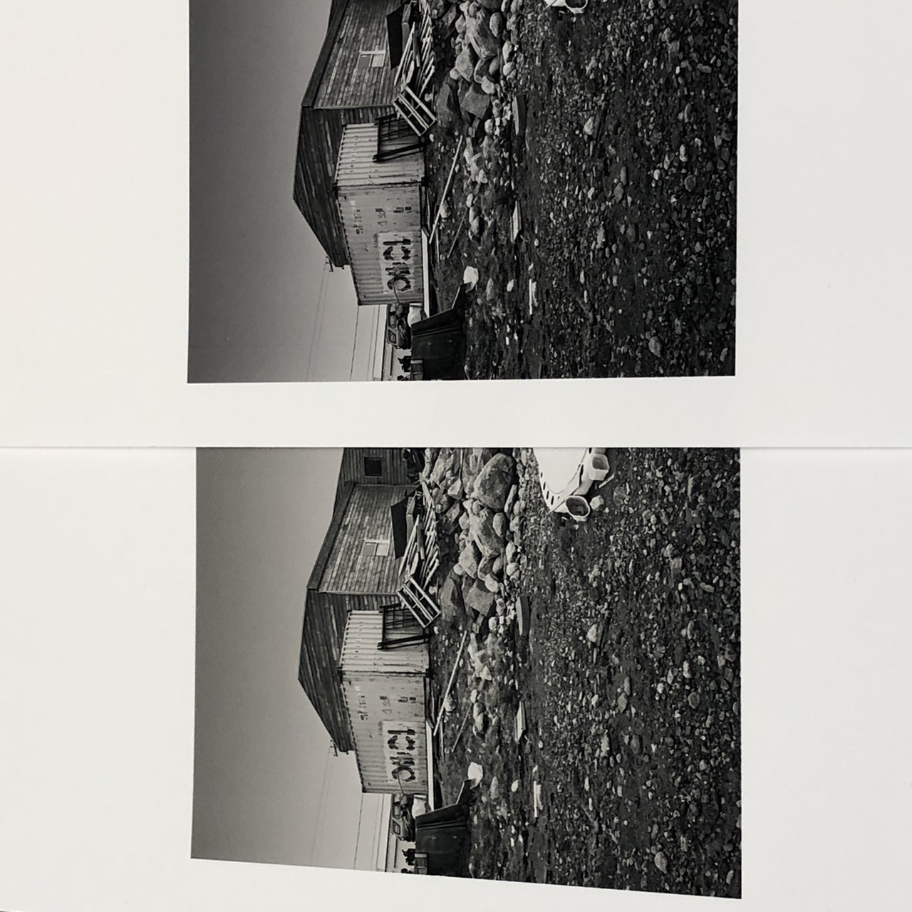

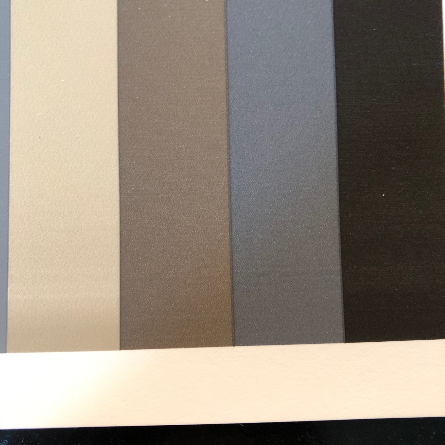

P400 prints don’t match 9900 prints
I finished converting a 9900 to Pro K5 but my prints are much lighter than the ones printed on my p400. I ran 2 initfills and several power cleans. What could the causing this ? 9900 print on the bottom :
looks like the right ones were printed with ICC and the left ones were printed linear . . . .
workflow change? it could be useful to print and send lin targets my way. I can make you a set of a 3 (cool, neutral, warm) to true things up
Workflow is the same and I’m using the same PC. I tried the K4 curves and it’s about the same. Same thing printing PK on PhotoRag Pearl. I noticed the density is also lighter on the 9900 printing the purge files - but I haven’t measured them yet with my colormunki. The nozzle pattern on the 9900 is thinner/finer compared to the p400. Shouldn’t they be the same thickness ?

I took some measurements of the MK (UHD Matte Black) with a Colormunki.
p400 => 15.2 (from the 8 color purge file)
9900 => 19.1 (from the 10 color purge file)
It also looks like there’s a slight amount of banding throughout and more pronounced banding near the end of the purge file. I ran a head alignment but it did not help. I don’t think the firmware on the 9900 was ever upgraded - should I ?

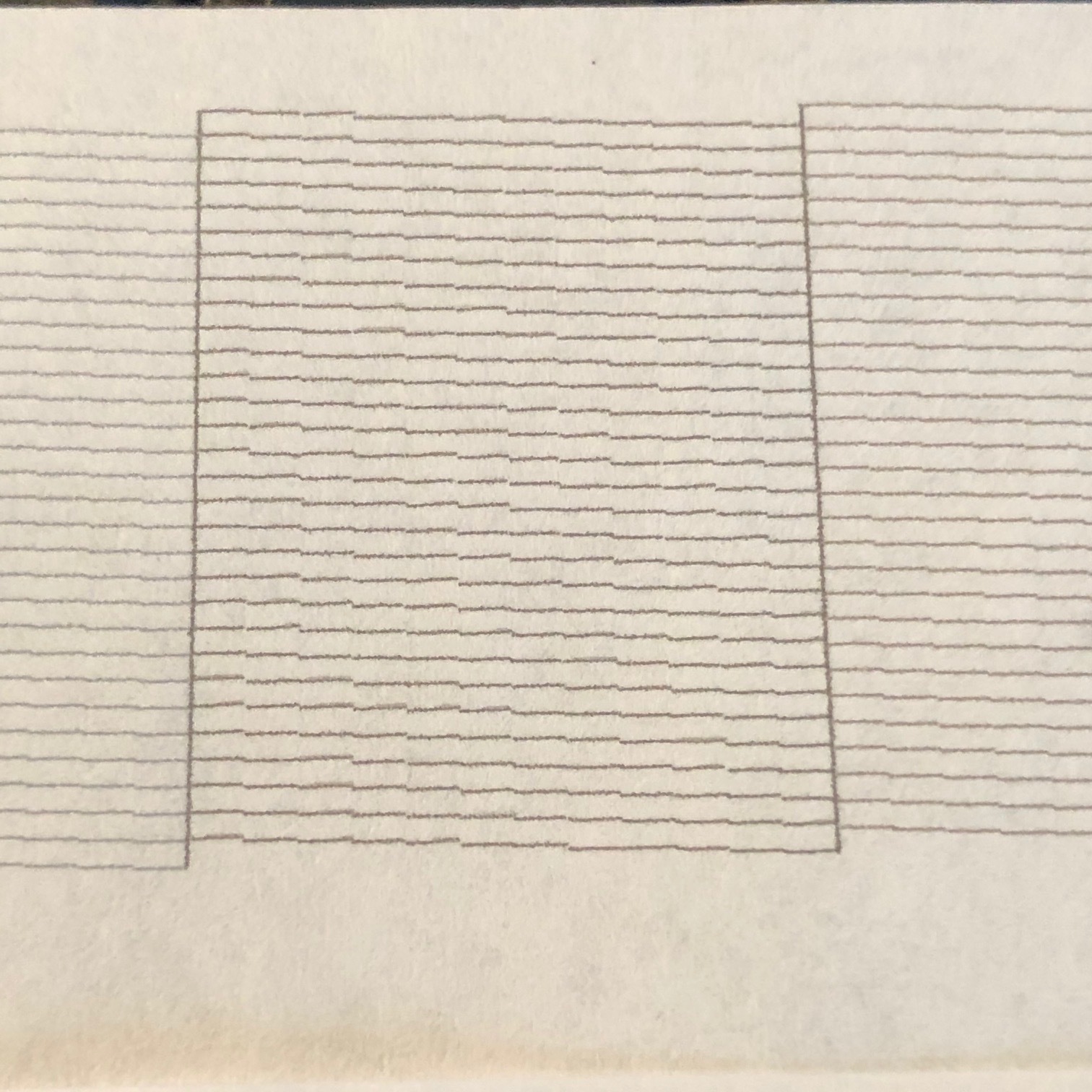

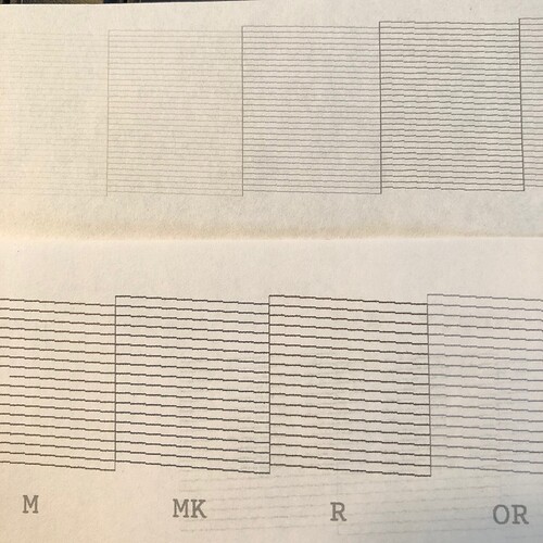

Here is a comparison of the of the nozzle checks : is is there a reason the one from the 9900 are so much finer ?

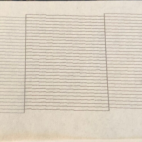

And a close-up of MK channel on 9900

I think it may be something else. I measured the other corresponding channels and they are all lighter :
Channel = 9900 - p400
LK = 67.2 - 63.2
LM = 43.7 - 38.2
LC = 45.6 - 43.4
Y = 67.2 - 62.2
M = 36.6 - 32.3
C = 35 - 33
K = 19.1 - 15.2
I’m using Printing Model Quad9900-Pro-K5 and x900-Hahn-PhotoRag-Neutral curve, Matte Paper (Type) and Matte Ink (Black Ink), Advanced adjustments are 0, Ordered.

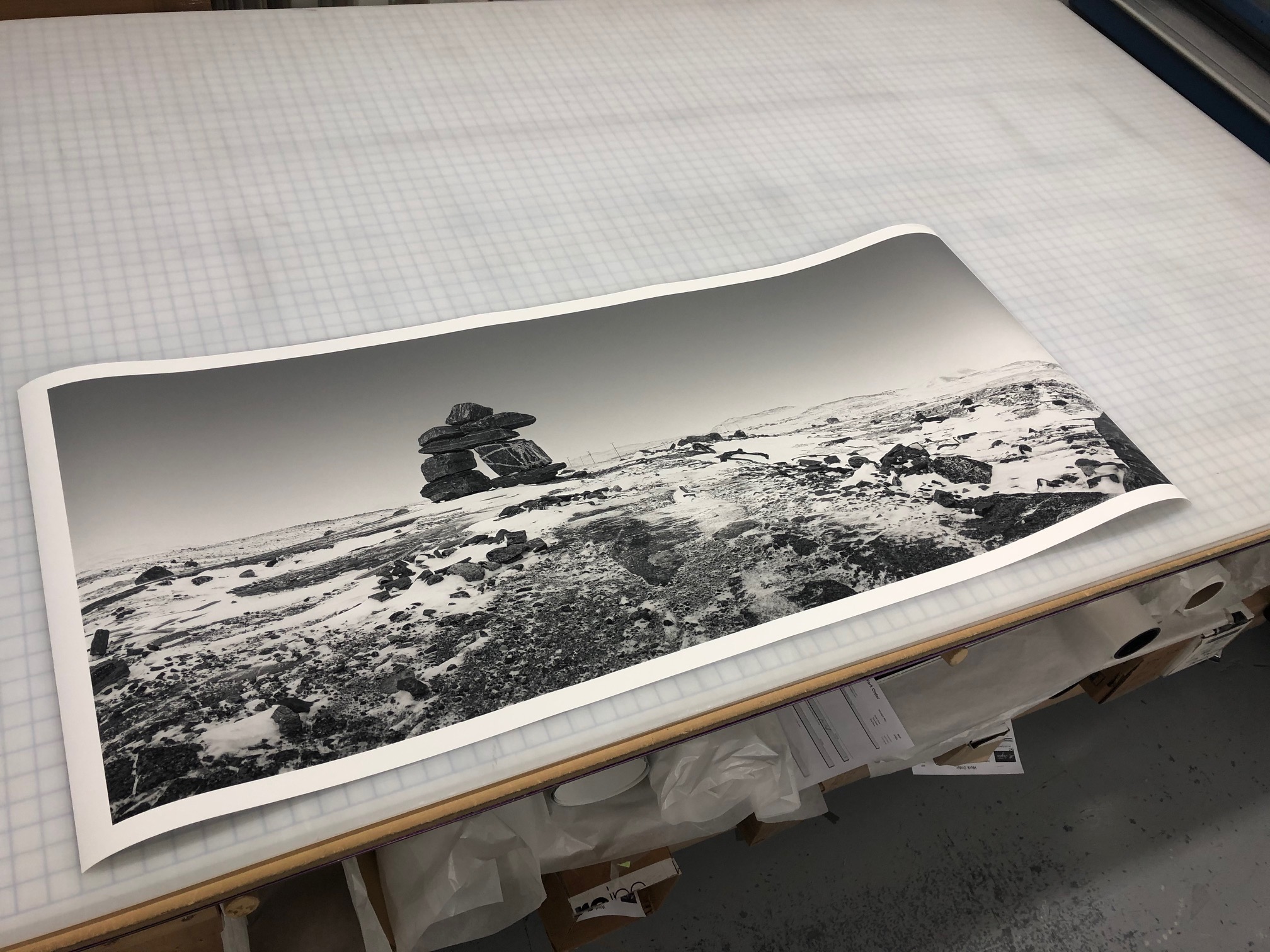

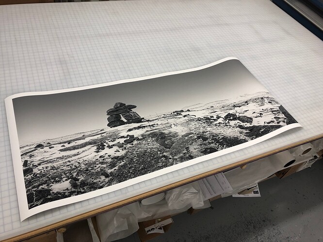

I tried the compensating curves over the weekend and wow, they are bang on. I’m THRILLED with the results and very relieved I can print my images on time for my show !!
Thanks Walker !!
you are very welcome. I invented this luminance match technique when printing for people at Black Point Editions in Chicago. I would ask them to print a target on their home printer and then I could match the luminance in my lab so when they sent files for large prints I could bang them out without messing anything up
