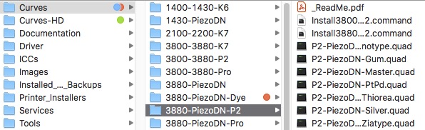

  2. Use a P2/K6 ink setup. MK stays in MK slot; PK is replaced by PiezoFlush; and PK goes in the Y slot instead of Shade 7. This makes both blacks available without ever having to switch. The black ink selector stays permanently on Matte, and in QTR you choose installed and save it as part of your presets to avoid accidentally invoking a switch. You lose absolutely nothing since PiezoDN doesn’t use Shade 7. If you choose this option be sure to install the correct P2 printer(s) and delete the K7 printers. For PiezoDN:Screen Shot 2020-03-05 at 9.09.12 PM
    For Piezo on paper it will depend on whether you are using standard black inks or HD blacks. If the former, use Curves > 3800-3880-P2; if the latter, use Curves HD > 3800-3880-P2.

In theory, since K7 PiezoDN curves don’t use shade 7 even though it is installed, there should be no difference between a K7 and a K6 PiezoDN curve, BUT the quads are not the same since P2 has the PK ink in the Y position rather than the K position.
You could remap your existing linearized K7 quad to a K6-P2 configuration. If you have the PPEv2 toolset this is fairly easy. Or you could just start over with a quad from the folder in my earlier post. Since you have been away from this for a while it might be better to recalibrate from scratch, but the choice is yours. You should at least verify (and relinearize if necessary) if you choose the remapping option.
