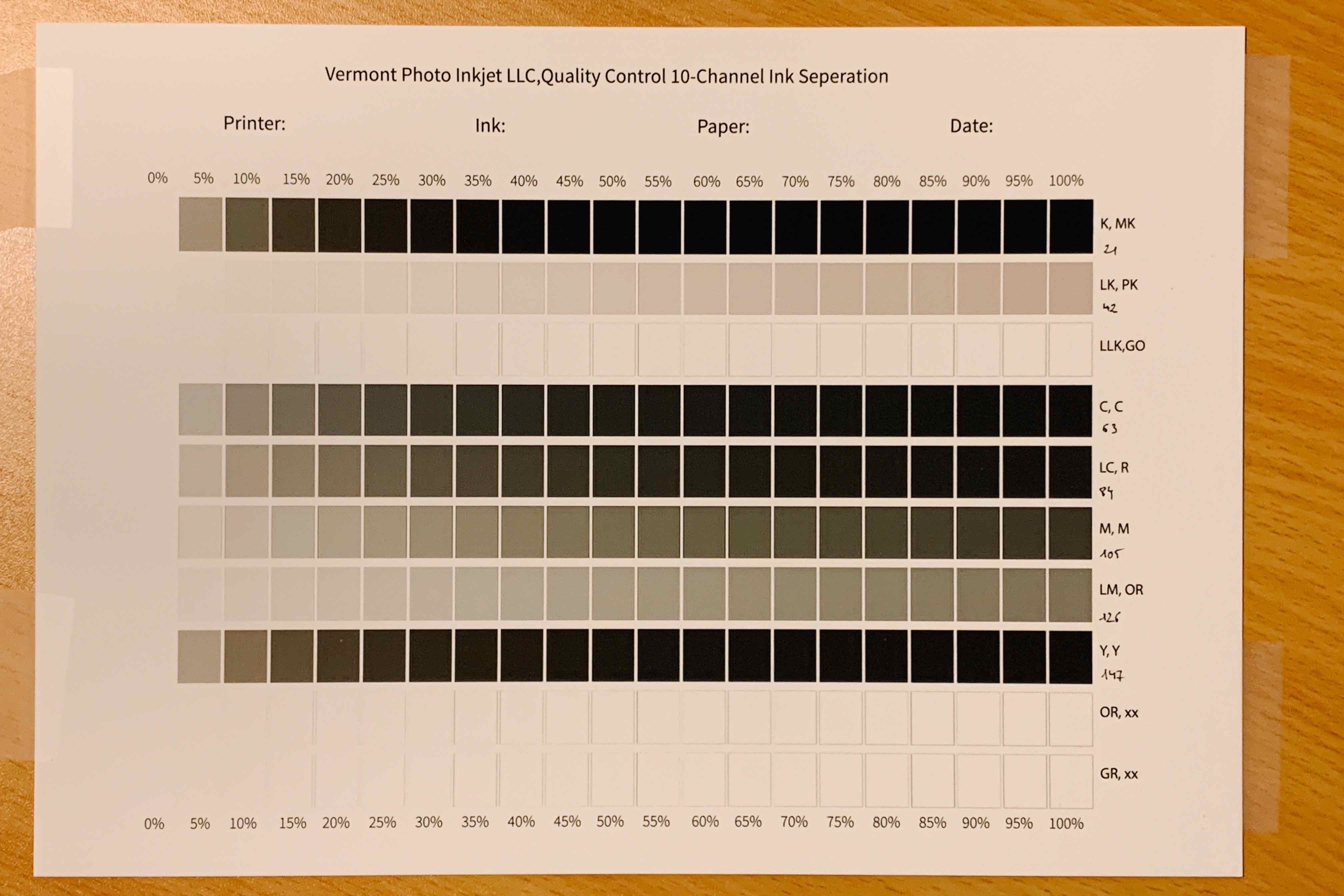

Target (129 patches) printed on Hahnemühle Photo Rag 308 with P2 NU set and SC P 600.
Measuring with X-Rite ColorMunki Photo and ColorPicker.

16.3 is pretty high dMax IMO, T2 is closer to 15.6 on the P800 . . . so maybe you don’t have all the epson ink out yet? I suggest printing a calibration target (in QTR calibration mode, not 16bit) and measuring the actual 100% UHD ink density:
VPI-10InkSep.tif.zip (674.1 KB)
UHD actually goes to 12.43 L* on the 3800 and HPR308.
Walker, OK I’ll print and measuring (L*,a,b,) the calibration target.

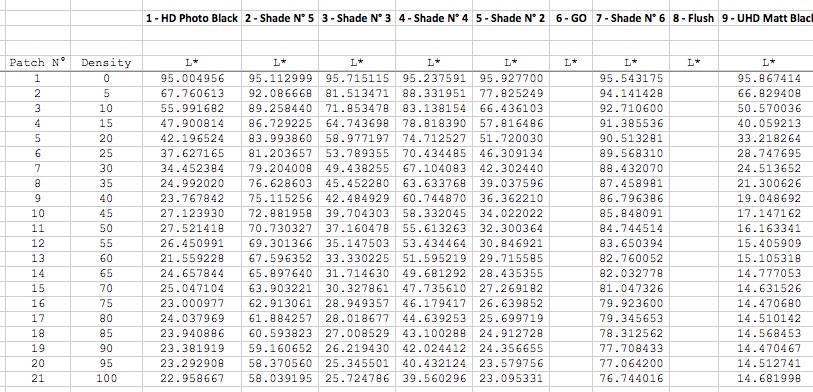

Dear Walker,
Results …
SC P-600
P2 NU
ColorMunki - spot measurements - ColorPicker
Target: VPI-10InkSep

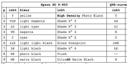

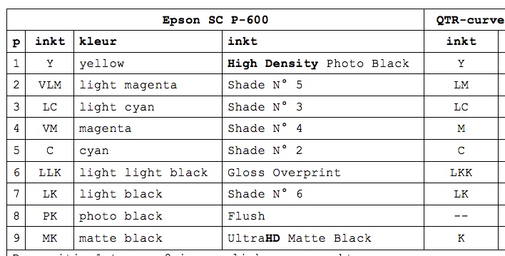

Cartridge position as following in SC-P-600
check of channels
printed target
channels / shades (number 1 - 9 is position from left to right in SC P-600)

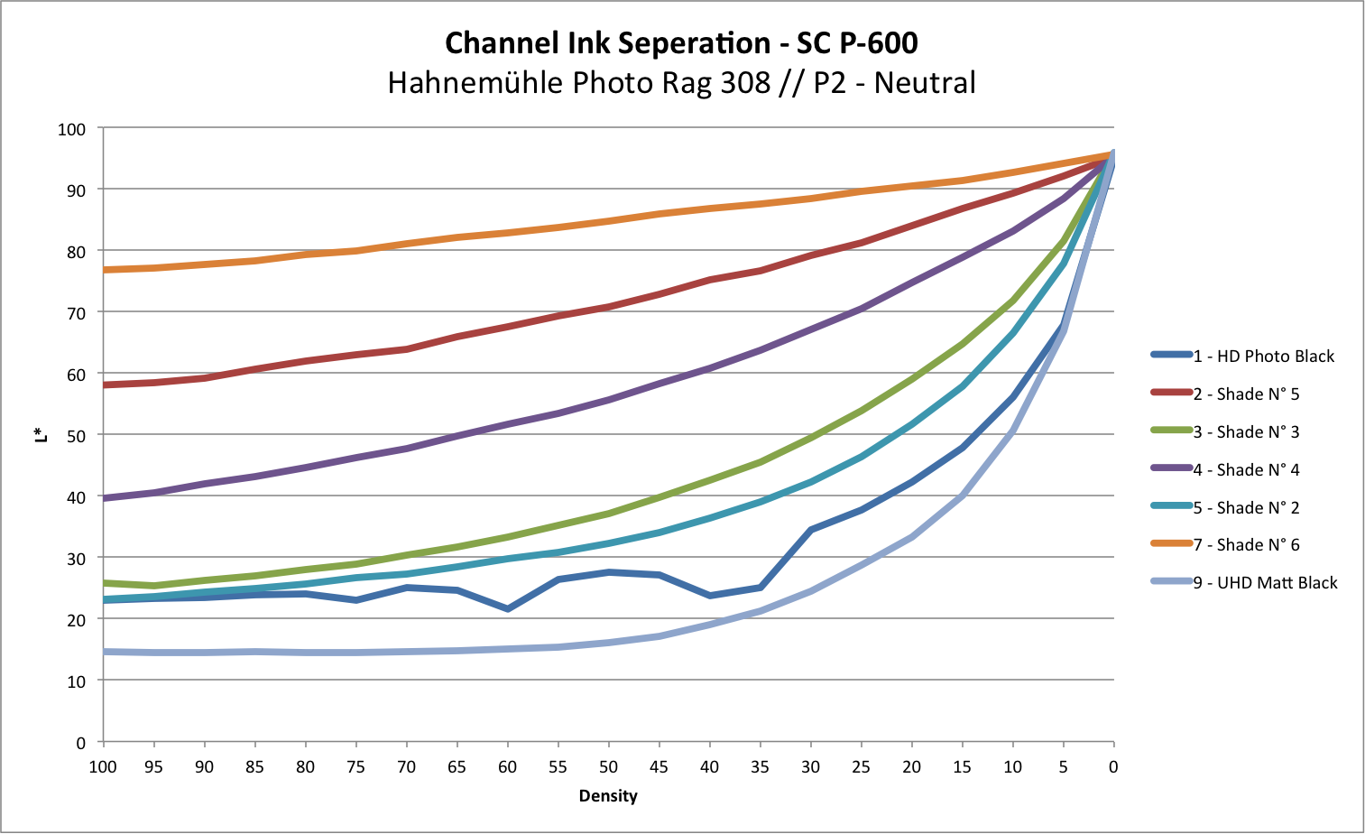

results of L* measurements

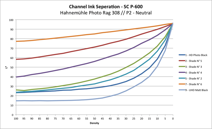

chart of the L* measurements per channel / shade

aside from the PK having some variability due to sensor placement, looks about right. UHD is a little light but it’s a 2 picoliter printer so that stands to reason it would be lighter than the 3.5 pL of the P800s . . . but did you dry over night?
Please mail me the target, I’d like to measure on our devices here too. It could be the device.

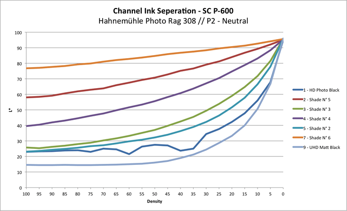

I’ve remeasured the same print of the Target, with the following ‘better’ results for the UHD Matt Black and same results for the other Shades.
Thanks for the advice concerning the ‘sensor’ placement. It helped to get ‘better’ measurements.
I’ll mail the printed Target.
