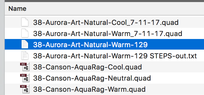

When I dropped the two files onto the QTR-Linearize-Quad droplet, I didn’t get a -LIN.QUAD file. I did get a -out.txt.

I also noticed that my newly created .Quad’s don’t have Icons in front of them like the pre-existing ones.
Darrell

Ok. I see the problem. You actually need to go to the File>Download As menu inside of the google spreadsheet. Do not use the File Download As menu on the computer.
I wasn’t able to linearize the Neutral Curve, so I started over. I was successful in getting a cool, Neutral and Warm Curve.
A possible issue might have been that I copied my starting curve and renamed it. I didn’t do this the next time.
