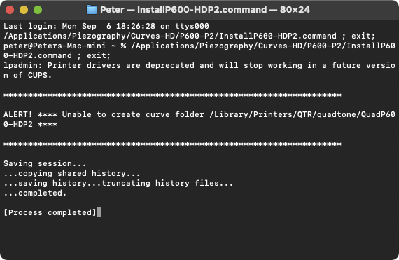

Finally (to resolve problems with SpyderPRINT Software version 5.6) I’ve upgraded from Big Sur 11.4 to 11.5.2.
If I try to install the printer with “InstallP600-HDP2.command” the following screen appears …

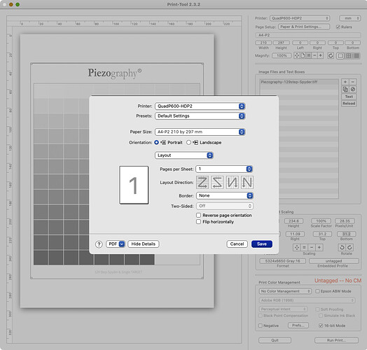

Finally the printer is ‘installed’ without any .quad availble in Print Tool, refer the following screen:
Any suggestions?

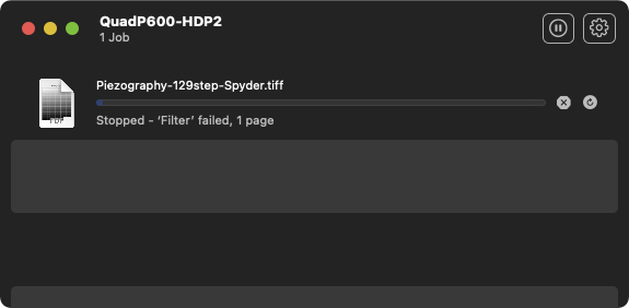

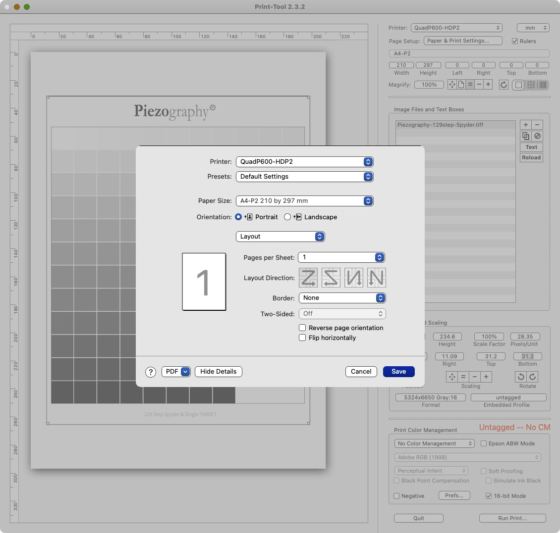

Any idea how I can solve/avoid the following ‘error’.

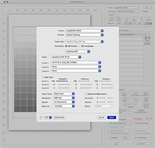

Please share screenshot of the quadtonerip curve selection step.
(for info - the target was well printed, it’s after the print that the above ‘error’ message appears, in fact after each print that I do the ‘filter failed error’ appears in the above screen)

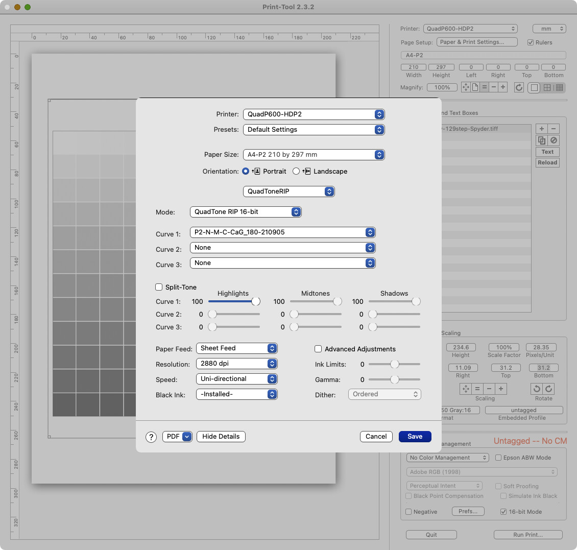

The information herafther is wat you need?
In above window at Curve 1 I make the selection of the required Curve (.quad).
‘Save’
and Run Print in the main Print Tool window.

Ahh, this is a bug in the most recent version of QTR. Installed the 1 previous version and it will be ok. I’ve contacted Roy about this bug but no movement yet.
I’ve installed QTR 2.7.10 and it seems OK. Thanks!

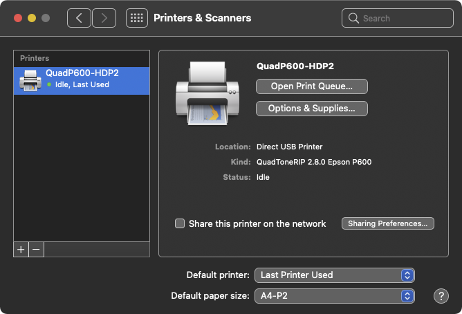

Not that important, altough I’ve installed QTR 2.7.10 - why it’s indicated as 2.7.9 in the following screen? Or have I missed something?
It will just say 2.7.9 but it’s actually 2.7.10
