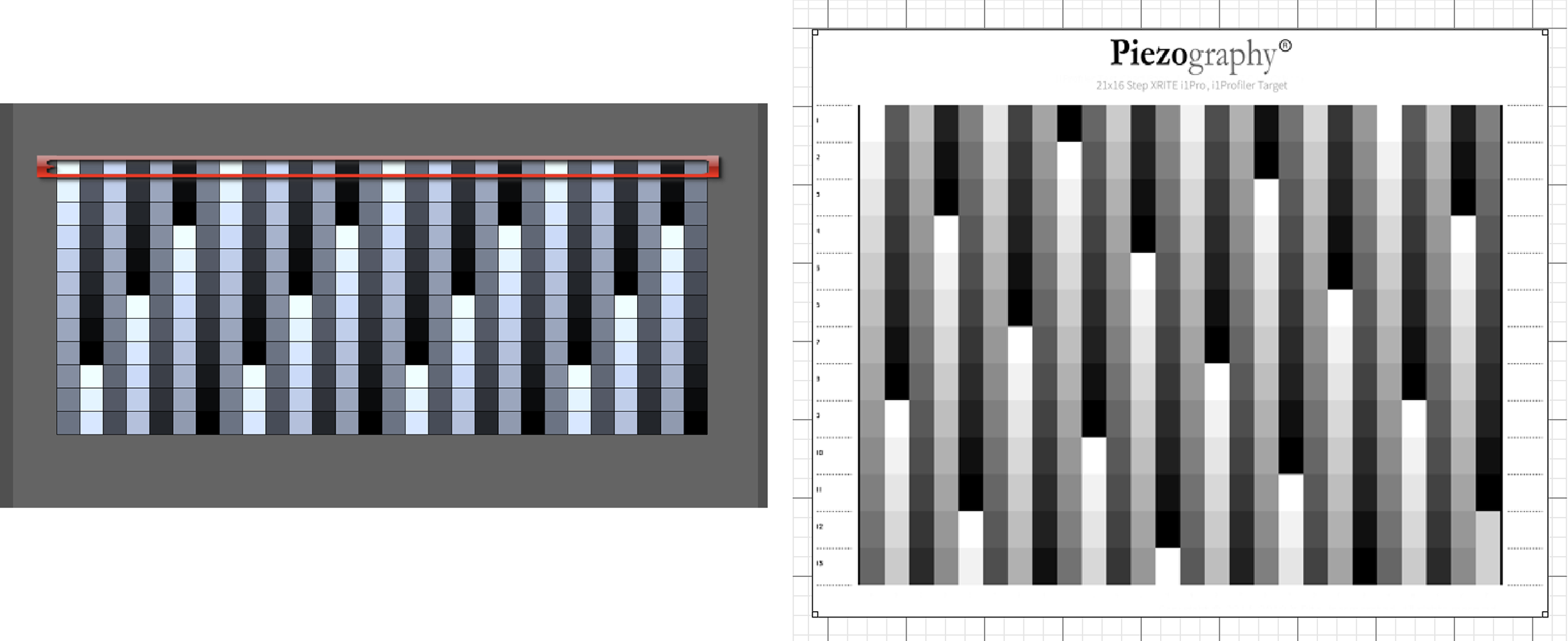

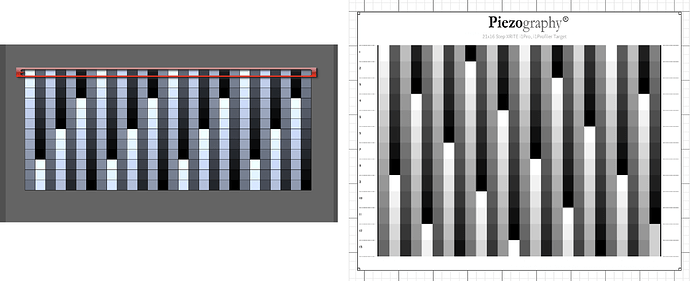

I’m having the same issue, the “no substrate detected” and I am giving the meter sufficient time on both ends and am moving it slowly. Also while the target on the screen indicates “i1p2-iProfiler- 21x16 fixed” it does not accurately match the printed target. The printed target is 13 vertical rows x 26 wide, in the i1prolfie software it’s 12 x 28.
21x16 step i1Pro3.tif, 21x16 step-i1Pro3.pPXF (Pwxf is not recognized by the profiler software)
Basically stated they don’t match. Further in the piezography target folder the suffix is pwxf, which the iProfiler software does not even allow usage of.
This is with a brand new i1profiler Basic and i1profile 3.6.3 using Monterey.
Looks like you have an old version of Community Edition installed.
This is the correct workflow:
Piezography-21x16step-i1Pro3.pwxf.zip (8.3 KB)
I have community version 3.3.1, that seems to be the most recent version I can find.
And still I have the issue where the i1profilier does not recognize PWXF files.
I’m really not sure what to say here . . . .
Got it. I was loading the target by hitting load and getting a window that I would then follow to community edition and get the target there. But it would not see PWXF files. However now I see that the piezo targets are ALL in the saved workflows drop down of profiler, which I assumed was empty because I never saved any workflows and did not know how i1profiler would have put them there without my action.
