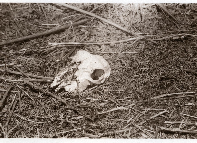

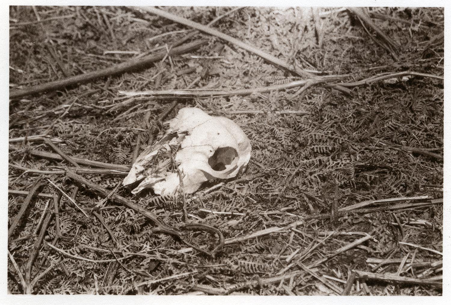

It worked! Very pleased with my first attempt at calibrating a process! Looking forward to working out the nuances now :slight_smile:
That’s a scan of a salt print with 20 mins exposure in my UV box. Looks a very good comparison to the original file.
!!! THIS LOOKS GREAT!
I’m glad it’s working for you.
That’s printed on the wrong side of the paper, short of the standard printing time. So room for small improvements!
Amazed at how well the first print has come out without any tweaking though.
