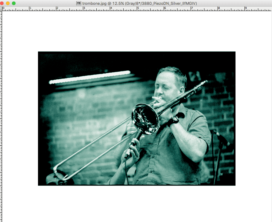

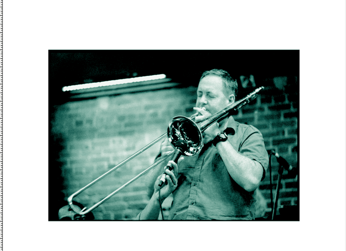

Very strange with any of the soft proof profiles for silver. If I load any of the profiles labeled silver, from the 4900, 3880, 9880, folders the preview on screen is a distinct green tone. This is on a single channel greytone file or any file. Never seen this before , all of the other icc’s profiles behave normally. How is this possible on a greytone?

Adding a screen grab of what I’m seeing. Note the top tool bar info.
Adding a screen grab of what I’m seeing. Note the top tool bar info. [attachment file=978]
I can answer the how, but not the why. The A and B data are used to simulate paper and image hue in the soft-proof. No idea why you are seeing green.

This is odd. Will investigate and get back. Could be corrupted profiles.
