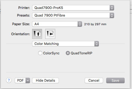

Settings for Print Tool 2.1.1
Hi
I have just printed my first Pro print on Canson Platine Fibre using the Epson 7900. I have flushed the printer using the Flushing carts. Seems like there is still some flush ink in the GO channel - so the GO looks red…
Apart from this the tonal value look very nice. However I am still unsure about the color management settings. I have attached the setting I am using. Pls let me know whether this is ok - and if so pls add these settings to the manual.
Best, Markus

If you look at the screenshots in the manual in the “printing” section, you will see that “no color management” should be selected and 16bit should also be selected.
Everything else looks just fine.
