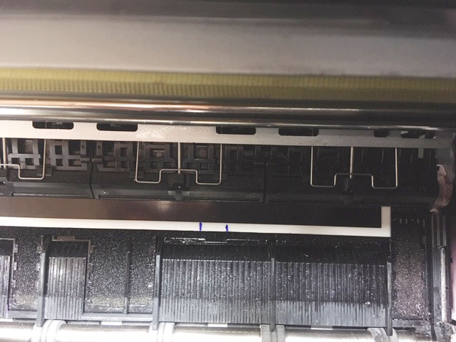

I marked (in blue pen) the location of the problem band and fed it into the printer. (Printer head has been moved off to the side.)

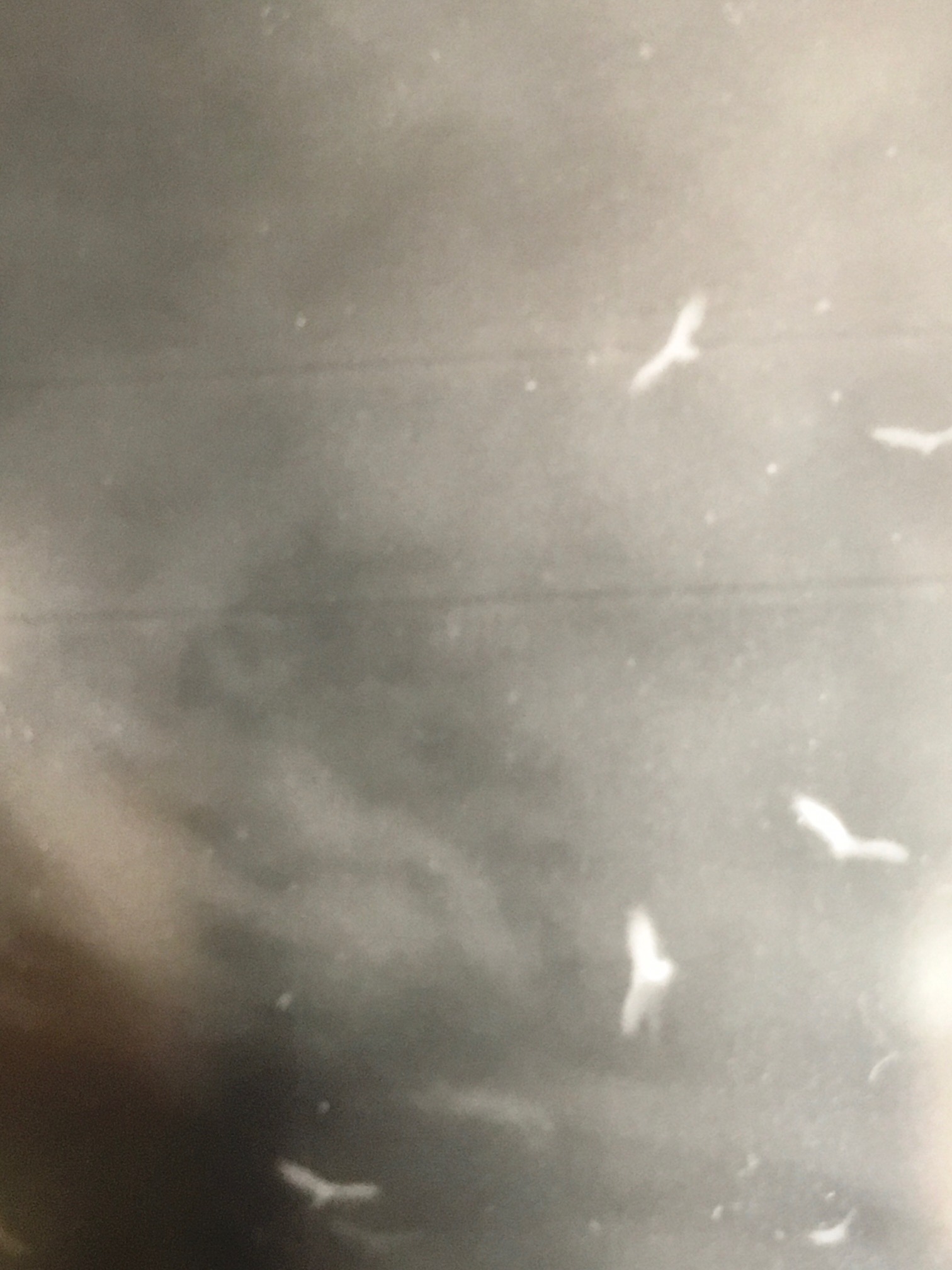

This is a photo taken after a test print with platen gap set just to wide. The 2 parallel lines are 3/8 inches apart and run top to bottom, not side to side. I don’t see the lines in the black areas surrounding the image on the pictorico.
Hey, Walker. There is some crud on encoder strip. (I didn’t even know there was such a thing until half an hour ago!) I could try to clean it with some alcohol and a lint free paper towel.

Yep. Looks like an encoder strip issue. Clean that with some rubbing alcohol.
Walker, thanks so much for your help. I cleaned the strip sufficiently to resolve the problem. Looks like I had gotten some Piezo Flush on the strip. Not much came off with the alcohol but I either got something else off, or enough of the Flush off to make a difference.
