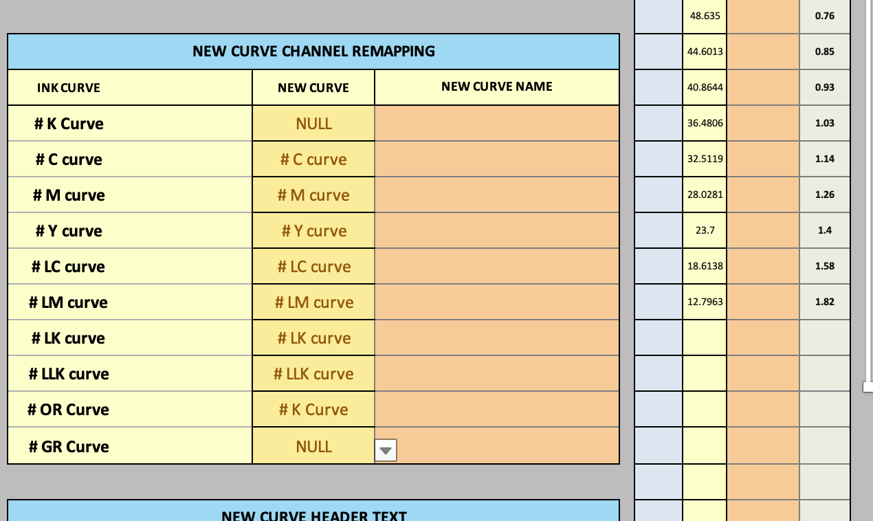

I have a dead PK channel, so I plan to put the HD PK in the Orange channel and the UltraHD MK in the Green channel. I’d just like to check if my understanding of the remapping process is correct.
If I print on a photo paper like Platine Fibre Rag, I remap the K cure to the orange channel (HD PK), making green NULL and original K Null.
If I print on Rag Photographique I would remap the K curve to the green channel (UltraHD MK), making orange NULL original K Null.
Screen grab attached showing my modification to a Platine Rag curve.
Have I got my thinking correct?

Yes, that should be good. Obviously you’ll need to do that same thing to all PK curves separately with the pk in the green. This work out for you ok?
Sorry for the very late reply. Yes it did work perfectly and I have spent some of my isolation time learning the valuable tools in Piezo Pro and doing some linearisation. I have learnt a few lessons which may be valuable for others new to this process:
  • The you start PiezoPro it has sample data for measurements and curves. After I remaped the chanels and chose a 9900 curve for Rag Photographique 310, I didn’t clear out the measurement data. This lead me down a path of inaccurate linearisation. Now I always clear starting curve and measurement before I do anything.
    • After remapping curves the first time , eg K to Gr or K to Or to bypass a faulty PK head, the always leave K as Null and Gr as GR from then on. Don’t map K to GR again or you will end up with 0 values in Gr.
