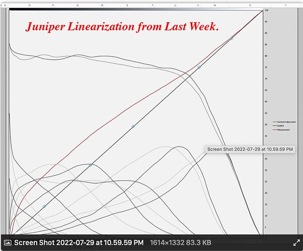

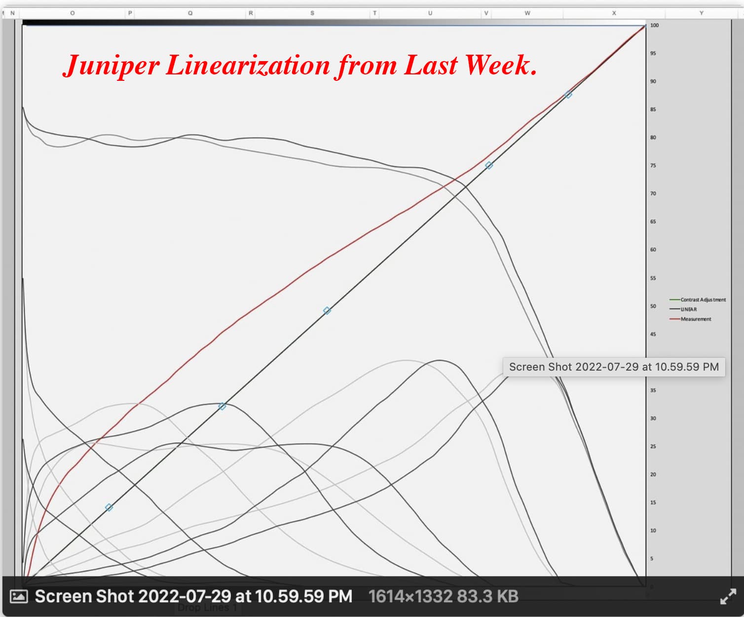

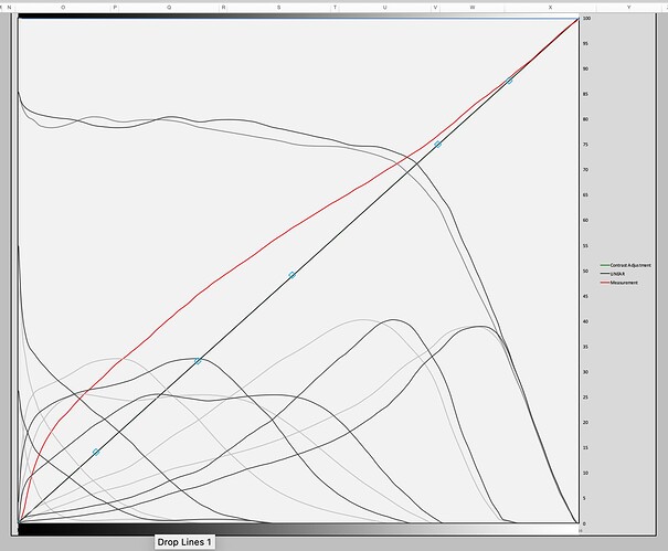

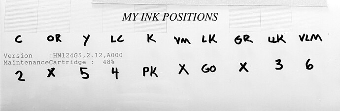

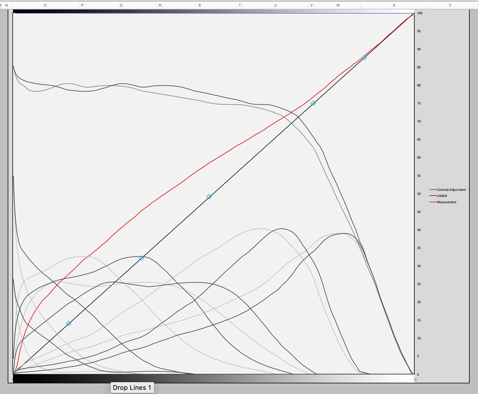

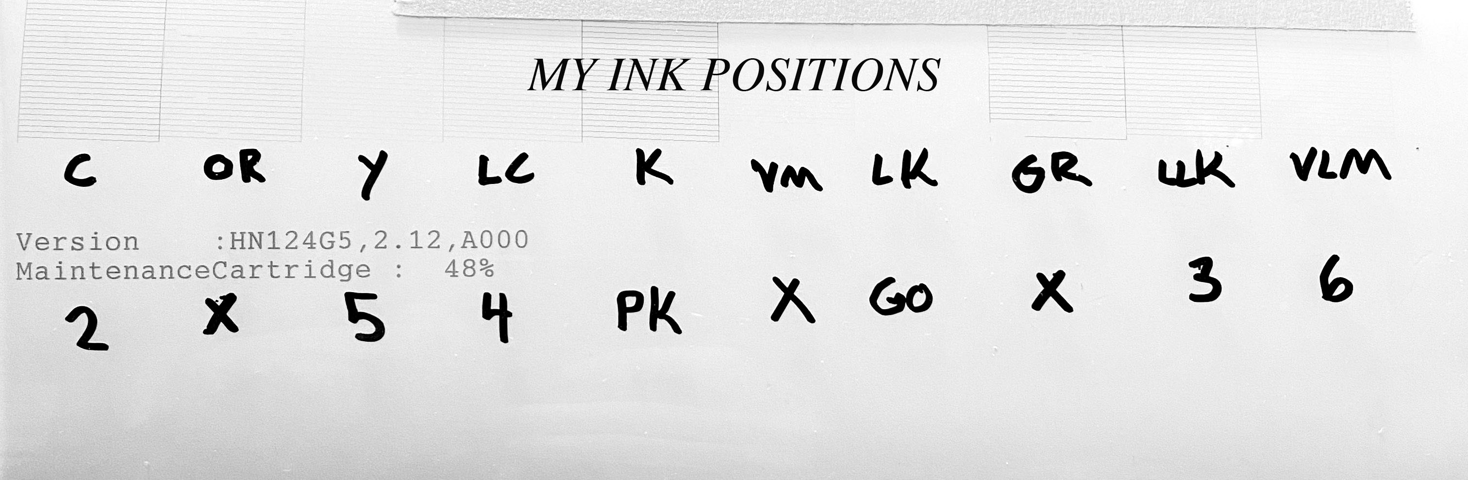

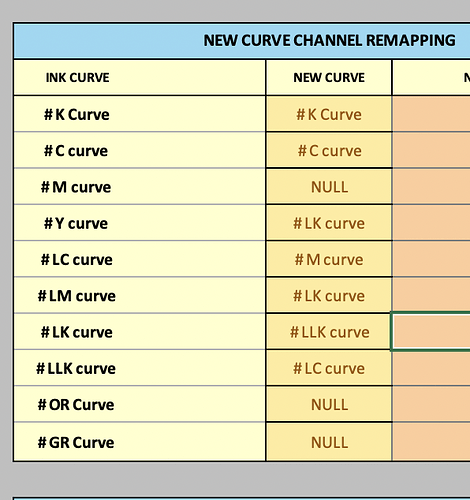

Hey, Just wanted to double check my remapping here-- PPE2 remap tool is awesome but it always such a struggle for my pea brain to wrap around. See the two images and curve attached. Remapping from Selenium HDPK Master. Seems really light from most linearizations I’ve done. It’s on Moab Juniper Rag.
Thank you in advance! I super appreciate help with this brain teaser.

Here’s my readings (averaged from three readings each shade QTR Cal mode 100% Ink on Platine):
1: 2.05
2: 3.6
3: 14.9
4: 30.1
5: 62.1
6: 72.2

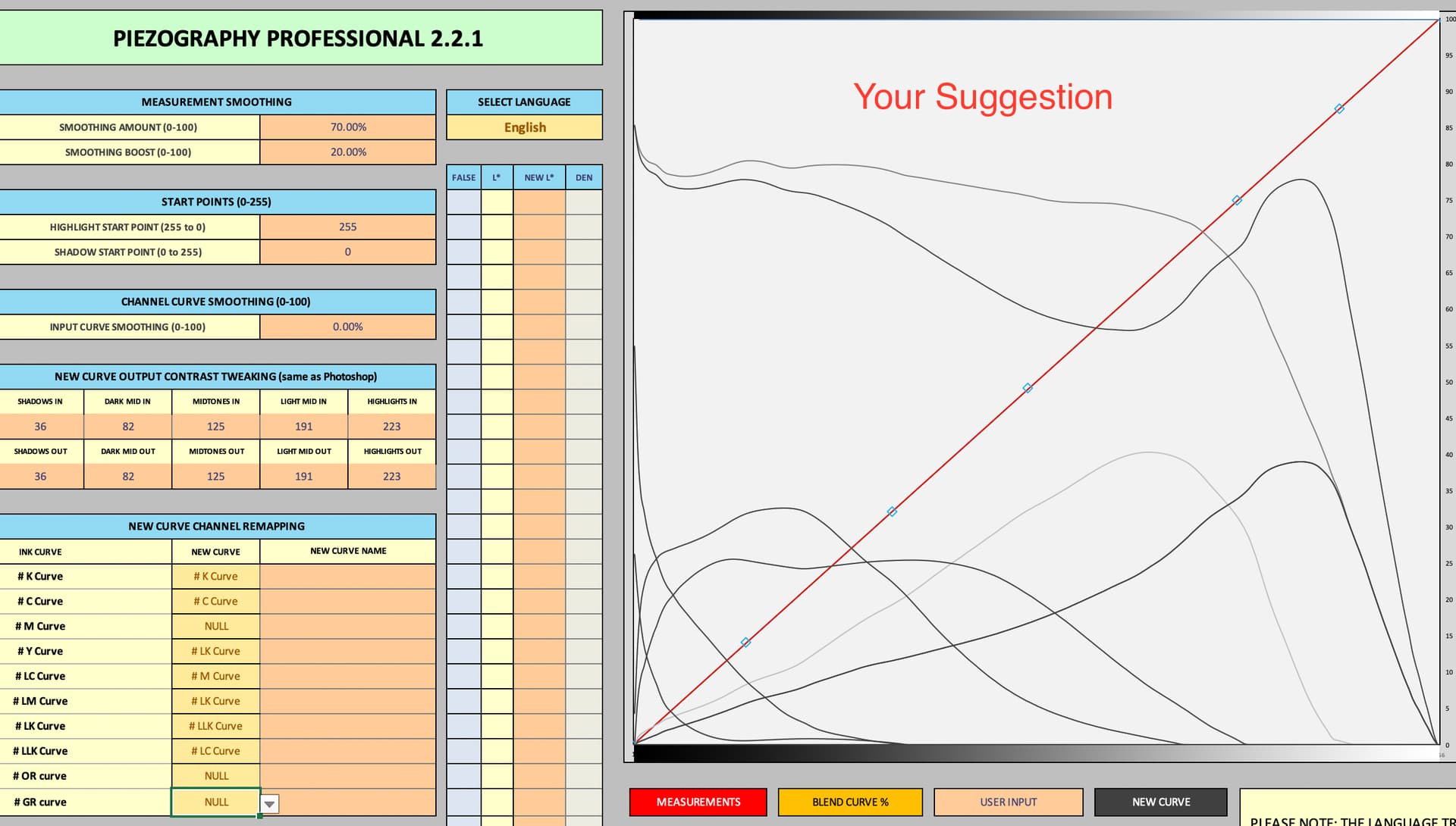

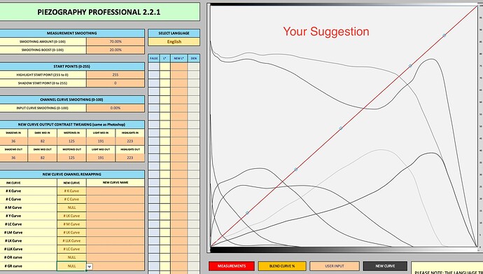

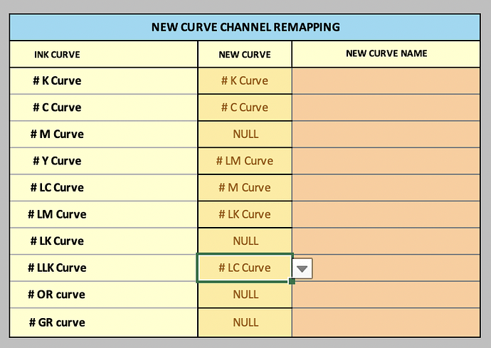

I think this:
Thanks Walker! I’ll try when I get home

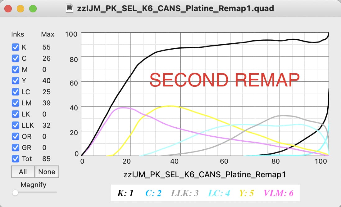

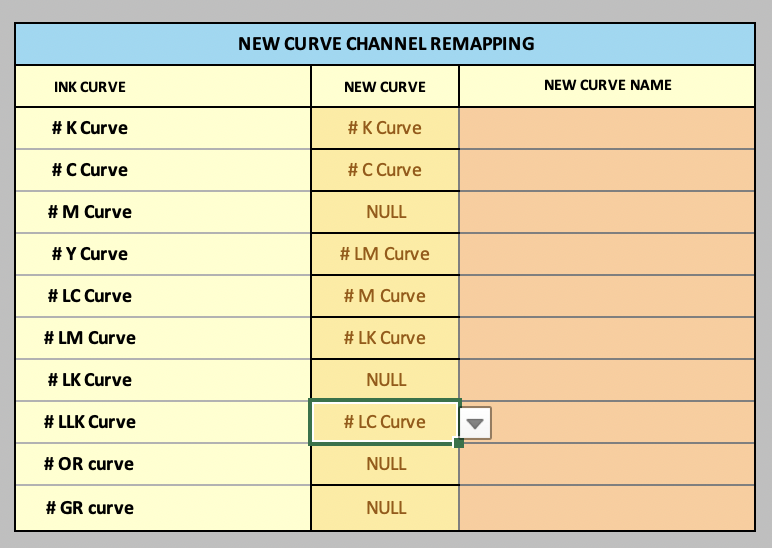

Welp, I guess maybe my printer is just printing super light still. I plugged in your suggestion exactly and it looks like this:

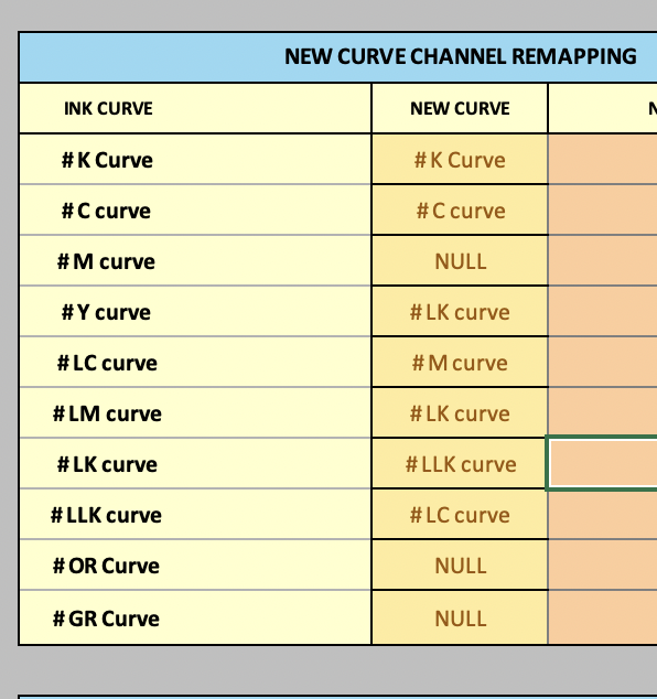

Your suggestion seems to be missing the Y shade 5, so I did this and realized it’s exactly as I had it before.

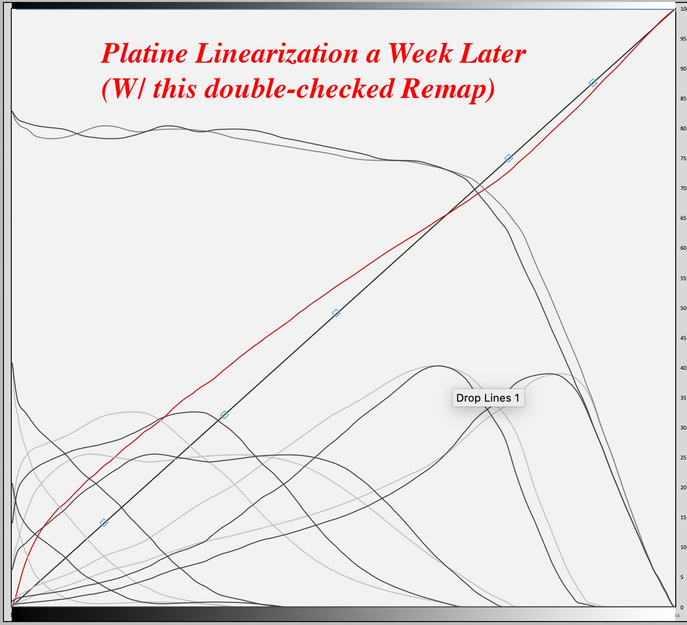

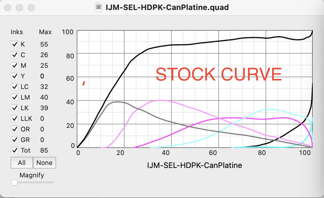

This time I printed on Canson Platine w/ the Platine stock curve. Different than the Juniper, but still quite light… ] humidity was the same, temp was about 5º hotter, fwiw.
idk, it’s darker than last time, but I’ve still never seen a curve this off from the master. I checked each curve channel in curve view, and as far as I can tell, they are correct. Am I crazy? Is my printer just super off? The head is really old I guess.
