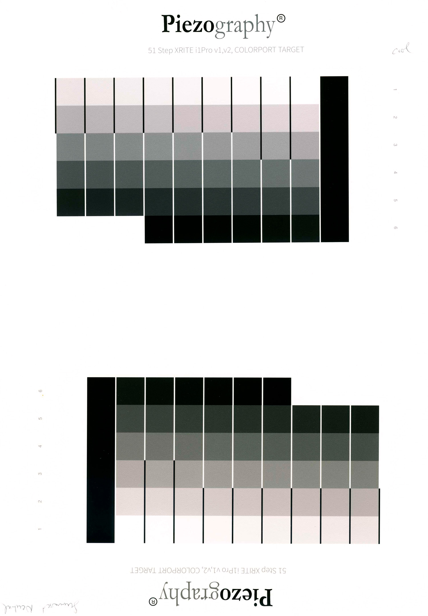

Seems like not only the Chroma Optimiser is suffering from the Piezo Flush reds.

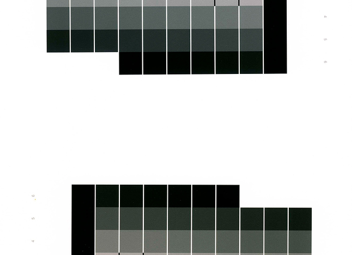

I have switched to MK papers - and I have a red cast in the light colors.The attachment shows the output of the neutral and the cool chart. What do you suggest?
Thanks, Markus

The 7900 has had a head replacement. The dampers were fine, so was the cleaning station. The nozzle check was perfect with colors so I installed the Piezo flush carts for 20 minutes with an init fill. The maintenance tank was brand new from the head replacement.
Then I installed the Piezo Pro carts and did a second Init Fill. As reported I had the red staining in the light inks and the GCO. I tried to get rid of it by printing GCO sheet wise but did not succeed. Then I switched to MK and saw the same problem in the light and very light tones as well. Before doing a third init fill/cleaning I checked the maintenance tank saying that it still had 20 % - and it was flooding the printer…
After cleaning this mess, I entered maintenance mode and cleaned the very light and light tones (LLK/ and Or/Gr) pairwise using CL4. Before I did some testing with linearising but of course this does not make sense if the output is not how it should be. Blacks are impressive already. (> 1.8) … After the CL4 it looks as if the red cast has gone and I will restart testing before doing another Init Fill.
