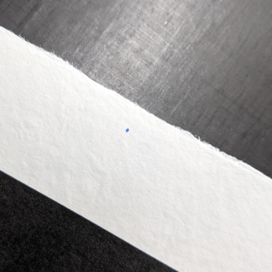

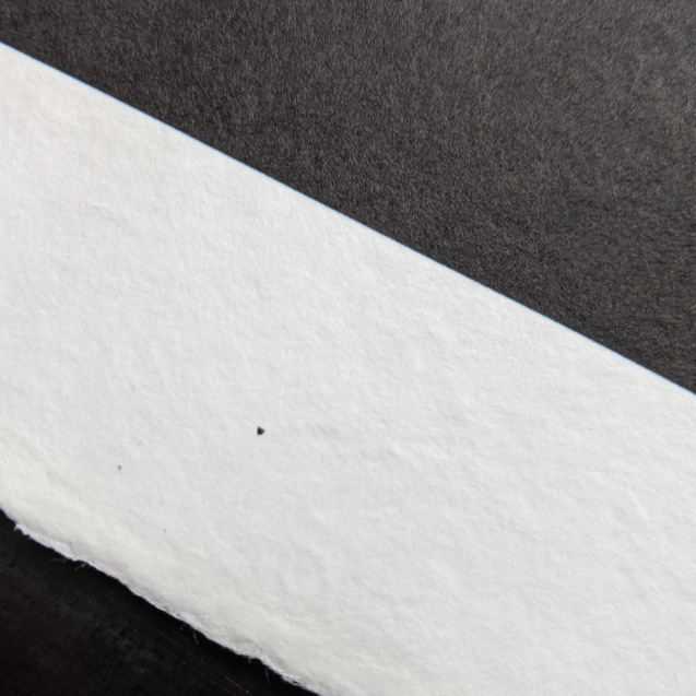

Hi,
Time to time I get some drops of inks (mostly in the non printed area) on handmade Bizan paper.
I have no problem with rolls on regulars papers.
Platen gap is at the widest, the pad seems to be clean, not full of paper fibers.
Any idea ?
Thanks a lot !
Frankie
dirty head dripping ink as it stops and returns. Time for maintenance:
