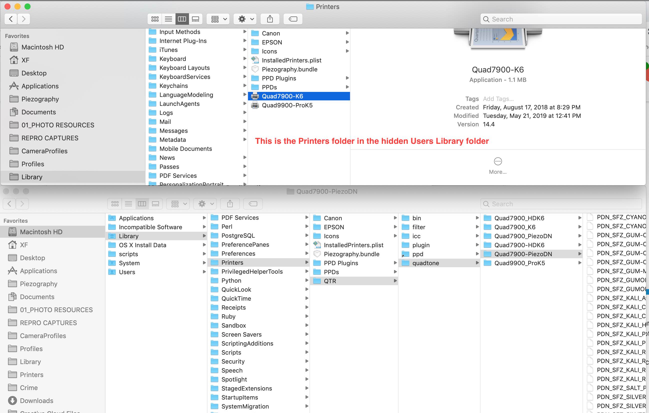

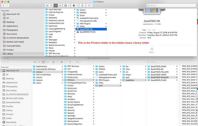

Hi, looks like there are two different Printers folders, and the one I usually deal with was redundant or… something. I usually have a bookmarked folder to the hidden users Library folder (Go > [Press Option} > Library) that I then go to the Printers folder, QTR.
I found that while I deleted the QTR folder from there and reinstalled, these icons show up in place of the QTR folder, but the QTR folder is still extent in Macintosh HD > Library > Printers.
Not sure if this is still gonna be a potential corruption issue. See screenshots:
