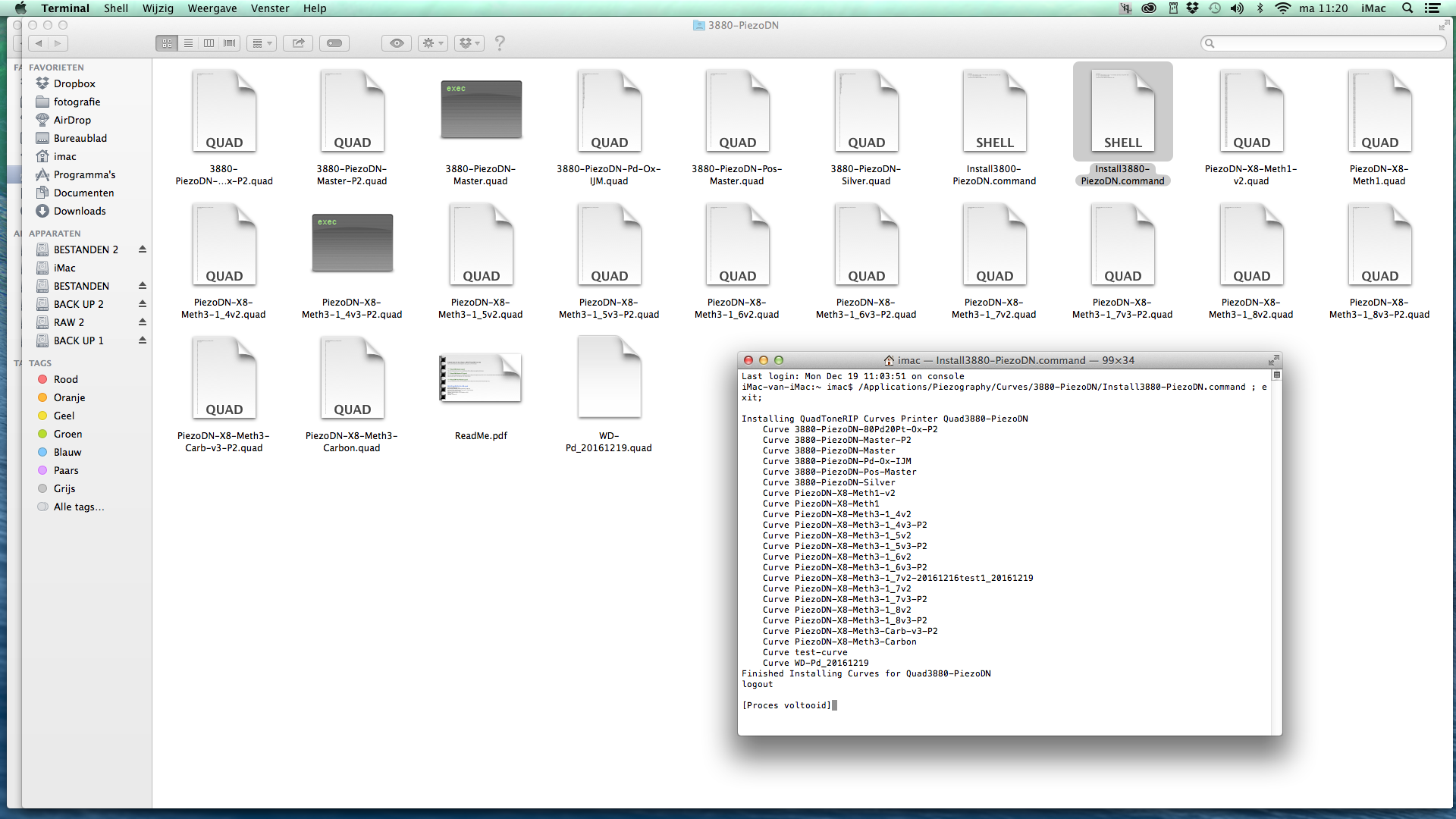

I’m experiencing exactly the same problem with a 3880 (with the older ink setup), on an iMac with OSX Mavericks 10.9.5.:
  • QTR option is gone
  • I deleted some test .quad files
  • the Quad3880-K7 does give the QTR-option
I did not notice a message about a printer proxy when deleting the .quads.
I reinstalled both QuadtoneRIP and PrintTool. I even restarted the iMac.

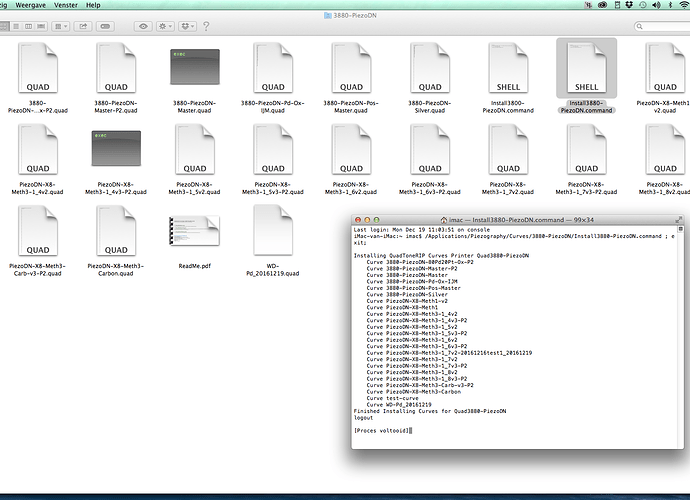

I reinstalled the curves of 3880-PiezoDN and something strange happens: it says it installed curves that are deleted, i.e. the test .quads. These curves cannot be seen in the folder with the curves. See screenshot: the curves “test-curve” and “PiezoDN-X8-…_20161219” cannot be seen in the folder, but show up in the terminal screen
[attachment file=26114]
I don’t know if it is important: I am not able to save .quads directly into the 3880-PiezoDN folder. I can only paste files in the folder.
