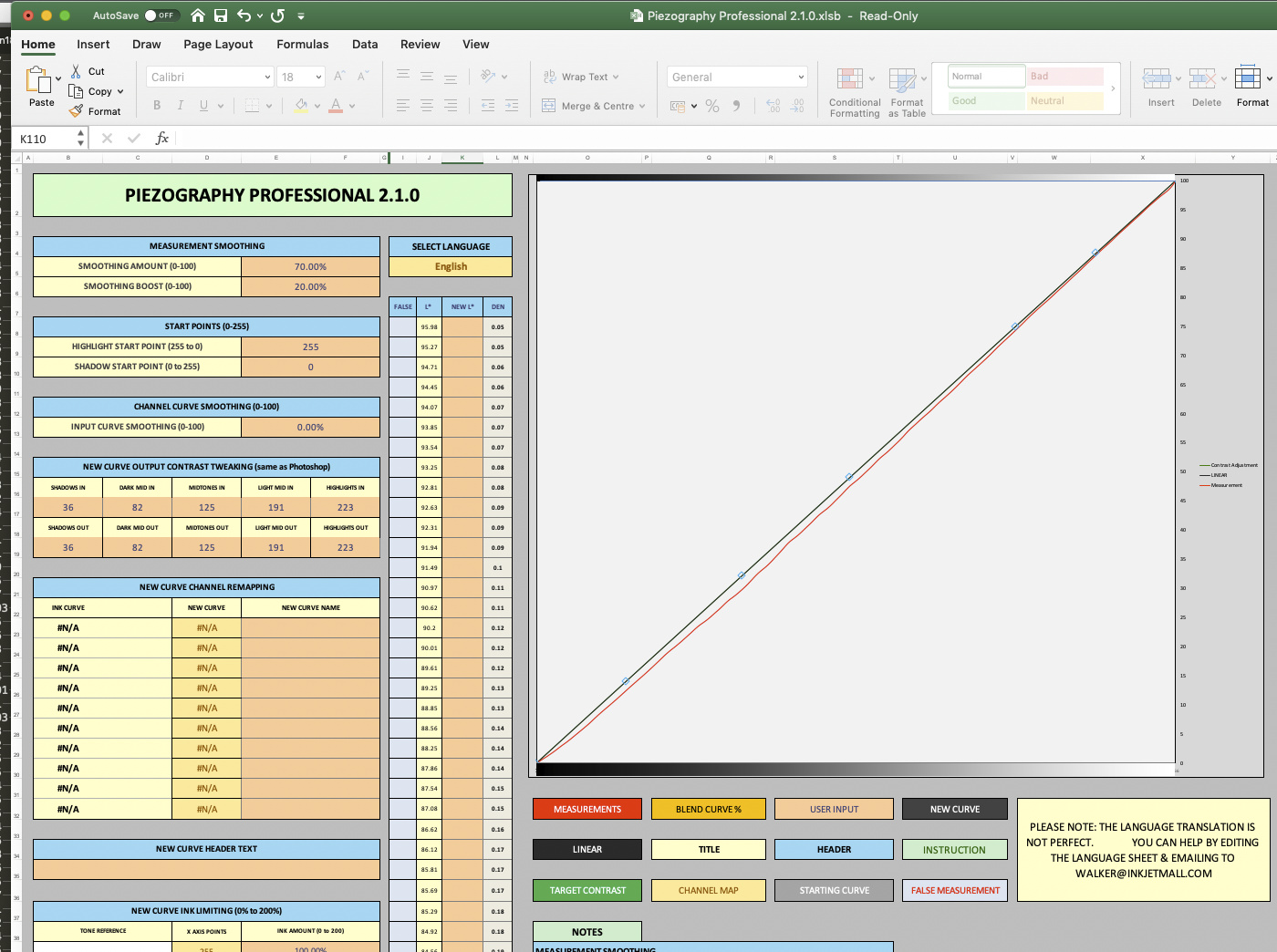

Problem starts with my machine (9800) that consistently prints dark. To illustrate this I am attaching a screenshot which shows the measured values from step one (i.e supplied PhotoRagBaryta Warm curve, print the 256 step target, dry overnight, measure in ColorPort with i1Pro2, import into PPEv2). As you can see shadows and three quarter tones are dark.

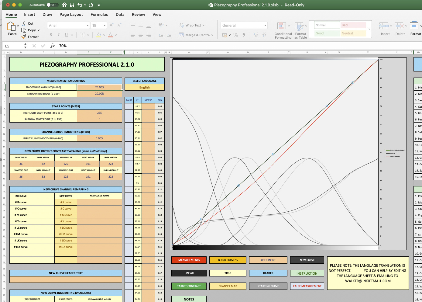

Go to step two (install new/linearised Warm and Cool curves, then blend new curves in PPE at 18/78 to create ‘neutral’ curve. Print another 256 step target using new ‘neutral’ curve. Dry overnight. Import measurements into PPE - result is much better but still a bit dark, see screenshot #2 below)

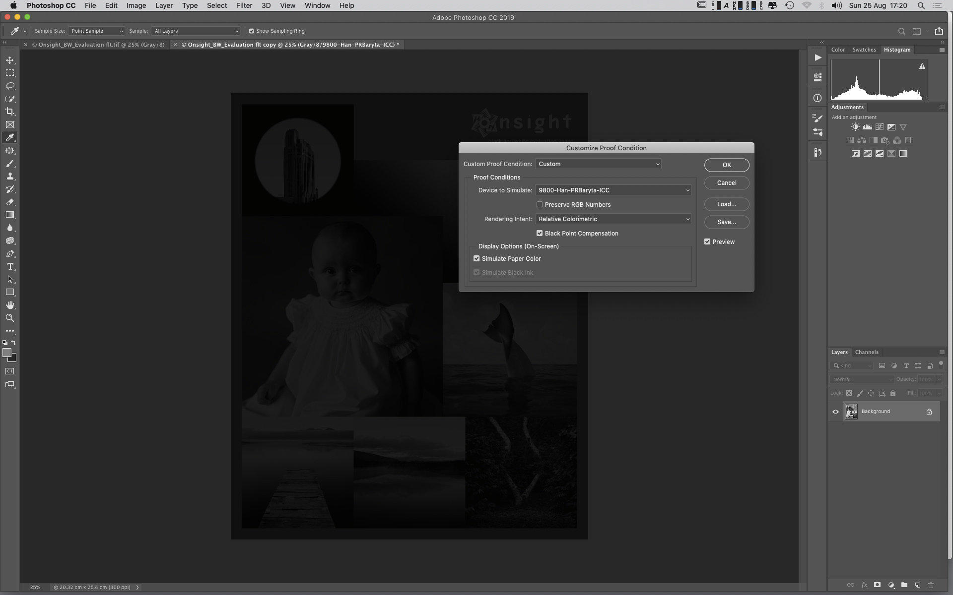

Also, if in softproofing, if I turn ‘Simulate Paper Color’ then the image goes black like a mask - see attached screenshot #3 - this can’t be right?

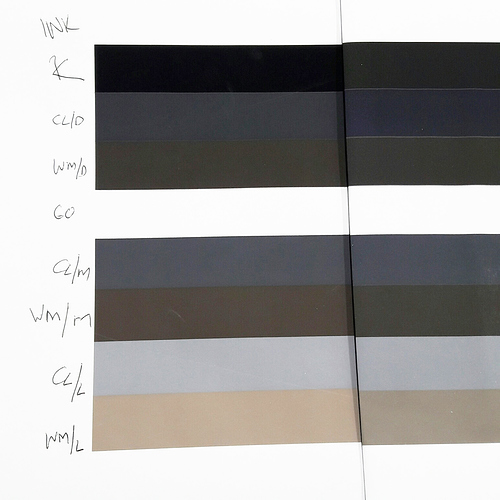

I printed an ink purge (‘8-ink-purge’) file and compared it to an older ‘ink purge’ print I had on file.
See attachment below.
The older ‘correct’ print is on the left and underneath
Wildly different across the board
The K channel should be different due to older print was with MK ink and I currently have PK loaded (and I am using a cheap matt coated paper for the purge print)
But the other channels should all be the same, but are dramatically different.
The Cool Dark has gone strongly cyan. All 3x Warm channels have ‘warmed up’.
(note- the CGO and LWm channels are remapped due to missing nozzle in Yellow channel)
I am guessing this is due to ink settling? Pigments separating out and settling to bottom of carts?
But system is currently unusable it this condition?
Yep. Ink settling. Need to agitate your carts every 2 weeks.

Its strange because we do shake the carts regularly.I thought we where doing it at least every 2 weeks, possible that a couple weeks got sniped over last couple months?
Settling seems worse in carts that are running low.
Lessons learnt are firstly to be strict about agitating carts and second to keep a reference ‘purge print’ on file to regularly print a new purge print and check that the colour on individual channels is stable.
still not understanding though why checking ‘simulate paper colour’ in soft proofing turns my image black?
Simulate black ink is a hold-over from the CRT days and does not work properly on LCD/LED monitors.
There could have been batch change + settling between these two prints. We did reformulate Pro in late 2017 for better steric isolation of the particles (less settling) and this increased the cool chroma a bit (no difference in pigment though). You should never let your carts go below the halfway empty point on this printer for lots of reasons fyi.
You most likely have PK selected on your printer instead of MK (re: the top line).
My created ICC has also same matter.
‘Simulate paper colour’ turns the soft proof image black.
Not ‘simulate black ink’.

When I create an ICC to print with, ‘simulate paper colour’ turns soft proof image black
I do not have any idea why nor have I been able to resolve

Simulate paper color should not be used. It turns on Black ink simulation which is a hold-over from the CRT days and does not really work even on well calibrated LCD/LED monitors.
Thanks Neil & Walker
That is good to know. The ‘simulate paper color’ worked on ICCs created with PPEv1 so I just wondered. However soft proofing on Photoshop is just a guide, not showing correctly. We have to judge the results with the prints anyway, so it won’t be a big matter.
