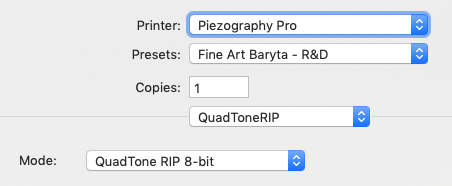

What you could do is force QTR to 8 bits mode and it will print fine (see the printscreen).

Won’t printing at 8-bit have an negative impact on print quality ? I have lots of smooth gradients in my images and if I print them as 8-bit FILES I get lots of banding. Or am I confusing two 8-bit concepts ?
Paul
Hi Paul,
I didn’t see differences but the files I printed at the moment were targets with patches (huge one), no gradient at all.
I asked the question to Roy when I had this problem about the downsides of forcing the printing to 8 bits and here is what he answer : “For 16-bit I’ve never seen any way to see a difference - loupe/no loupe.
Everything on a print is simply a dot of ink or a missing dot – so basically 1-bit. There maybe multiple inks (2 or 3) at any
place, and dot res is higher than pixel res. But all in all printers don’t come close to representing those max levels and detail
at the same time. The final bit depth is going down to less than 8 as it is.”

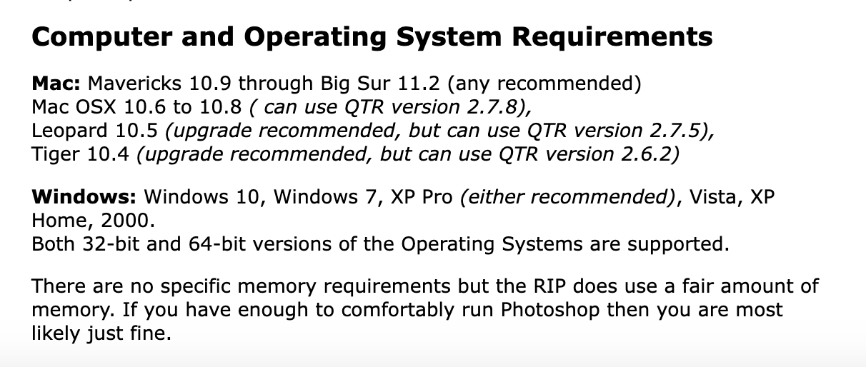

I downloaded the QTR and when I tried to install and it gave me an error that my macOS is incompatible with the QTR. I am using Ventura 13.0.
@dblanchard Did you check out “Computer and Operating System Requirements” here?
