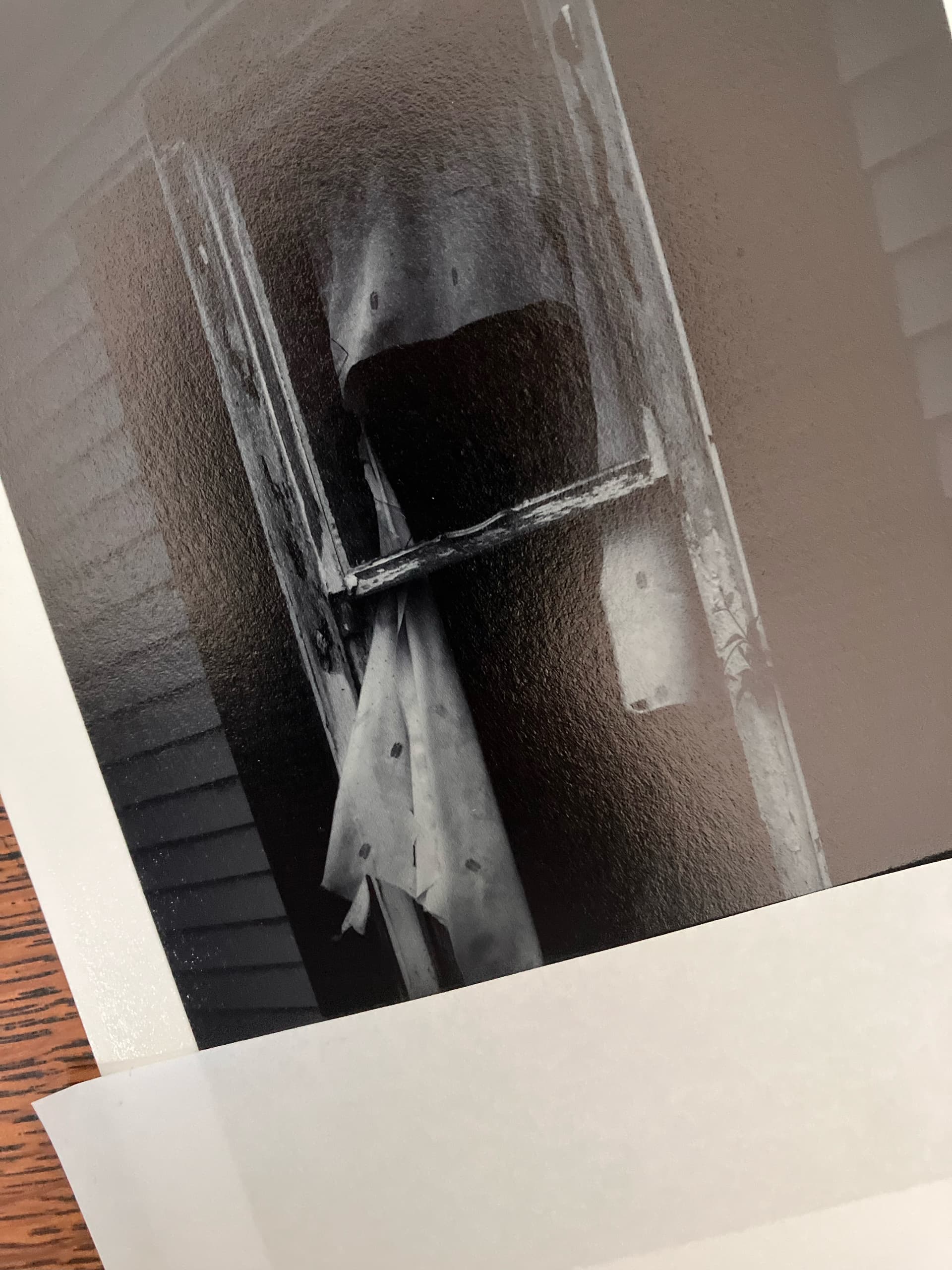

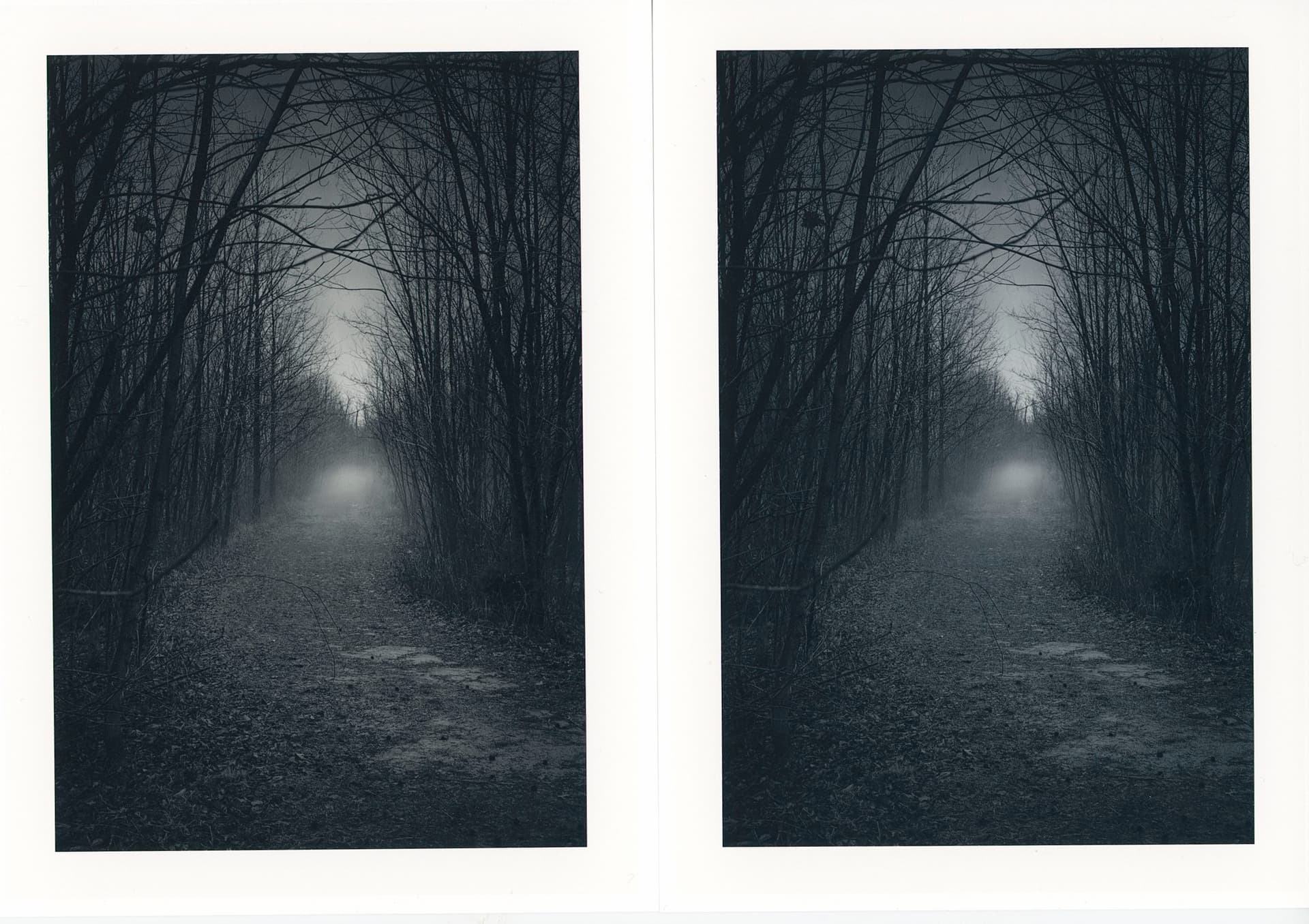

Ive been using the piezopro inks for prints for the last year with much success. Lately, I cant seem to figure out what is happening but, my prints come out with very cool tones. I have used the same settings and have saved them in a preset in print tool. I believe nothing has changed in my workflow to cause this change. In print tool I have turned off the split tone print option in QuadToneRIP and I’m still seeing these cool tones.
Here is a close up of the cool tones I’m seeing on Moab Juniper Glossy. I’m printing on a epson p600.

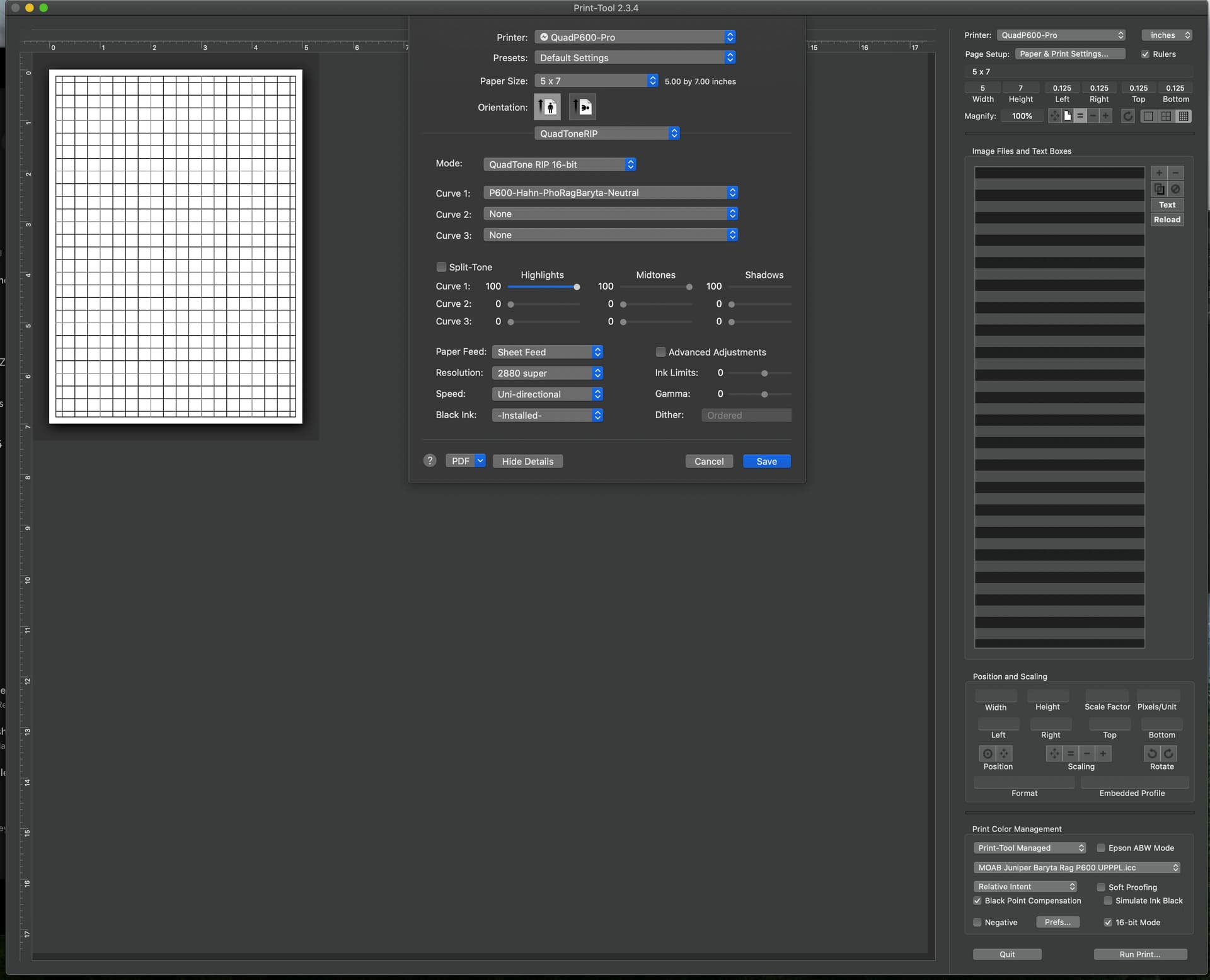

I cannot really troubleshoot anything in terms of looking at the print as to what has changed to make your prints cool when they were not previously. I would need to know the curve or curves you selected… that would be first up… Send a screen capture of your printing setup in QTR that shows the curve/curves and settings…
after which I may have other questions for you.

Hey Jon,

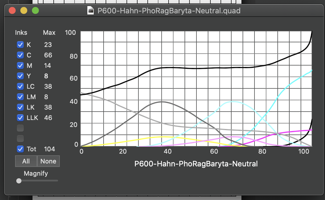

I used the factory P600-Hahn-PhoRagBaryta-Neutral quad curve. Ive never adjusted it since it was working good. The print looks like I had every slider on the cool quad curve turned to 100 on each.
Here is the QTR Curve view
Perhaps you should print inkseparation8.tif in Calibration Mode and look at each of the individual ink channels to see if the warm inks have been contaminated. At the least it will rule out any ink contamination (cool inks in the warm)…
I notice you are printing with an ICC profile but that will not affect color, only adjust the contrast from linear to that which is contained in the ICC.

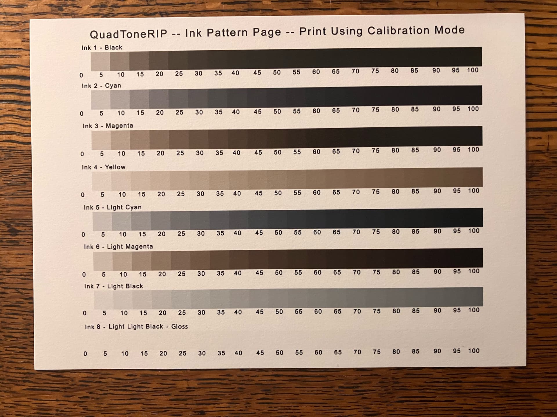

Sorry for the delay, I went out of town for the week.
Here is the calibation mode on the same paper. I printed this before I left.
Today I cleaned the print head and sponges with piezo flush and made another print. Still coming out cool toned…
This has been printed incorrectly… why I can not tell you but it would appear that the calibration image has been tagged (possibly) with a profile; or it has been opened in Photoshop (perhaps) at which time its color values were converted and then saved; or (perhaps) your QuadTone RIP installation is corrupted and needs to be reinstalled; or (perhaps) your OS X permissions (if you are on OSX) are not allowing the QTR printer driver to operate which can happen if you updated OS X.
So - these calibration images are untagged when you download them and must remain so… If yours is now tagged with a profile (you can tell this if you have setup your Photoshop settings according to our manual and when you open it the message that the the image is untagged does not appear) - then that is preventing your being able to print the target correctly. But if it is untagged - then it would probably point to permissions issues in QTR or corruption of QTR - and that would of course affect the output when you are printing with a Piezography curve.
I originally had you print this to see if you had an inks issue. But it is indicating instead a software issue that may be related. In any event, if you can not print the calibration mode image correctly I can’t see if you have an inks issue. Obviously you need find the software issue to determine if it is only related to this test or is also affecting your printing.

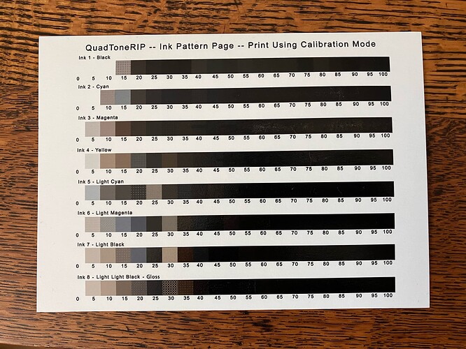

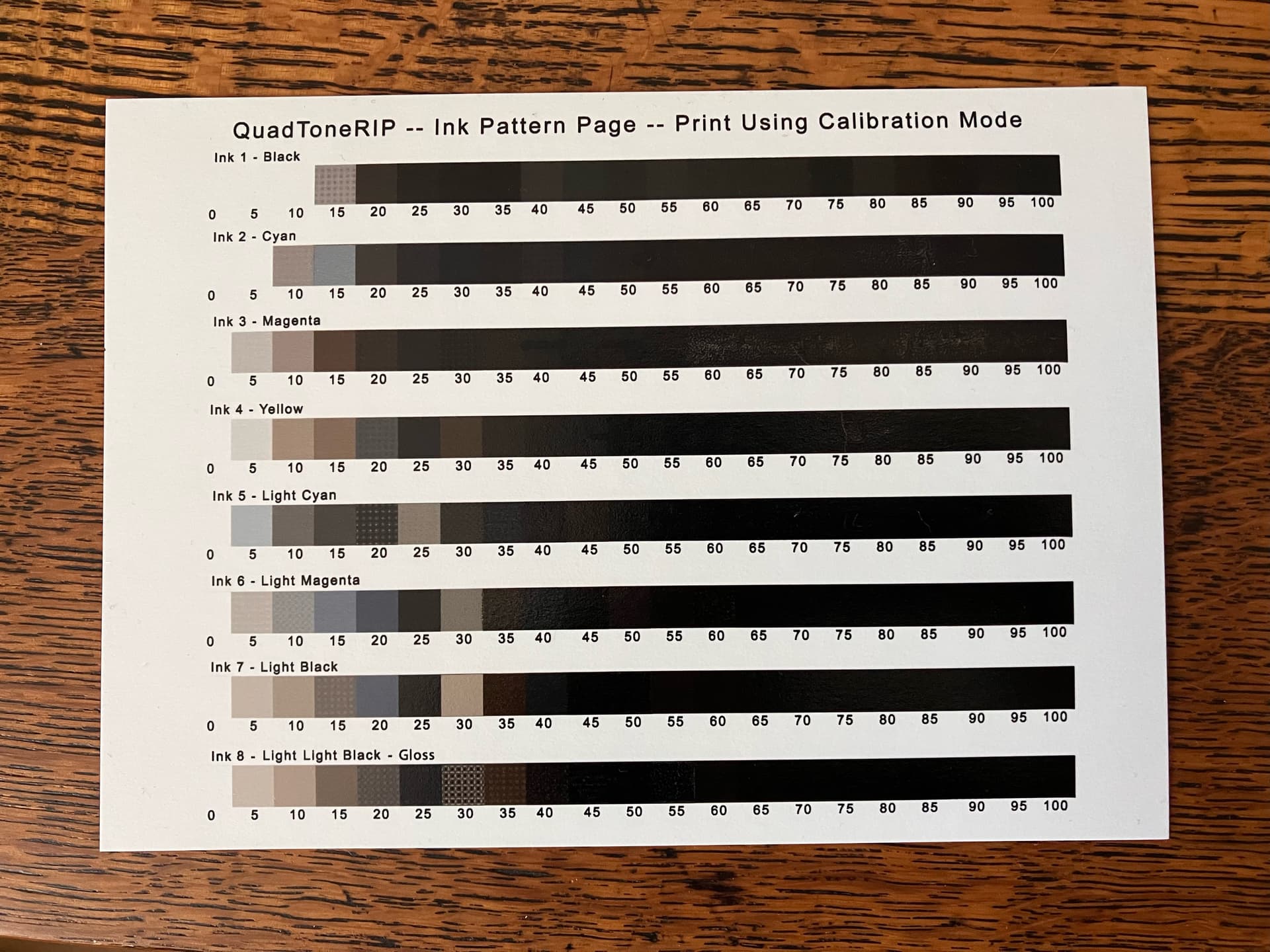

Hey Jon,
I reprinted it and came out with this.
I’m suspecting its QTR. I may try to uninstall and try to install again.
That’s perfect. So your inks are correct and without contamination. I did want to try and isolate whether you had an ink contamination problem or not. That you do not then leaves software / workflow issues… Try reinstalling QTR and see if the problem goes away.
