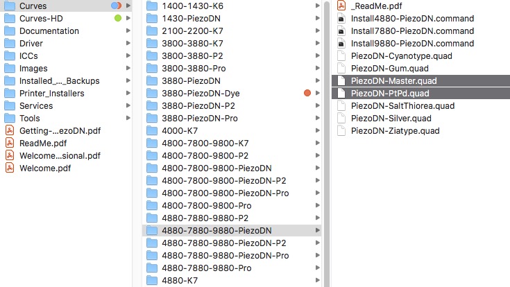

Hi Keith!
Thanks! What version of Piezography are you running? I ask because here is a screen shot of my curve folder!
The first 3 .quads are my linearized ones. Maybe I should upgrade to the v3.1 community edition, :slight_smile:
Screen Shot 2020-03-14 at 3.29.30 PM|690x261
best.
Michael

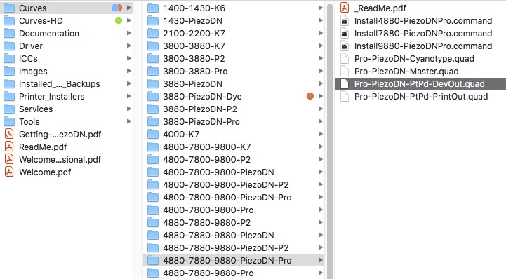

Ah So! I realized that your screenshot is not for PiezoDN-Pro. Since it is not labeled I assume it is K7? In any case I have the PiezoPro inks installed.
It looks like the three relevant .quads in the PiezoDN-Pro folder are identical. Curve view for the three are identical.
  1. Pro-PiezoDN-Master.quad
  2. Pro-PiezoDN-PtPd-PrintOut.quad
  3. x8xx-PiezoDN-Pro-Master-goldmastr
So it looks like I can pick any of these to start, :slight_smile:
best.
Michael

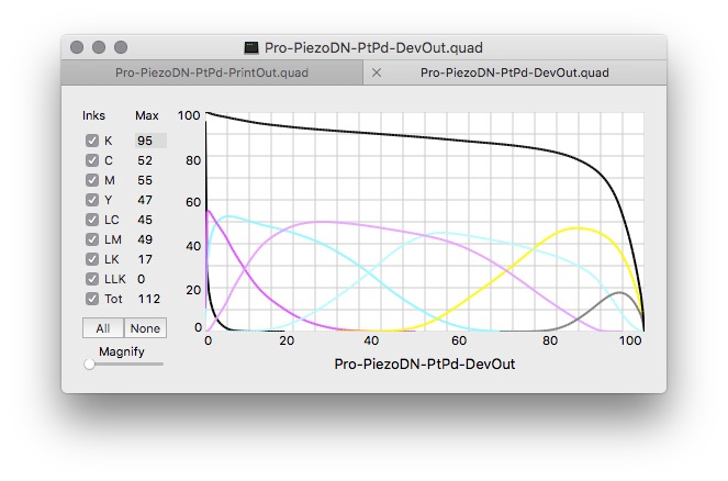

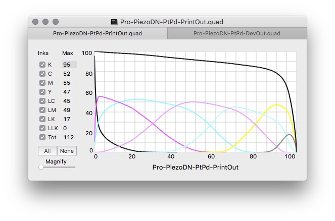

Oops! My bad. Here is the one I meant to highlight:
This looks the same as yours, except for your linearizations. Unless you have switched to Malde-Ware chemistry, use the one highlighted as a starting point.

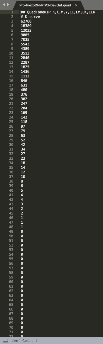

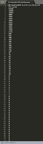

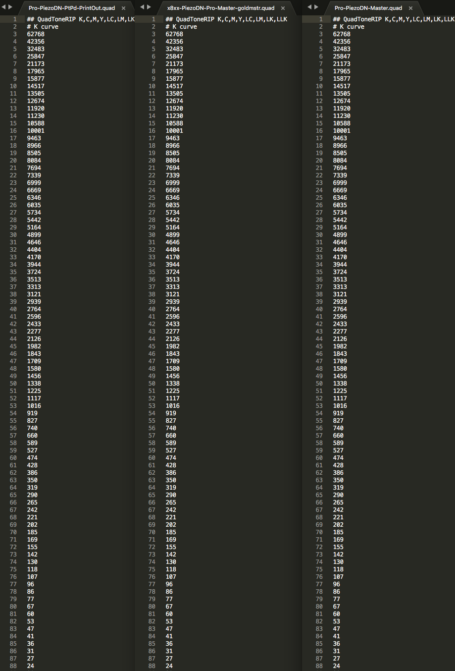

I assume the PrintOut.quad is for Malde-Ware (since your highlighted the DevOut.quad for me to start with)? If so why is it identical to Pro-PiezoDN-PtPd-PrintOut.quad is identical to Pro-PiezoDN-Master. quad and x8xx-PiezoDN-Pro-Master-goldmstr.quad?
That is correct, sir. Master and PtPd-PrintOut (and apparently goldmastsr) are the same, but PtPd-DevOut is not nearly as dense in the highlights.
Yep, my .quads match your .quads! :slight_smile:
So excuse my ignorance, but why are the three .quads identical if PrintOut is for Malde-Ware and DevOut is for “classical” (i.e. non-Malde-Ware)? The master and goldmaster .quads were published before Malde-Ware?!
Michael
I think the “goldmastr” pre-dates the public release of PiezoDN quads for Pro inks, and that is why you have it. It’s not part of the regular distribution, and, as I recently found out in another context, older curve folders are not deleted when you install a newer release. I’m sure that is a good thing, since it would seriously suck if folders (or even individual quads) you actually used were deleted by an update, but it can lead to some confusion.
My guess is that since Malde-Ware (Print-Out) PtPd is the longest scale of any of these processes, that it has become the default Master, since limiting from a longer scale quad as necessary is a lot simpler than adding ink density.

I’ll start with the DevOut. quad for the washi tests.
