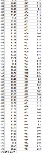

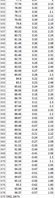

The measurement data I have from the ISIS XL target has 655 L* values, not 256 per the instructions in the Piezography Professional 2.2.1 tool.
Please share screenshots.

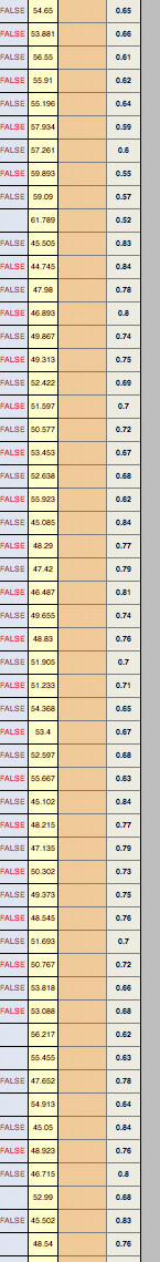

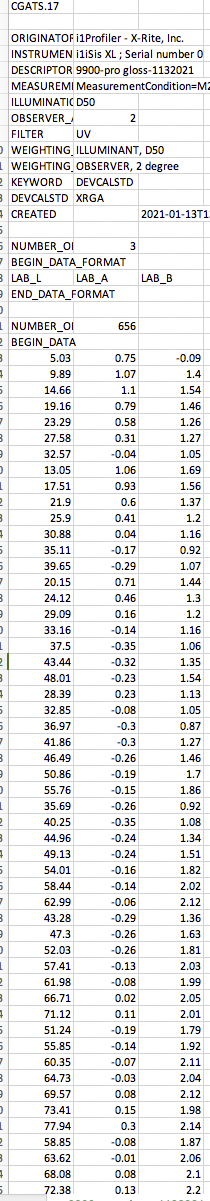

Here are screenshots of the data and the results in the Home tab.
9900-pro gloss-1132021_M2.txt (11.5 KB)
9900-pro gloss-1132021_M2-custom-cgats-lab-only.txt (18.4 KB)
Very strange that it would be that many rows.

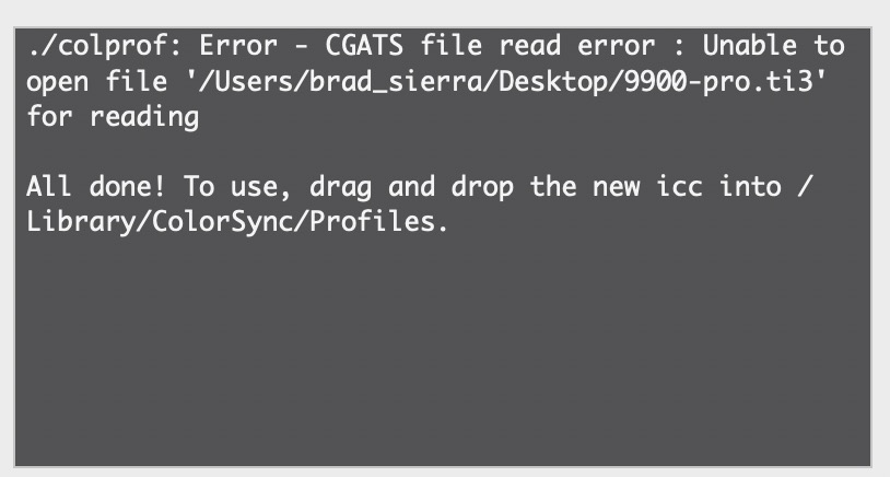

I printed that new target, measured and got the values into the Piezography Professional spreadsheet as expected. I have another question - when I drag the ti3 file onto Piezography-Icc-Profiler, I get this error message:
“​.​/colprof: Error - CGATS file read error : Unable to open file ‘/Users/brad_sierra/Desktop/piezo.ti3’ for reading”.
The ti3 file I tried to open containing my measurements is called “piezo test iccprofile.ti3”. It’s not titled “piezo.ti3” - I’m not sure what the piezo.ti3 file is.
remove the spaces in the file name

I removed the spaces in the file name and am now getting this error: " Unable to open file ‘/Users/brad_sierra/Desktop/9900-pro.ti3’ for reading"
