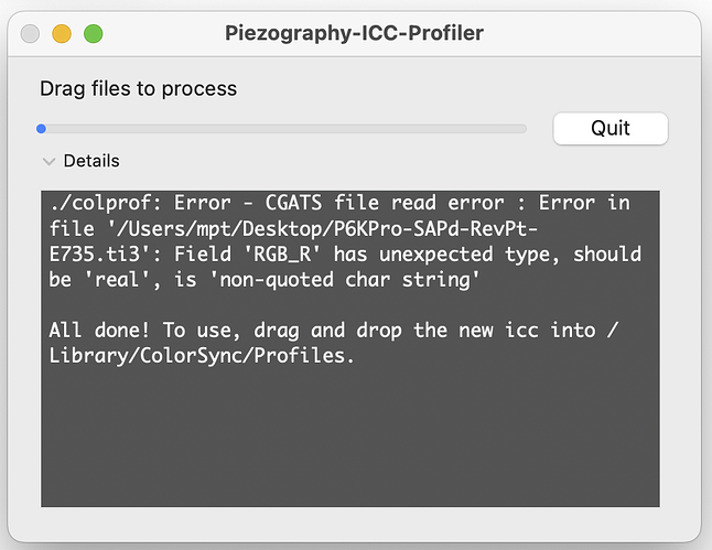

When I create the .ti3 file and drop it into the app, I get the following error.
Running Monterey on MacStudio (M1)
Thoughts?

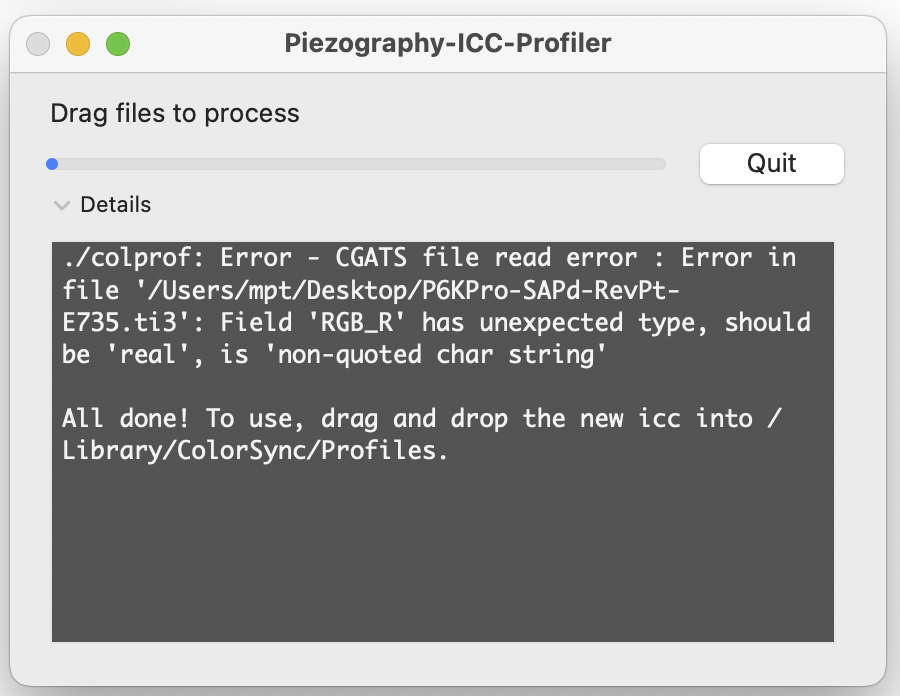

Thoughts?

Check the decimal separators in your ti3 file, should be punctuation, not comma to work. Use a text editor like Sublime Text to check and replace any commas.
Jarle
Jarle,
Thank you for this helpful suggestion.
I am not that familiar with the editing capabilities of Sublime Text. Is there a way to do a global search and replace as you suggest?
best.
Michael
Jarle,
I found the search and replace function. Thanks again for your suggestion! It fixed the problem!
