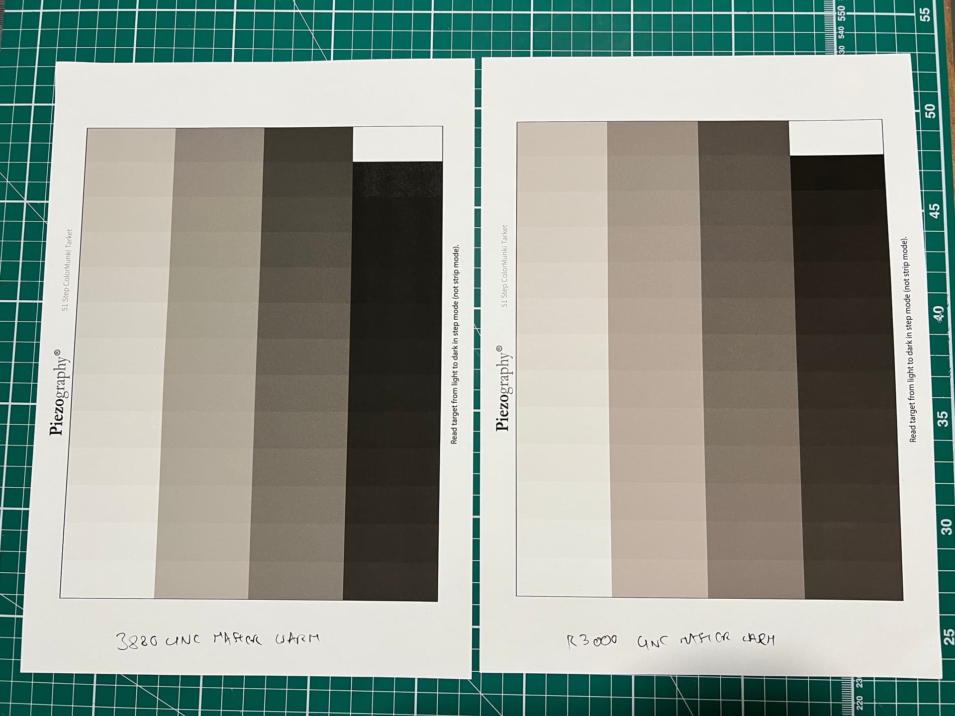

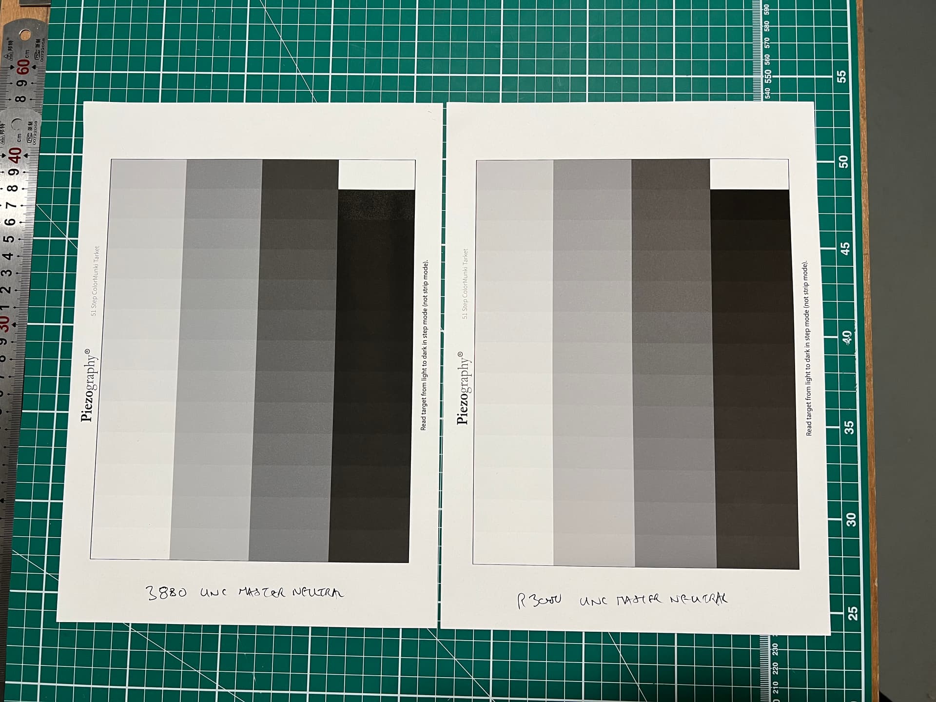

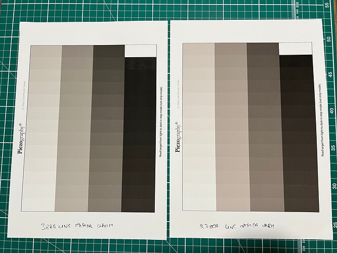

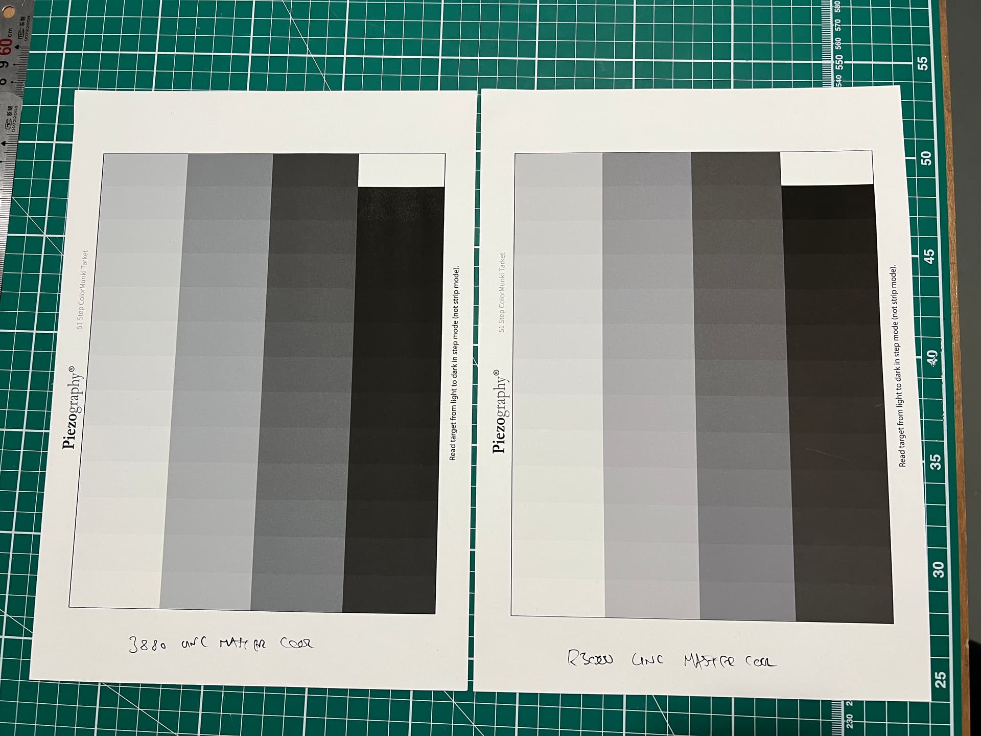

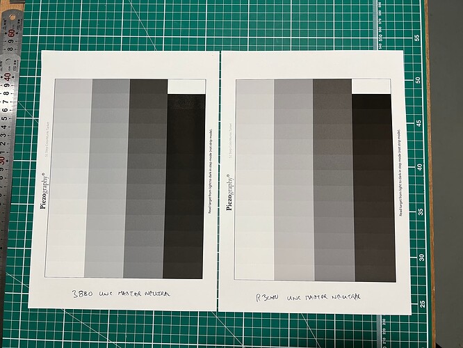

Piezoflush cleanout went well. I did actually have to do two ink charges but all nozzles were printing pure pink after the second charge and no missing dots. So I went ahead and charged the piezo pro inks through the machine. Everything looked clean and neat after the charge and so I printed a 51 step test chart and started measuring it. But then I noticed that it was lighter in the black end than the test chart comes out from my existing 3880 piezo pro machine.
On comparing them side by side I think I can see a faint pink tint to the R3000 chart. Would remnants of piezoflush cause the blacks to be lighter/less dense as well, or could this be something else?
I’m pretty sure I have diagnosed the problem and remedied the solution, ie. piezoflush still in the lines/head → give it a second charge of piezo inks, maybe a head clean or two.
I would very grateful of confirmation if I am right in this, or suggestion of a less costly fix if there is one (I will have to waste ink by running the carts down to trigger auto-refill before doing the second ink charge).
Here are cool, neutral and warm charts from each printer side by side. Lighting is roughly D50, but pics taken on my iphone as I had no camera to hand. All charts were printed from (NON-ink-limited) uncoated master curves. (I have actually produced ink-limited curves optimised to this paper for my 3880, but obviously I don’t yet have those for my R3000+this paper)
3880 on the left, R3000 on the right.
Cool.
Neutral
Warm
Help appreciated.
Chris.
