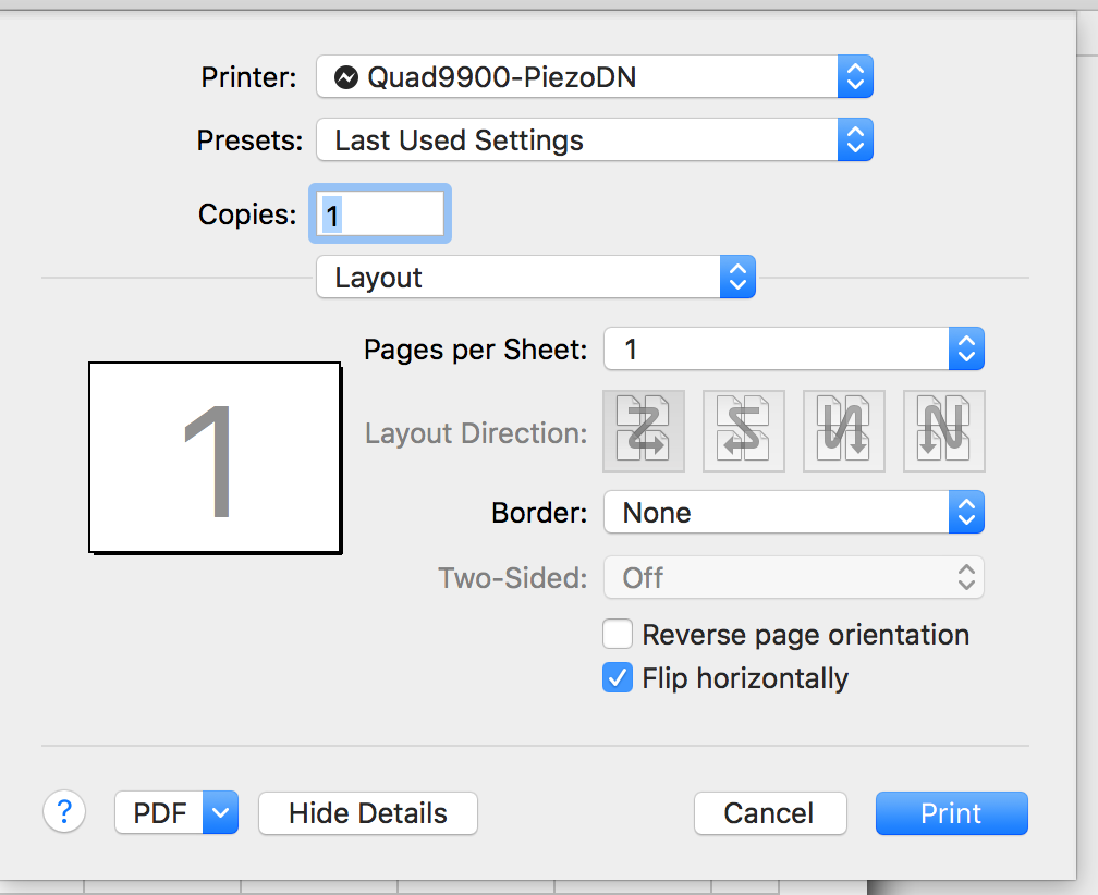

Make sure that the “flip image” button is not checked after hitting print.
[attachment file=25676]
Pretty sure Walker meant to say BEFORE hitting print. But you probably understood that.

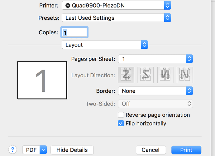

I just want to add that we actually have 2 options as to how to handle the matter of flipping horizontally.
  1. If you want to flip the image in Photoshop, be sure that you do not flip it again in the Print dialog.
  2. Use the Flip horizontally option in the Print Dialog, but do not flip it in Photoshop.
In either case, use one or the other, but not both. I have found it to be so simple to do it in the Print dialog where I have Flip Horizontally turned on and saved as part of my PiezoDN preset. I never have to think about it.
