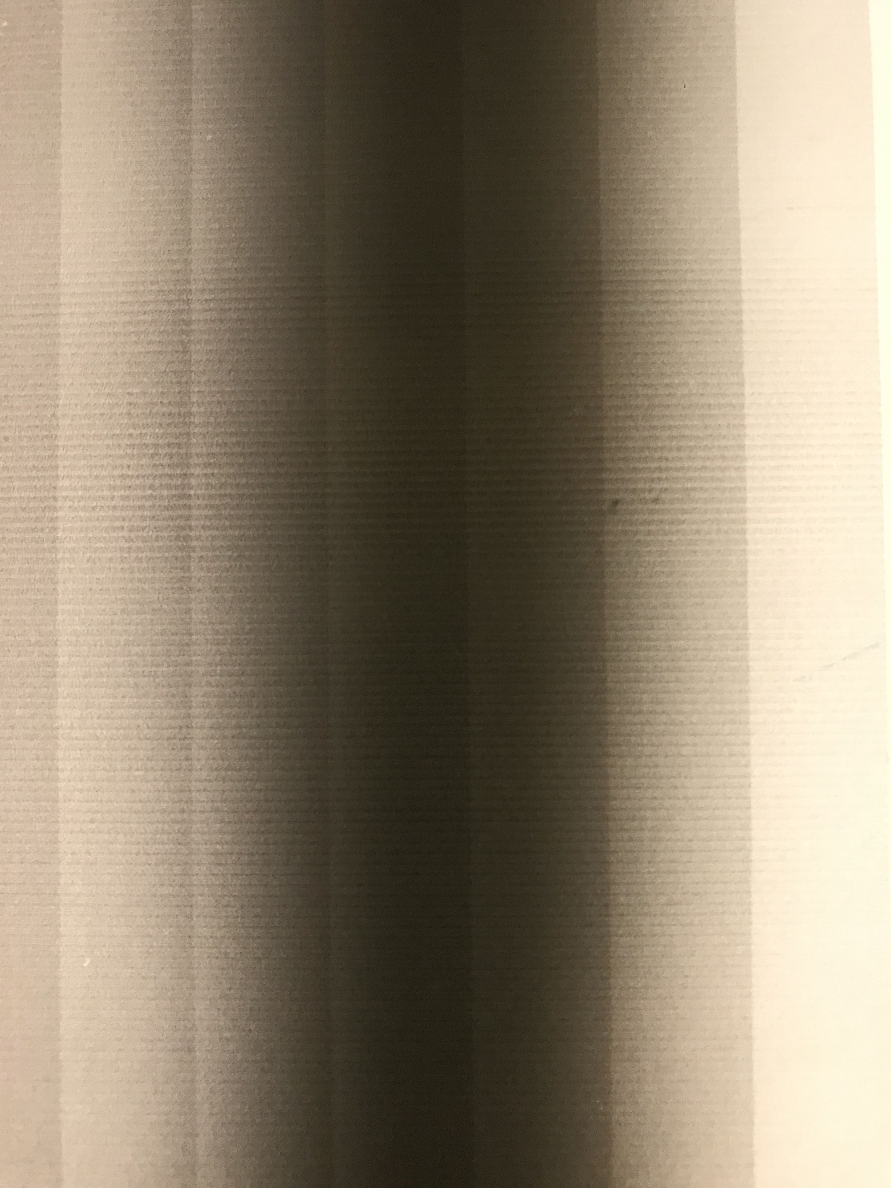

The Piezography saga continues. This week we’ve had better luck getting Pictorico sheets through the printer without random gashes, but on close examination there are still faintly visible lines running perpendicular to the feed path. The platen has been set at “widest” IMG_1912|375x500
If you are feeding from the top (sheet feed) then you shouldn’t have to set this to widest at all. Normal should work just fine.
And you have verified that ALL nozzles are firing before doing the print correct? Every nozzle has to be clean before printing.
Maybe this is as good as it gets?
-Loaded from the top
-Power Clean beforehand
-Platen gap set at “Normal”
-hand hold it as it comes out
Also make sure it’s set to UNiDirection not Bydirectional and 2880dpi.

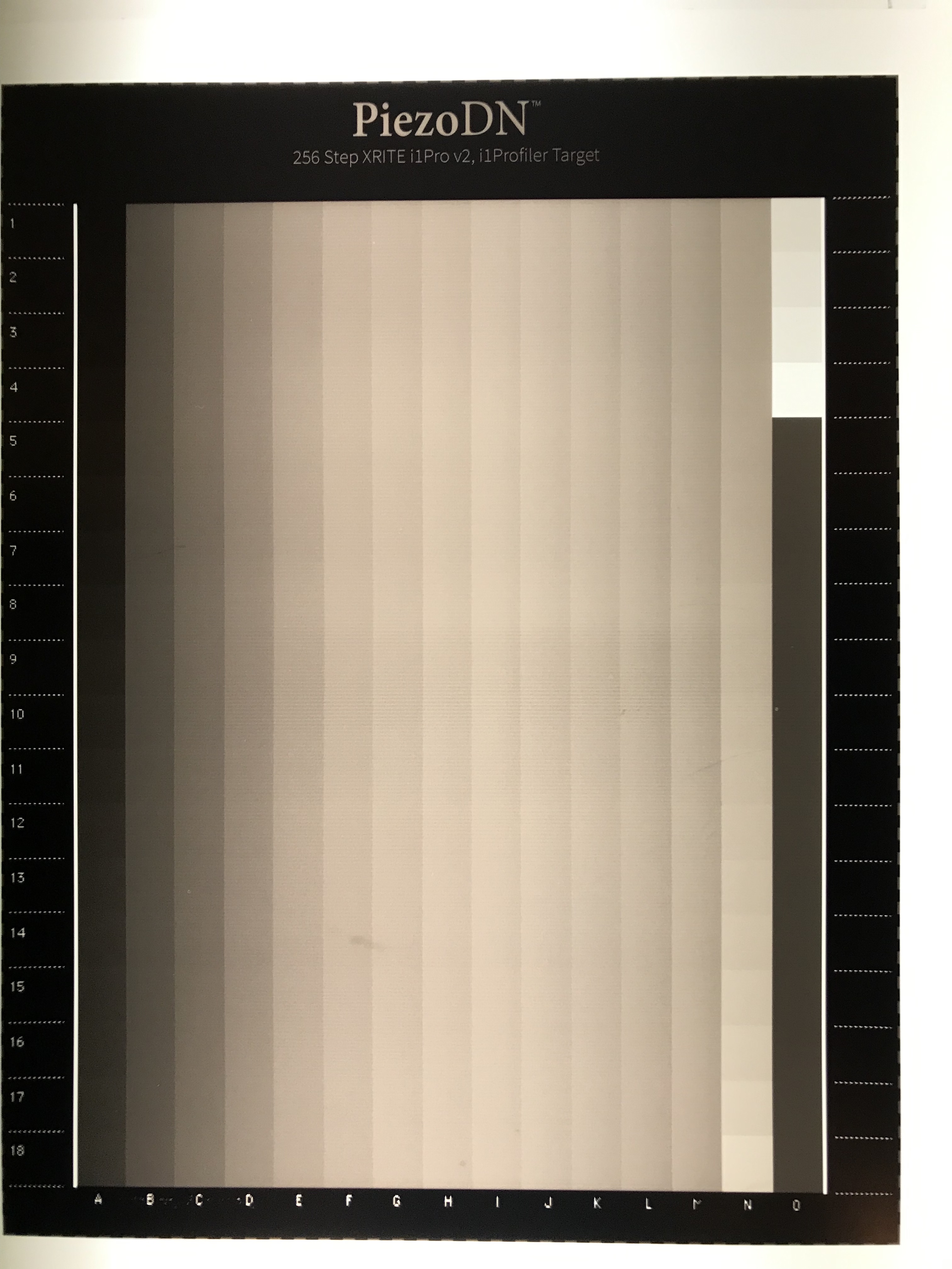

After adhering 2 inch tabs on each end of the 8.5x11 PIctorico film, we’ve gotten some successful negatives.

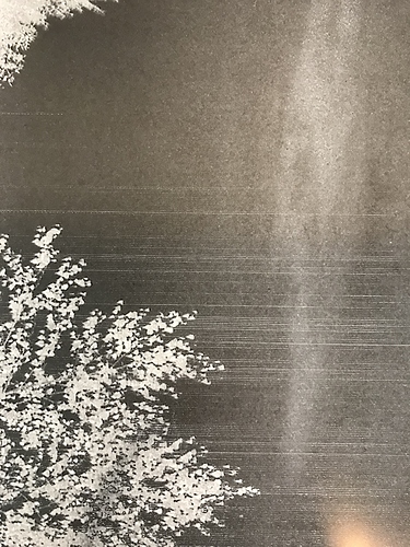

However today we tried sending 16x20 sheets of Pictorico through but have tons of fine scratches left by the head, lines that run perpendicular to the feed direction. Are we asking too much?
Something is catching on the 17x22 film. Check the feed area and run a film though and actually look at it as it’s going through. Adjust as necessarily. Be especially careful of the 4 corners (curl them away from the emulsion before you feed/print).
