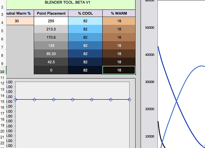

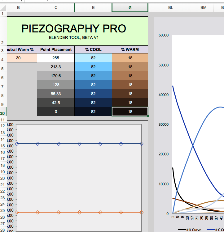

So this is how the settings should look?
i can get everything set up in the Curve Blender but something is going awry when i paste the data into a text document and go through the remaining steps. the curve file I end up with has no data. What text editor do you copy your data into.
No. Set the Neutral Warm percentage (far left) to 18 and the cool/warm goes to 50-50.
