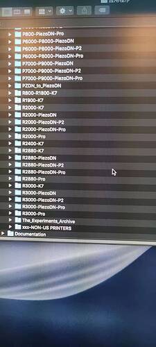

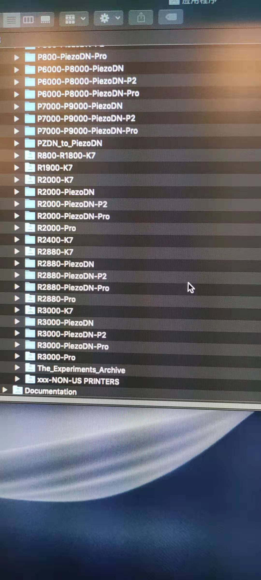

Downloaded and installed Piezo DN in my mac,but i can’t find PDN curve for Epson7910.
can’t use PDN for digital negative processing.
Does the PDN  support epson 7910?what should i do?

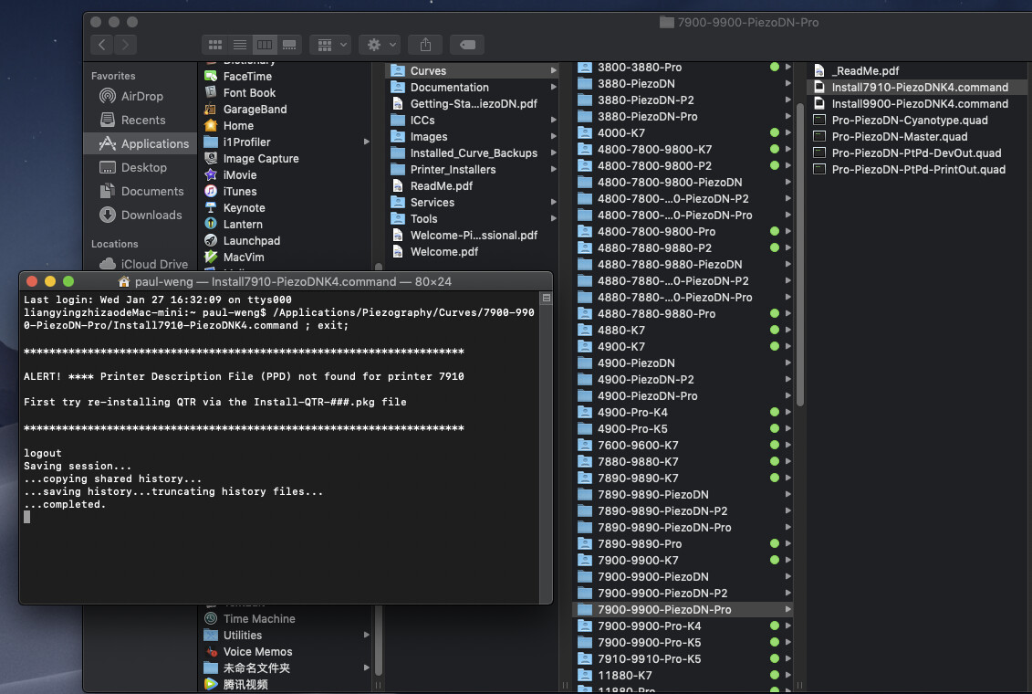

Change the “7900” part of the 7900 install command file name to “7910” and it will find the printer and install.

According to your guidance, the 7910 problem cannot be solved.

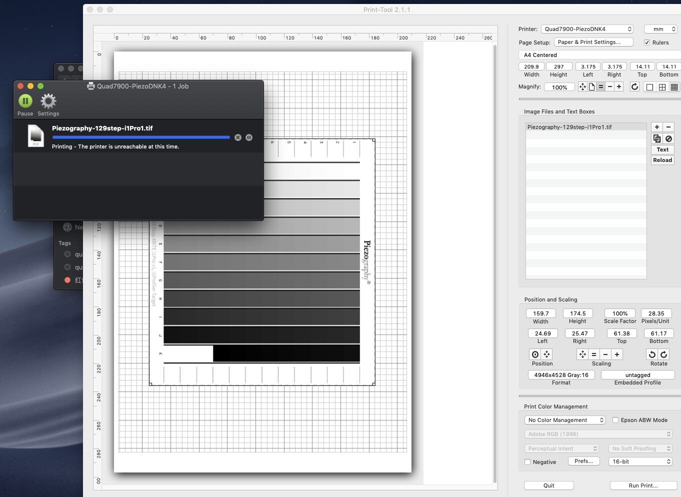

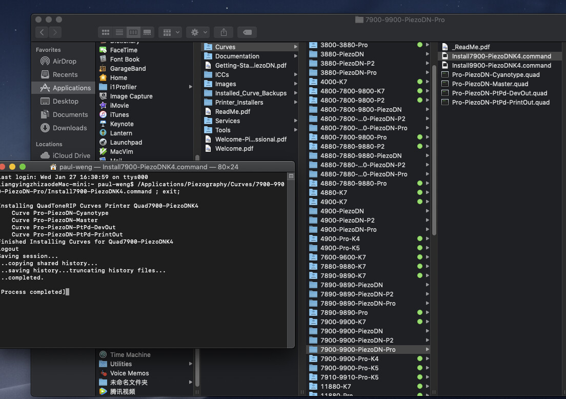

As the picture shows, if I install the original 7900 command, it shows that the installation is successful, but it cannot be printed.
As the shows,if i follow your guidance and change the 7900 to 7910,it’s will be erro.

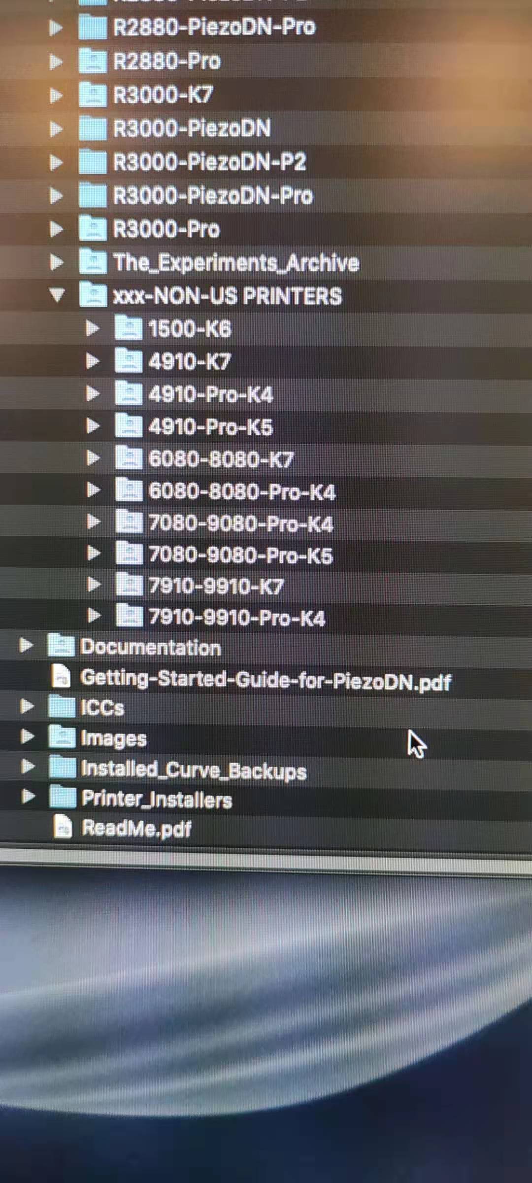

I use 7910 ProK5 to print,so should PiezoDN also be 7910 PiezoDN Pro-k5?
Can you send me a PiezoDN Pro-k5 command file by email to solve this driver problem?
many thanks!
So sorry, the correct file name should be
Install7910-ProK5=7900.command
“Install7910-ProK5=7900.command”?
i want to install the PiezoDN for 7910 printer.
i think it shoud be "Install7910-PiezoDN-ProK5=7900.command,right?
many thanks,
xiaoweiw
You can change the “ProK5” to whatever you want. So change it to “PiezDN” or literally anything else.
