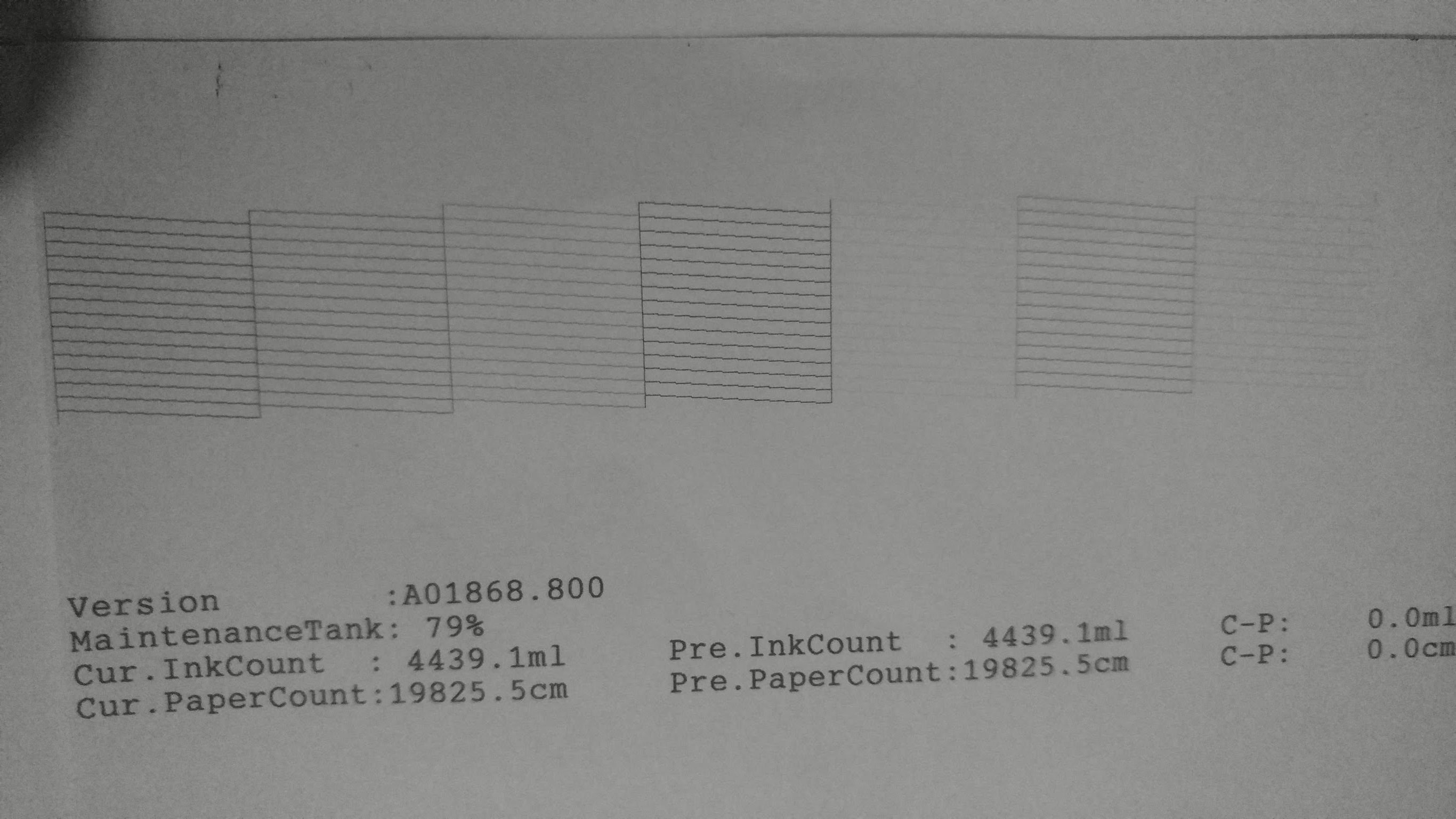

Nozzle check looks all ok, but shade 6 is very light, I don’t have a previous check to compare it with, can anyone let me know if shade 6 looks as it should?
Sorry for the late reply. Your shade 7 looks fine. Can you share screenshots of the Excel settings?

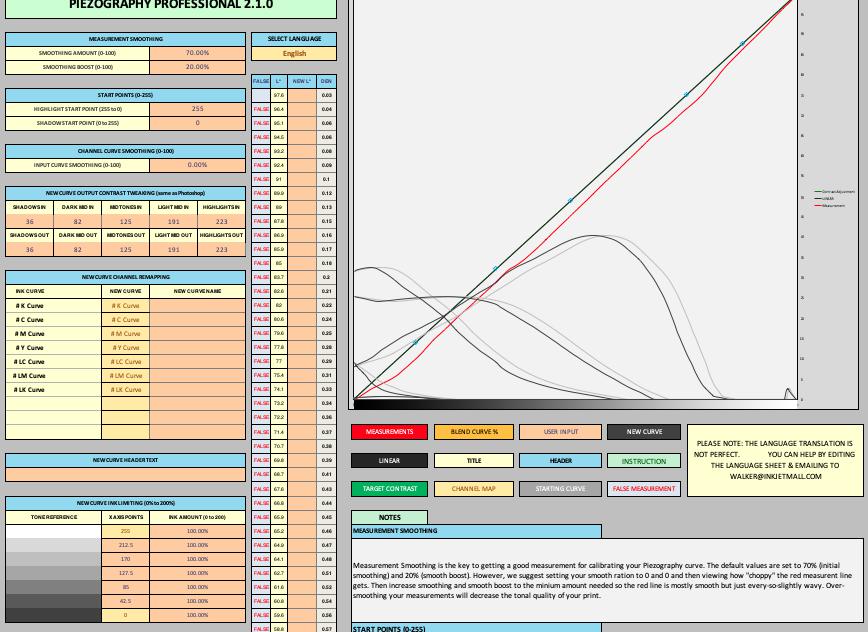

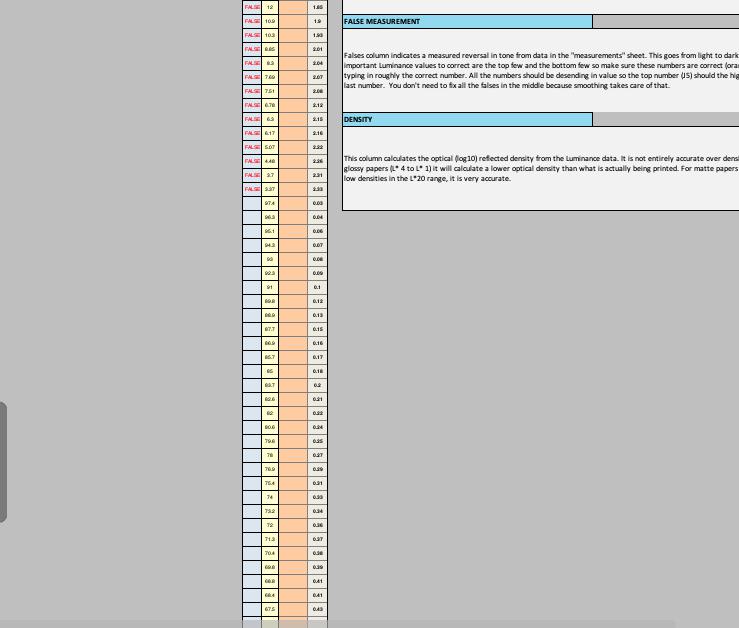

screen shots attached, only top and bottom as can’t get middle in the screen.

So, I think there is a few things going on. 1. You may have not properly copy/pasted into the measurements area. It’s important to delete all the data in there and paste starting at a1.
Also, you may need to download and use the most recent PPE if you are using the 21x16 step target.

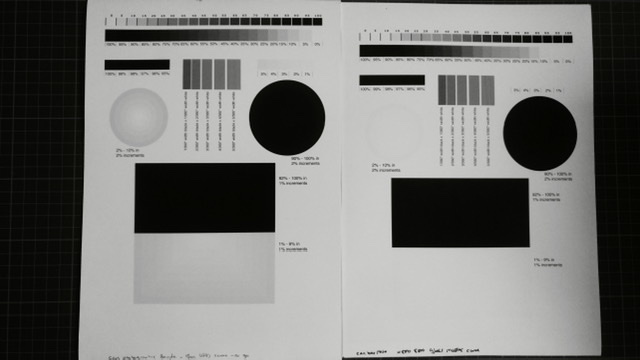

I also tried a proof of piezography print on can baryta photographic using default uhd curve for this paper and one using the gloss master uhd curve.
The gloss master showed a lot less detail in the highlights and shadows!

I sent a reply. It was a copy/paste issue.
