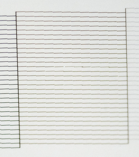

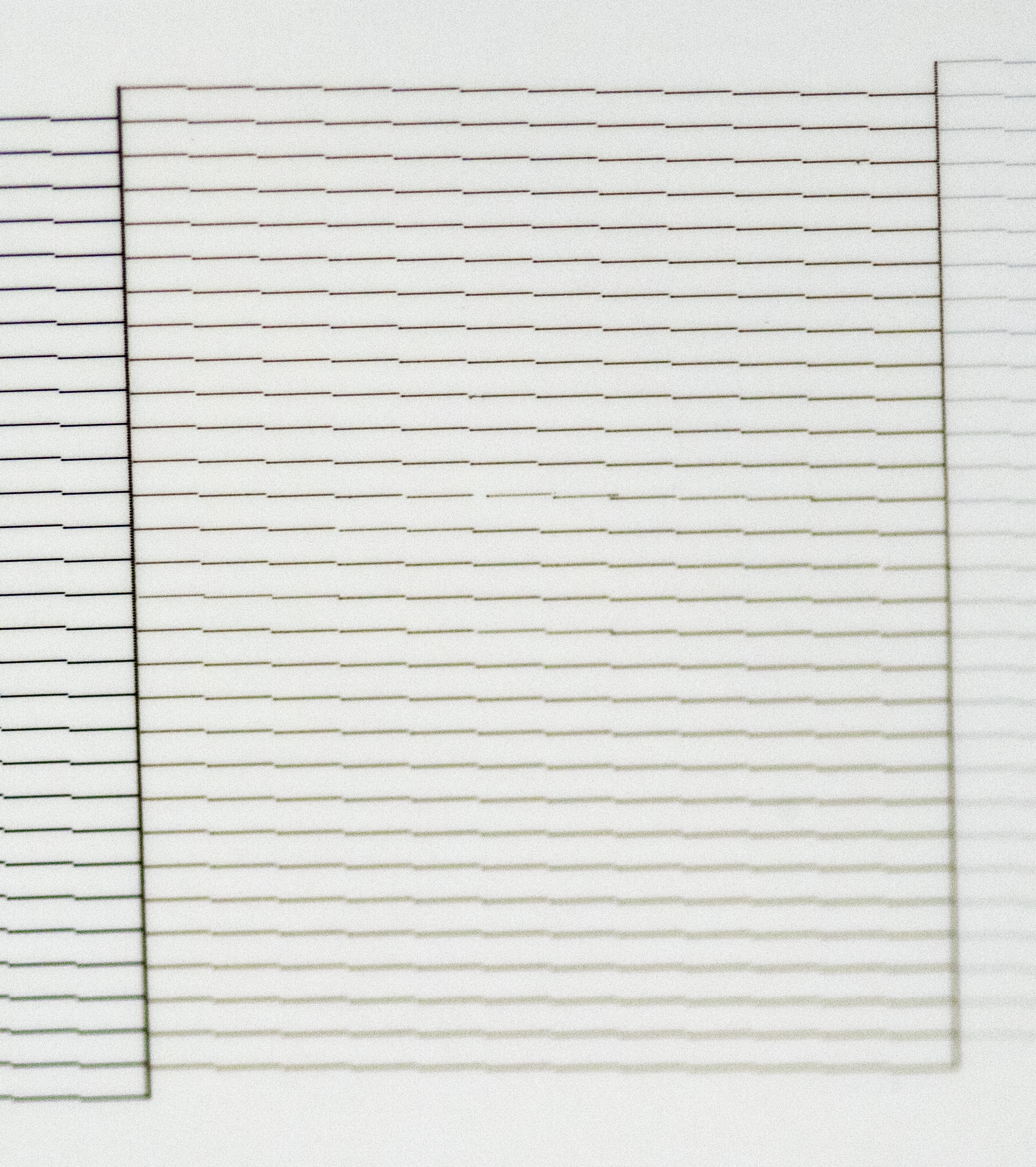

Nozzles all firing, some severely deflected
I’m sure you seen this before. What to do ?
Tom!
This is a deflecting nozzle. Clean the bottom of head. I’m a little worried because it’s in the middle (and if I remember correctly this printer has already gone down one channel?)
You have a great memory Walker, but that down channel is a different 9900.
Interestingly, I ‘lost’ the channel on that other 9900 after cleaning the bottom of the head, albeit a bit more aggressively than Dana does in the video. Then again, after reading some other posts on other ijm forums, that channel may have burned out (started in center and just lost line after line of nozzles.)
I plan on going a bit easier this time.
Thanks Walker. If this should not solve the issue (confidence is low ?), I can remap the curve data to the GO channel I do not use. I’m guessing then I should linearize again ?
Just do a very gentle cleaning with one of our swabs or a CMOS sensor wipe stick. If this does not fix a remap should work. Probably don’t need to relinearize.
Thanks for all your help. Dana uses Bounty to ‘shoe shine’ the bottom of the head. How do you do it with your swabs ?
I do it by taking the right cover off and getting directly to the bottom of the head.
Aren’t the nozzles covered by the capping station ?
the bottom of this printhead looks pristine
I put it all back together again after not cleaning (didn’t see any ink on the bottom of the head.) I did do the bounty shoe shine very gently without clearing the deflection but also without creating any new problems. I will remap.
