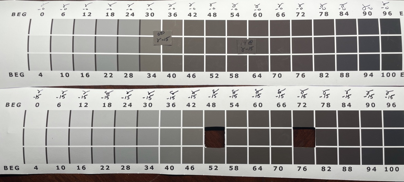

Finally I printed a 51 step on Quadtone and then a second at -15 gamma. It looked like 50L was being mapped from 28L. I applied a single curve adjustment mapping 50L back to 28L and although the screen print was very light, the print, now quad tone at 8/16 auto bits from a flat TIFF and no gamma correction produced a reasonably fine final print.

Those numbers may have been reversed, 50 was printing as 28, my adjustment curve mapped 28 back to 50.

same target printed with QTR gamma at 0 and below printed with gamma -15. Cut out swatches at L50 and L74 placed on the print set at gamma 0. Showa approx 28l differential.
please upload the measurements if you have them. I’d like to graph against linear.

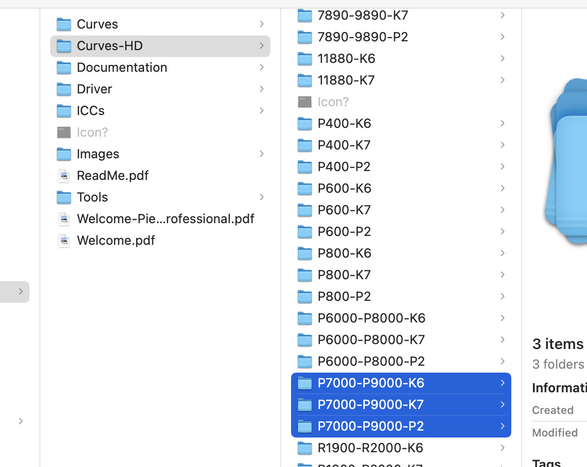

OK, now I found them, the HD set p9000, k7-CAR-UHD-CanEdEtch. What a Bozo I Yam!

Stil a Bozo, the printer driver shows a QTR error, wrong number of inks =9 in profile. slap my mamma. Ill just sit tight until the rescue crew arrives.
I went ahead and looked up our delivery history to you. You have Piezography PRO ink set.

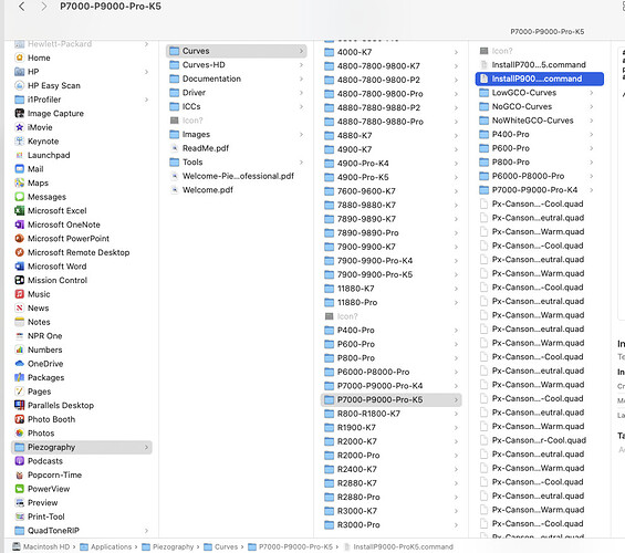

So on the Mac you need to install from this folder:
Do not use a K7 curves! You don’t have a K7 inkset.
The PRO curves (however) all use “HD” inks, but the Curves-HD folder was created after the Pro inks were launched as we updated all our legacy inks with HD and published those curves recently.
