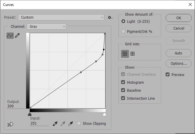

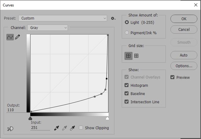

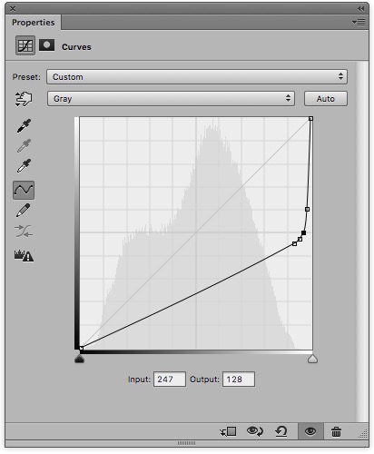

In your example Ps curves above, the 2nd produces lower contrast than the first and is suitable as a starting point for a process with higher contrast (lower ES). I do think though that it’s probably too low for your current situation. I think something like this will get you in the ballpark if you want to stick with 1 drop of 5% Na2:
I still recommend reducing the Na2 down to 1 drop of 2.5% or 1.25%, in which case a limit like your first example above will probably be closer. Either way, you need to make a decision on this before before proceeding with the limiting step.
