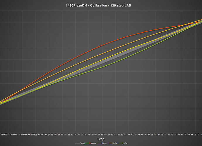

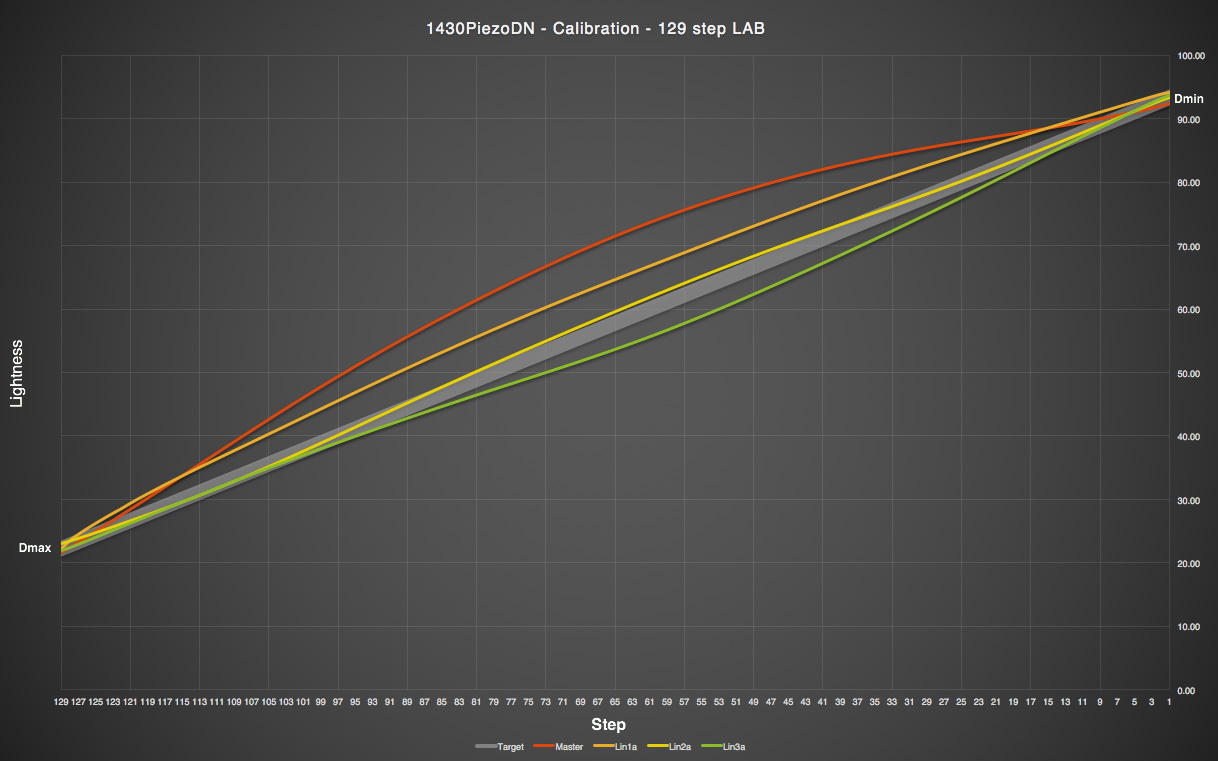

Here’s an example where I made 3 iterative linearizations:
[attachment file=29939]
In the end, I have chosen to use the first linearization because I like the way it looks in actual prints. The others look too dark, especially in the highlights. I suspect that there was a fluctuation in exposure light output that resulted in a target print that appears to be too light, but that if I reprinted it a few times and averaged the results I would find it was an outlier.

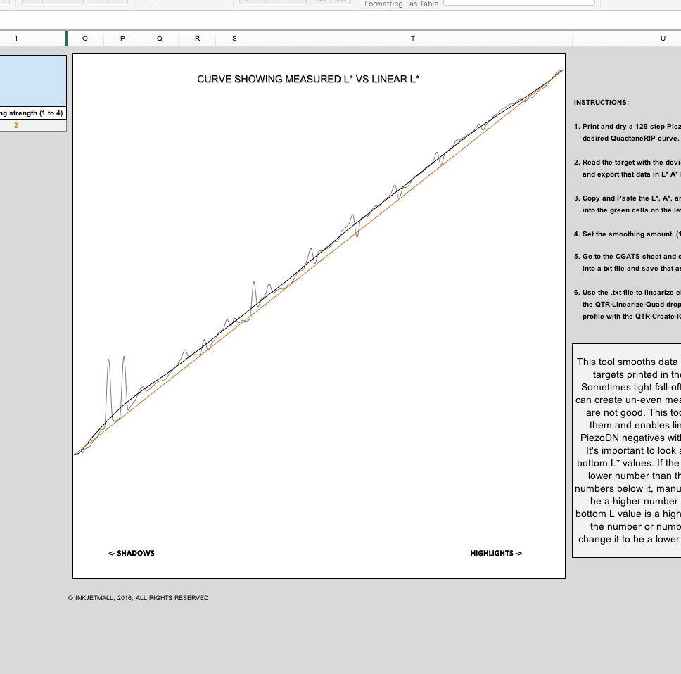

Here’s my Linearization of Pd80Pt20 on Arches. I think it’s pretty close and I am happy with the test print results. It’s funny even before I read the print with the spyder I could visually tell the print was much more linear. Just the way the test image blocks are arranged. The other factor that I have observed that has been really helpful is pressing down pretty firmly on the SpyerPrint head and to have a few sheets of paper beneath the test to not allow any stray light to throw-off the measurements.
