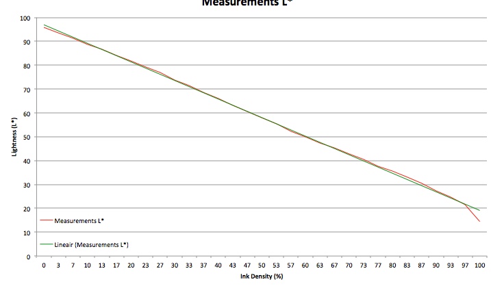

In PPE 2.2.1 the following diagram:
→ In the black area ‘strange’ values?
More in detail as per following diagram (L* mesaurements):

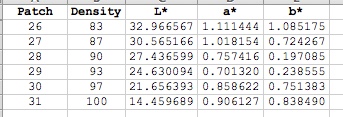

Above diagram coresponding with the average values in the blacks of the mentioned patches in following table:
Any thoughts about the ‘suddenly’ lowering in measuered values in the darkest patch?

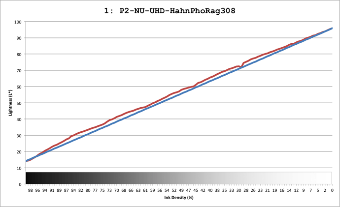

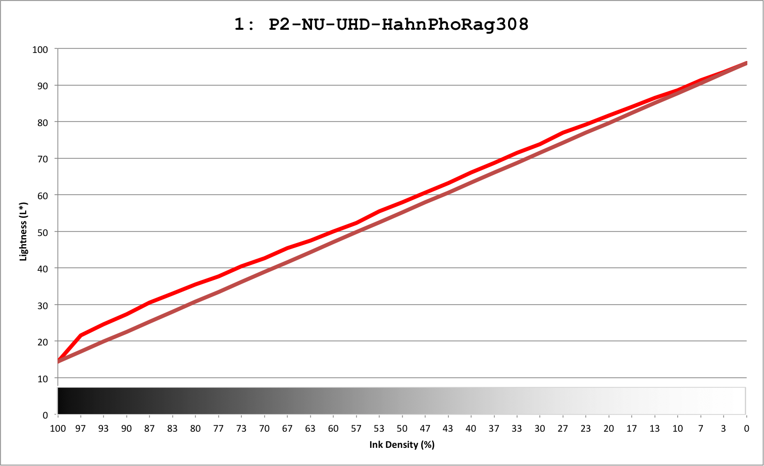

Results of the 31 Patches with additional Trend Line:

ColorMunki - Piezography-129step-Colormunki.tif
Spectro : ColorMunki with ColorPicker
Results of the 129 Patches with additional Trend Line:
→ Could you explain how to understand the differences between the two results?
