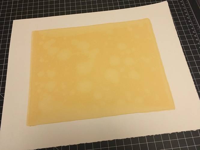

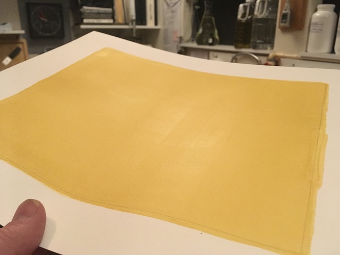

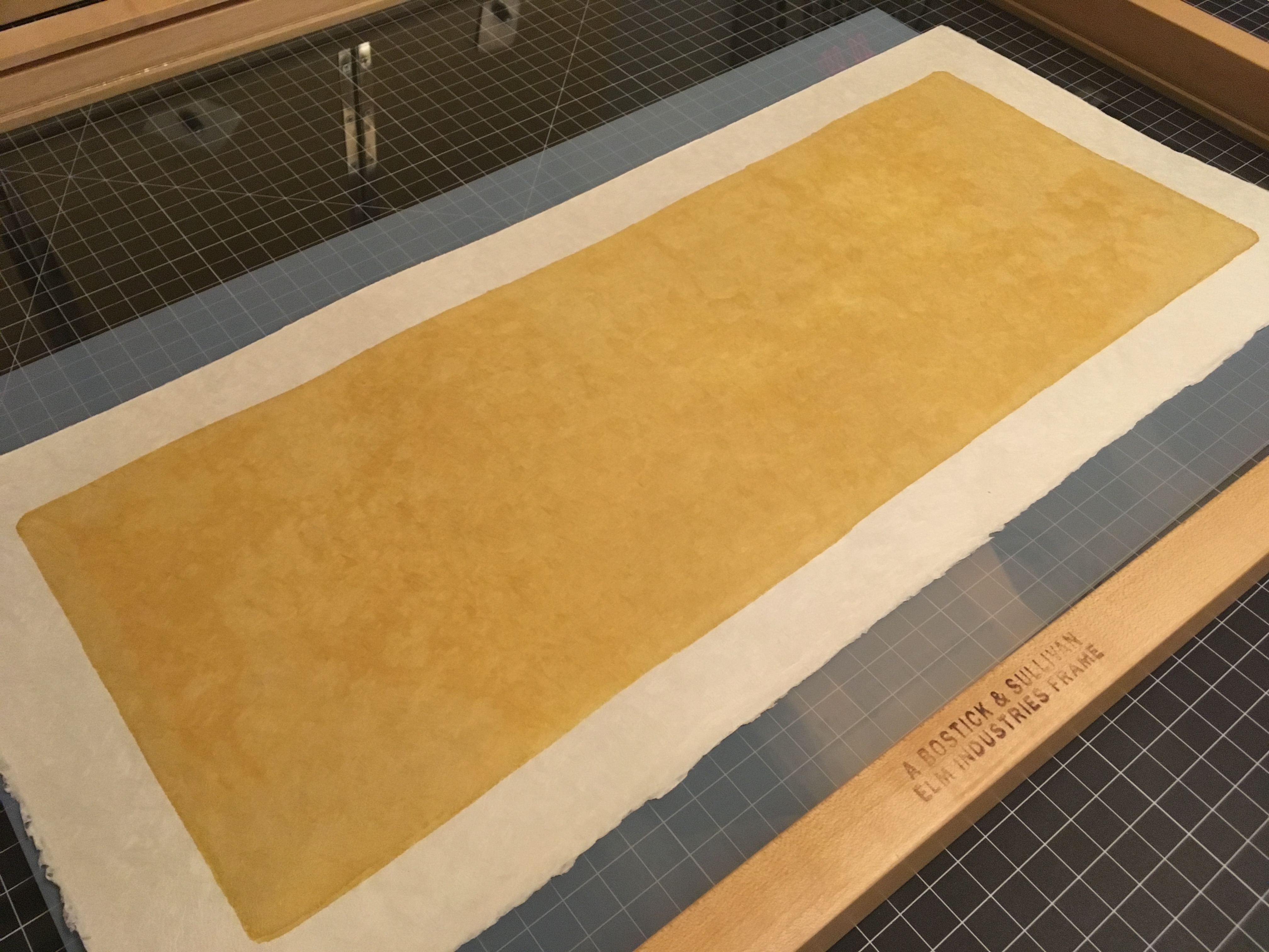

What I called “crystalization” above might better be described as a sort of irregular surface sheen or gloss that does not disappear upon drying.
Perhaps you can see what I mean on these pics from a while back when I first encountered the problem. The first 2 are on either Revere or Platine, so I was mistaken when I said above that I hadn’t had this issue on those papers. I guess I had forgotten since I haven’t been using them. The third is on my Gampi Torinoko. I can eliminate the problem by drying with hot air immediately after coating rather than letting it rest for a few minutes first as has been my usual practice.
Unfortunately, my hopes that these irregularities would vanish after exposure and processing did not pan out. It persists as a sort of differential glossiness. (Sorry no pictures of that.)
I’ve been using Legion Revere and it looks exactly as Keith’s photos.
