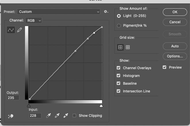

I have come to the point of wanting to keep my PiezoDN negs I print for future printing in my Alt-Process printing method. I have successfully made beautiful negs and prints (lots of work and worth it).
I read in order to keep PiezoDN negs longer than the immediate darkroom printing session you “need to lighten the neg/image by 5%” because of dry-down that occurs in 48 hrs after printing. Yes I did just use a PiezoDN neg that I printed 2 weeks ago and yep it is now off looking (lighter).
My question is:
What is the best procedure to ‘Lighten your image 5% in PS before printing with PiezoDN/Print Tools’, in order to keep said dig-negs for an extended time period say for a month or longer?
This seems a easy task, after getting to this point …… I would like to do it the correct way.
Many Thanks,
Jimmy
Something like this,
all the best,
Walker, Thank you!!!
Jimmy
