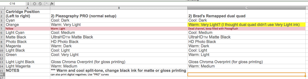

My 9900 has the Y channel remapped to the GY. The yellow channel has piezoflush in it. My green channel has Warm Light in it. The warm curves are K4 and the cool curves are K5.

I forgot that when our original 9900 died a few years ago we got a new 9900 that had a different re-mapping setup to make it into a dual black ink printer (putting PK on the Orange slot so no need to swap between MK and PK). So I was trying to linearize a curve for the old printer with the Y > GR remap.
