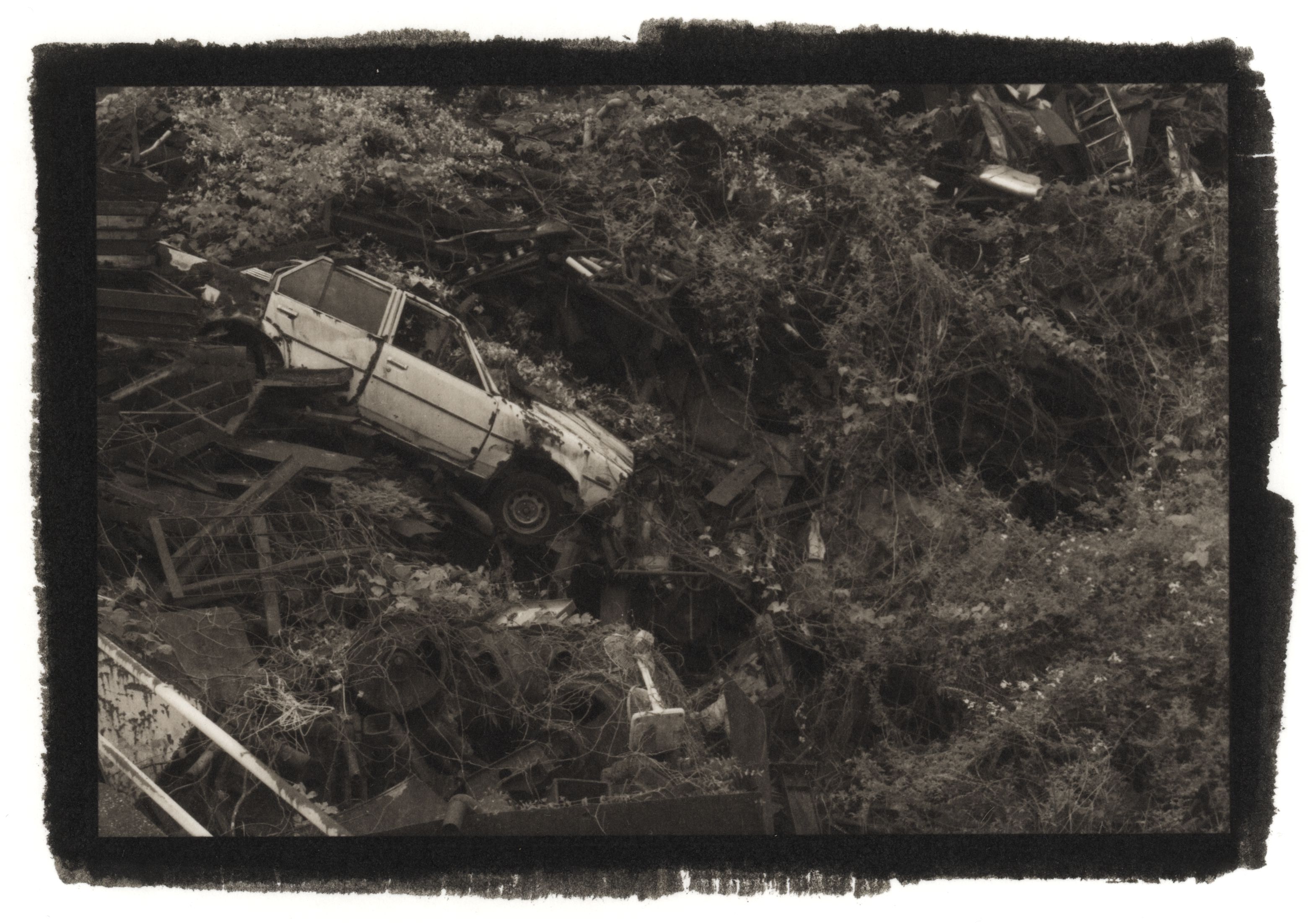

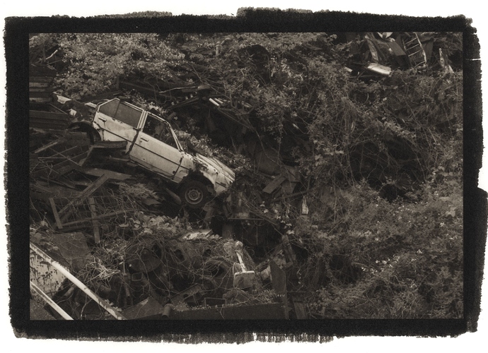

Attached is a small print (3x4.5) that hopefully allows you to see the warmer tonality. I just added another print, really small: 2x3 that may provide another tonality view. (the prints are a lot sharper than the scan!)
