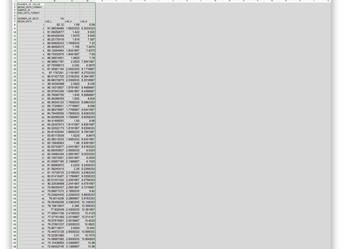

Is this a Piezo DN question or PiezoPro? For PiezoDN you should be using a 129-step target, and the CGATS is one the second tab in the Excel Smoother tool. For PiezoPro, I don’t know, but I bet you’d have better luck in the PiezoPro forum. :wink:
[attachment file=27851]
