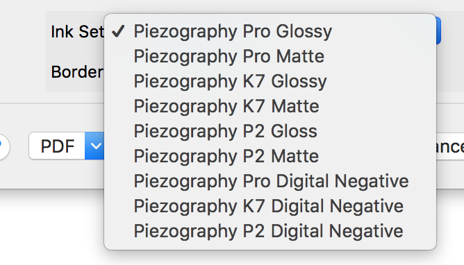

You will be able to simply choose your media types and inkset in the driver. (see attached)
This driver is a very initial beta phase. We are still testing it. It will drop for the PiezoDN group as beta before it goes anywhere else because of the requirements of incredibly precise dot placement and resolution for dig-negs.
