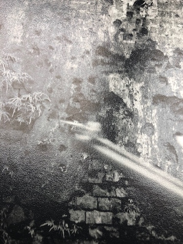

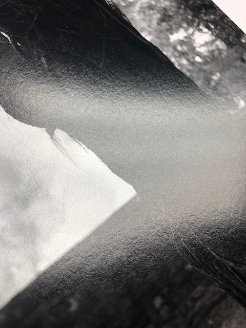

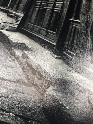

Please share a photo of the “matte” areas.
GCO is not exactly built to gloss matte. Also if you are using MK (matte black) ink this will not work.
best regards,
The paper is glossy and I’m using HDPK ink. I have tried several different paper curves but they are all giving the same result.
I’m starting to think the problem is something else.
I set the printer up last winter and I have been busy doing other stuff since then.
When I look back at the test prints I made back then, the gloss is perfect (on the same paper) , very even in all tones.
Can the gloss solution get old ? Have tried different paper batches and I can also see the problem on Hahnemuhle Fine Art Baryta.
A nossle check looks ok.
I hope you can see what I mean on the photos.
Best Regards
Johan
Here is a print from seven months ago. Same paper.
You can see there is no change in gloss in light or dark areas.
