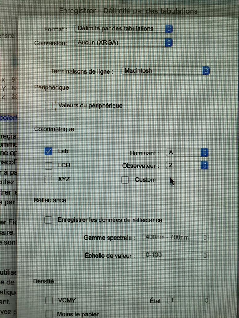

When exporting the measurements, I choose “Tab delimitated”, No conversion (XRGA) and then I only select Lab values. Is this correct?

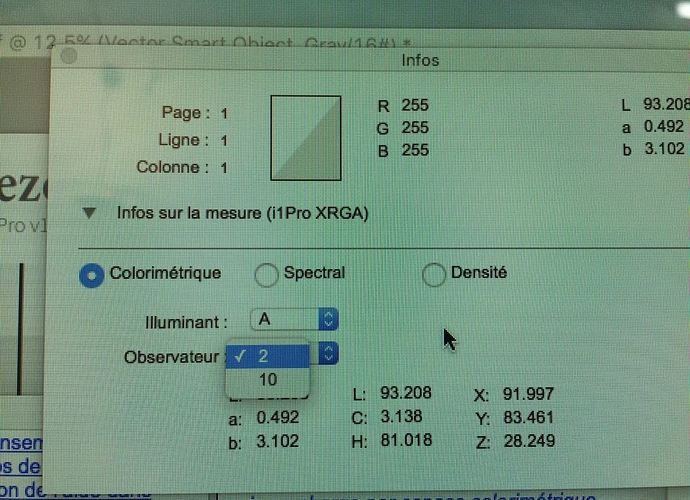

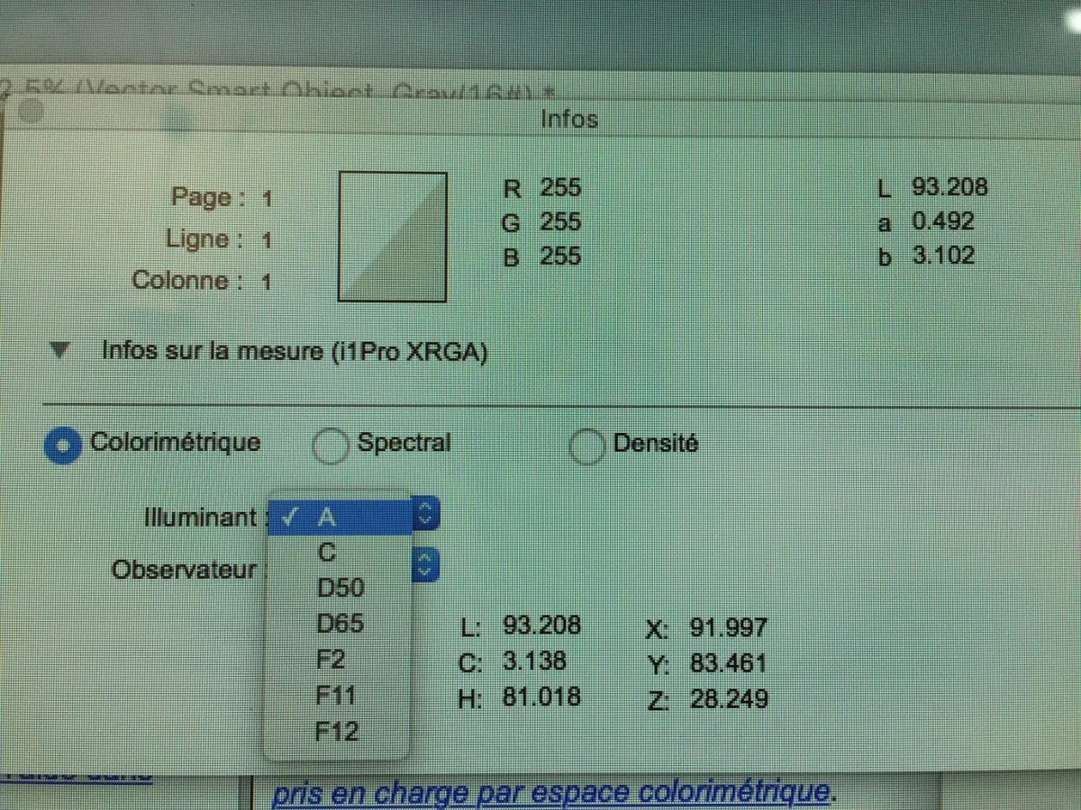

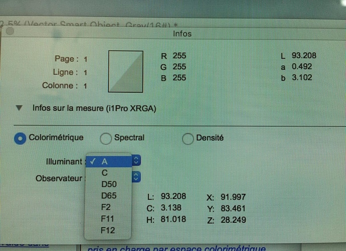

The main question comes when I have to choose the Illuminant and the Observer values. I have seen that the Lab* values change slightly when I select different options for the Illuminant and the Observer. Which are the values we should choose? (I attach the different options here… in french, but it is self-explanatory since very similar to English)
