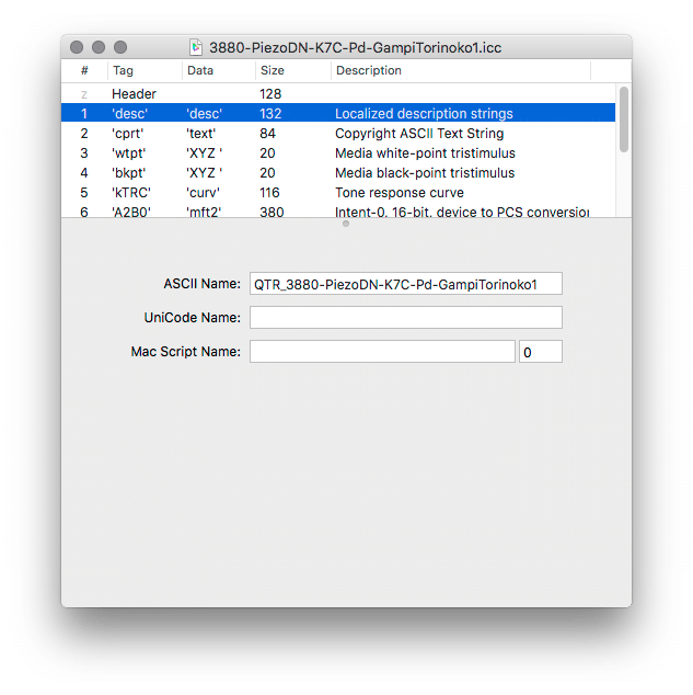

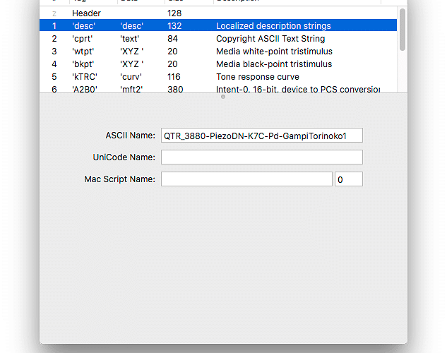

There is a way to change the name of an ICC after it has been created, which Walker kindly shared with me somewhere. (I don’t remember which thread.)
  1. Open the ICC in the ColorSync Utility by double-clicking it.
  2. Highlight line 1 "Localized description strings".
  3. Edit the ASCII Name to whatever you would like.
  4. Save.
