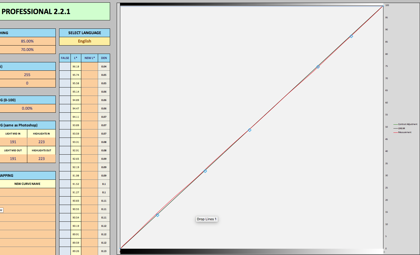

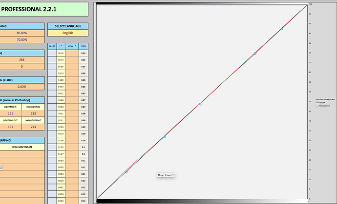

I have successfully linearized the K6 remapped curve. This is the last measurement I got.
I suppose that is linear enough. Should I use the curve that gave that measurement? Or, should I run another iteration of linearization on the basis of these measurements, and then use the resulting New Curve to print? That is what I have decided to do…

PS - Totally agree with Walker - that is linear!
linear. now go print
I know it is! Really happy about it.
