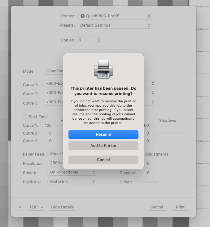

Having had troubles loading paper in the printer (Epson 9900), I was finally all set up to print… only to discover that loads of discarded/cancelled prints had been stored in the printing buffer. I try to get rid of these “buffered jobs” in all the ways I can think of (“job cancel” on the printer, deleting prints in the Mac buffers… i even tried to reset the printer on the Mac). Nothing helps! I still have buffered jobs which keep cropping up each time I try to print a new job and the only option seems to press the “resume” option, any other other option leads back to “resume”!
How can I entirely clean the Print Tool / Quad Tone RIP buffer and start afresh?

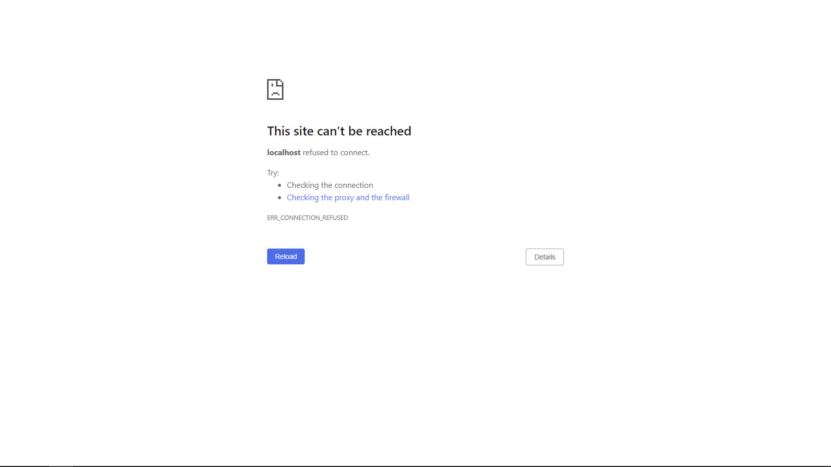

Thank! I tried to reach [http://localhost:631] but the site can’t be reached… same for http://localhost:631/jobs/
Am i doing something wrong?
please share a screenshot.
thank you
Here is the message i get when trying to log in on [http://localhost:631] or on http://localhost:631/jobs/

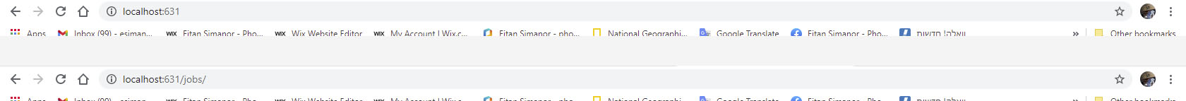

please share a screenshot of the top of the browser url bar so I can see the exact url you are going to
sorry for misunderstanding…
Here it is:
many thanks
So you you a “:” between localhost and 631
The “:” was definitely there…
Is it supposed to work with Google chrome? both on PC and Mac?
this has worked on all Macs since MacOS 10 that I have ever sat down on. Maybe you have a firewall setting that is a problem. I suggest deleting your printer and re-installing it to clear jobs.
