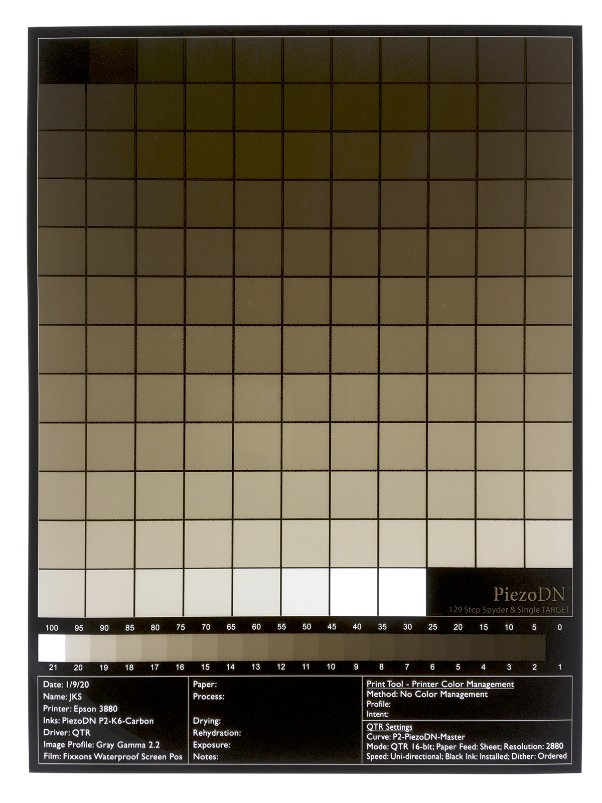

I just printed a 129-step target on my 3880 with the P2-PiezoDN-Master curve.
The bleeding is pretty obvious in the detail.

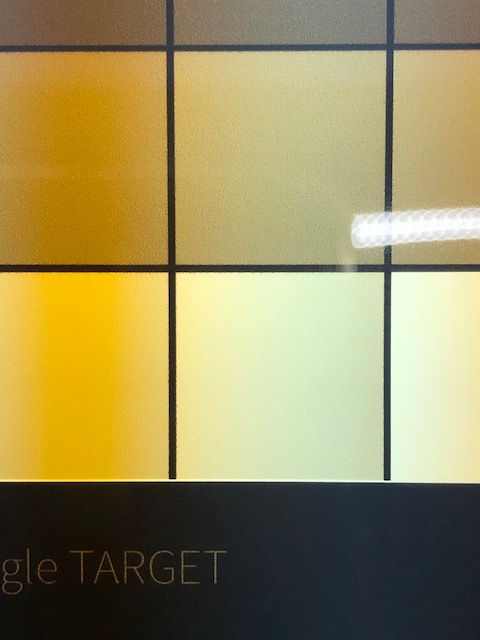

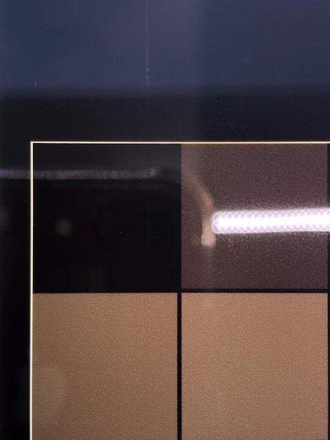

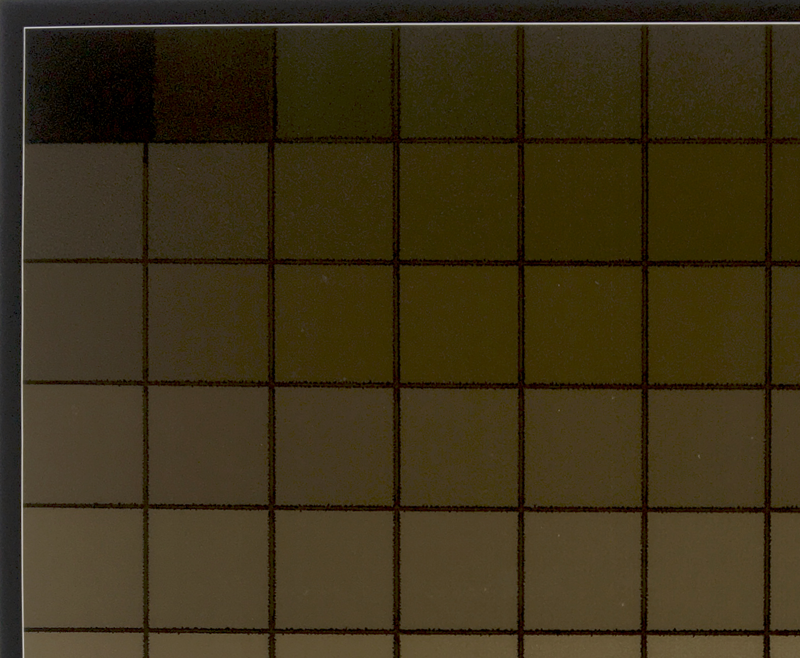

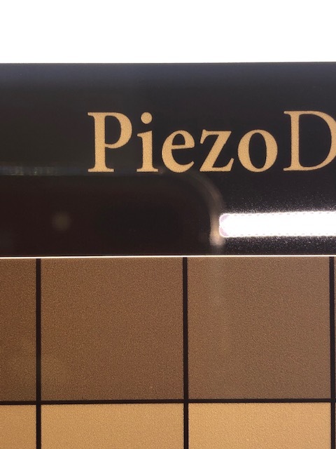

I printed the 31 step chart with my master curve (as I’ve been meaning to make some soft proofing profiles). Here are the results. (Sorry for the less than optimum iPhone snaps. Ignore the yellow color cast in the third photo - that is from the fluorescent tubes in my light table. And the reflections,) I don’t see the bleeding / smearing that are in your photos.
I also took a couple of photos with the film directly up against the camera lens on my iPhone to try to give you a sense of the difference in “opacity”. The Fixxons is clearer, i.e. not as milky as the ultra-premium OHP. My calipers couldn’t measure the thickness but the Fixxons is also slightly thinner then the Pictorico. The Fixxons packaging indicates which is the printed side and visually you can distinguished the matte (to be printed on) vs the shiny (not to be printed on) sides.
Pictorico:
Fixxons:

Hi Michael,
That’s good news. It also suggests that this is a relatively new product, since there was nothing by that name available when I requested my sample. Those neg details look very nice — which printer/ink combo is this?
