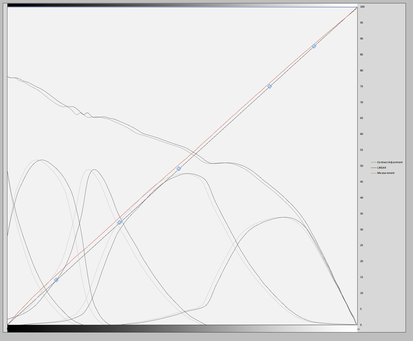

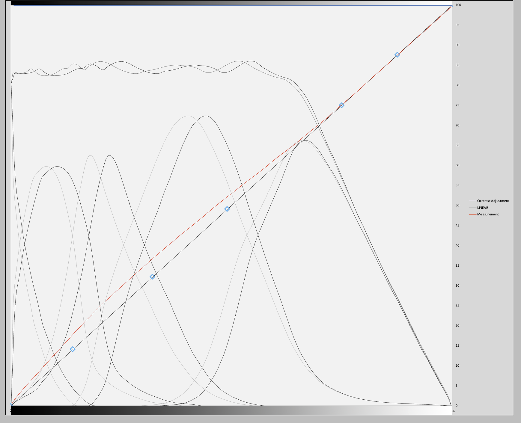

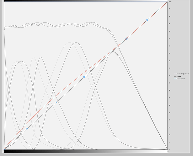

I’ve attached screen shots from PPE for the three curves - cool, neutral, warm. This is the second iteration on this paper with a 256-step target printing with PiezoPro K5 inks.
Is this likely to be improved with additional iterations, and is that typically required for individual curve creation?
That final one is getting darn close! Since this is a new paper, I would try another iteration and see what happens. If there is a considerable improvement, going forward what ever number of iterations got you to that result would be my SOP for a new paper.

Thanks for taking a look. The last curve is from the same set as the others, printed same time. The first was the cool, second was neutral, and the good looking one is warm. Strange they would be that different. Cool is the outlier. Guess I need more. Will give that a go.

They are all second iterations, and the cool curve is furthest out from linear, neutral next, and warm very close. I’m wanting to get all three closer to a match for #3, so since posting these, I’ve repeated more and gotten better results for the others, but they still sit have a wave above the line below mid-gray.
