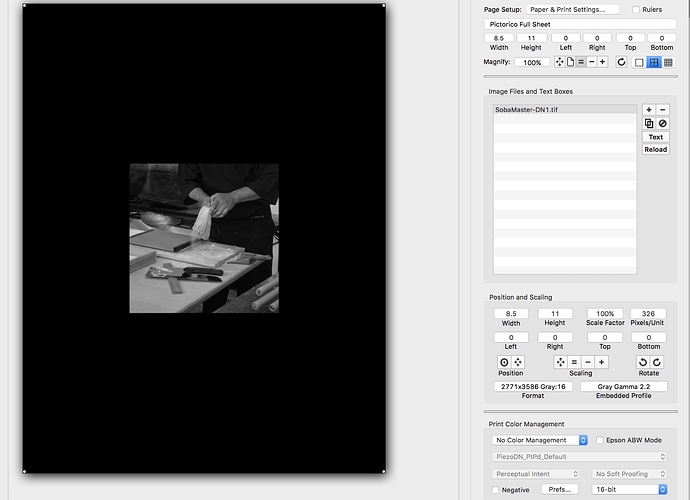

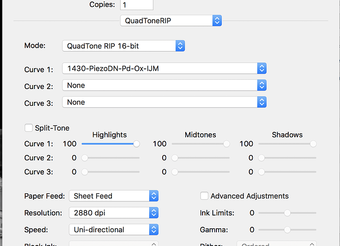

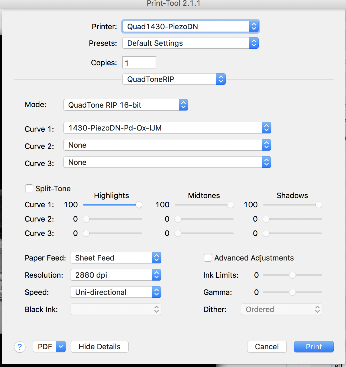

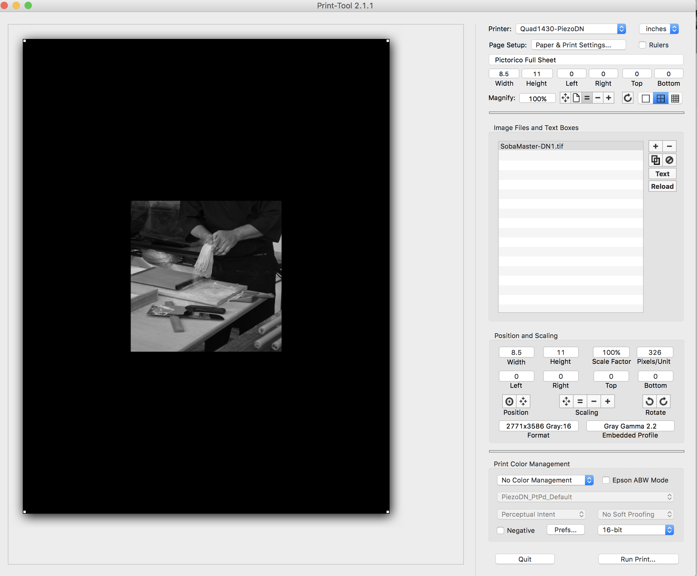

This image was flipped horizontally in PS, but not inverted. Grey Gamma 2.2 was the embedded profile in PS.
Opened in Print Tool with settings as shown in the attached screen shots.
Worked fine the first time. Image was not Inverted the second time. Same Settings as screenshot.

I’m not sure how to help you as all your settings are fine. I suggest re-installing QuadtoneRIP to fix and backend permission issues that might be causing the curve to not print correctly and run another test print.

I don’t see anything wrong in your setup screenshots, though you could save yourself having to select these settings each time you make a neg by saving them as a preset.

OK. We’re making progress! I uninstalled and reinstalled QTR+Print Tool and then set up a PT preset with the appropriate PiezoDN curve, to let PT flip the image horizontally, and the other settings as directed.
My new DN is now Inverted as it should be, and when I’m looking at the ink side of the Pictorico, the image is flipped. So, with ink-side facing and touching the coated paper (away from my light source) the image will be oriented correctly.
