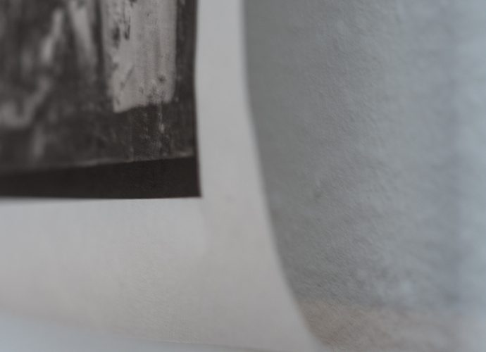

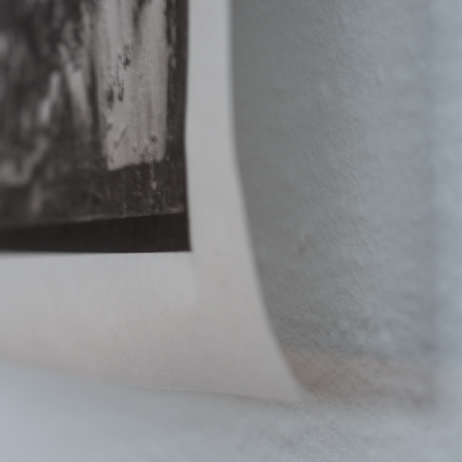

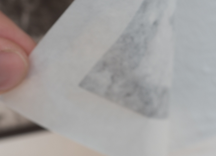

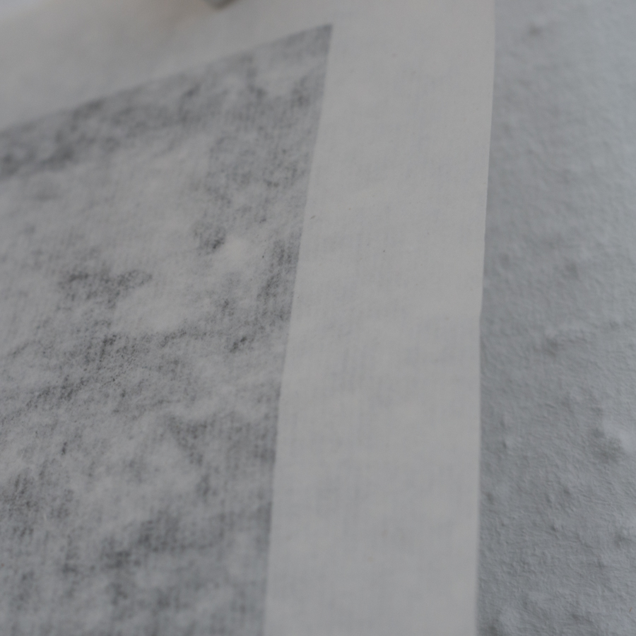

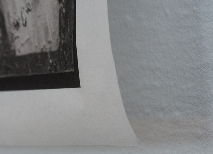

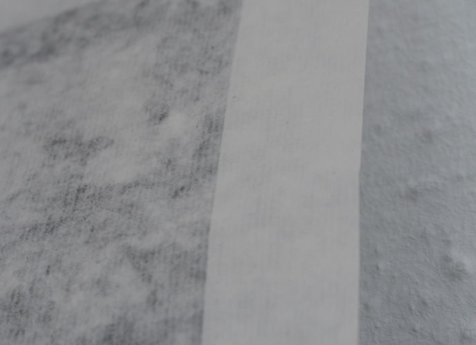

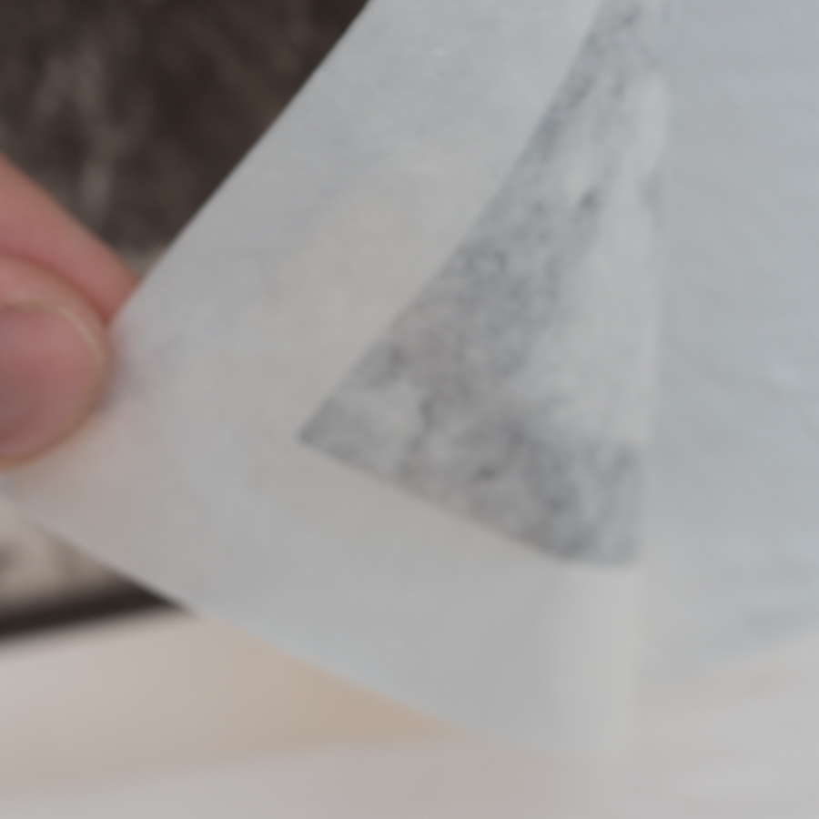

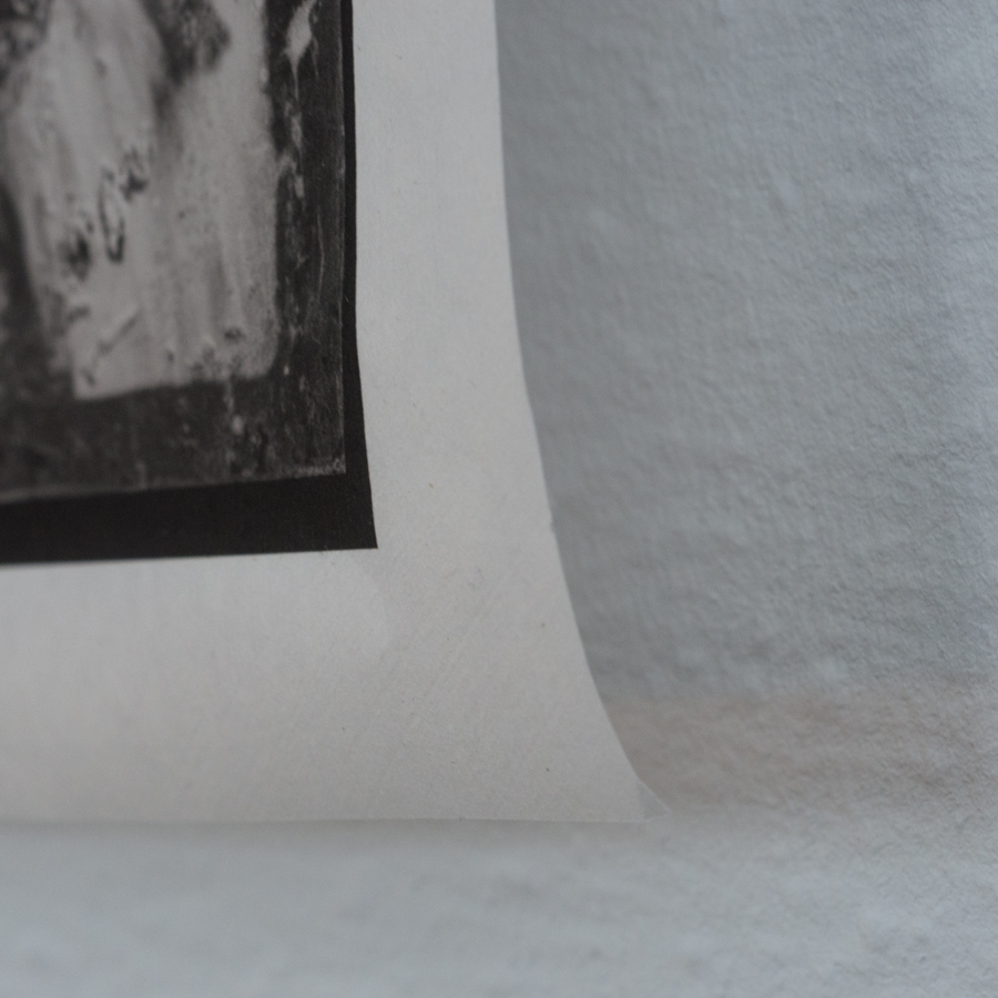

I print on Awagami and even on Xuan paper (very very thin) and it works very well after linearizations of a master curve (PRO K4), the black remains very intense. But if there is a way to limit the ink flow in QTR I’m interested to know too…
Anthony
better samples on xuan..
Anthony
