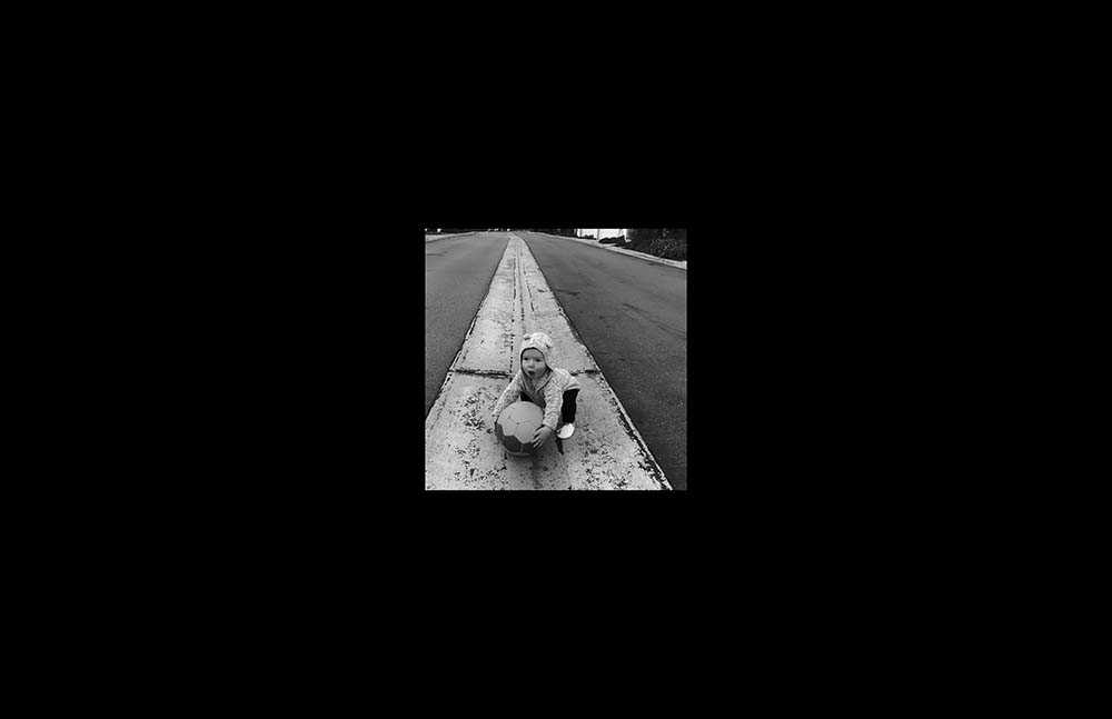

I deleted all the curves from the Print Tool, and reinstalled as Keith suggested. I then printed a DN using the curve that Walker suggested.
The DN was totally black. Something is definitely wrong. Attached is the image as it looked in Print Tool (I made the image small on a 1/2 sheet of Pictorico as this problem is getting kinda expensive) and the scan from the DN print using the 1430 PiezoDN Master Curve.
Here’s the original image, post PS, as it was brought into the PT.Kate01-DN-halfsheet.tif.zip (1.0 MB)
